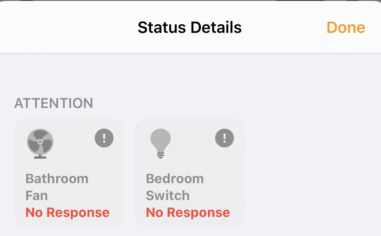

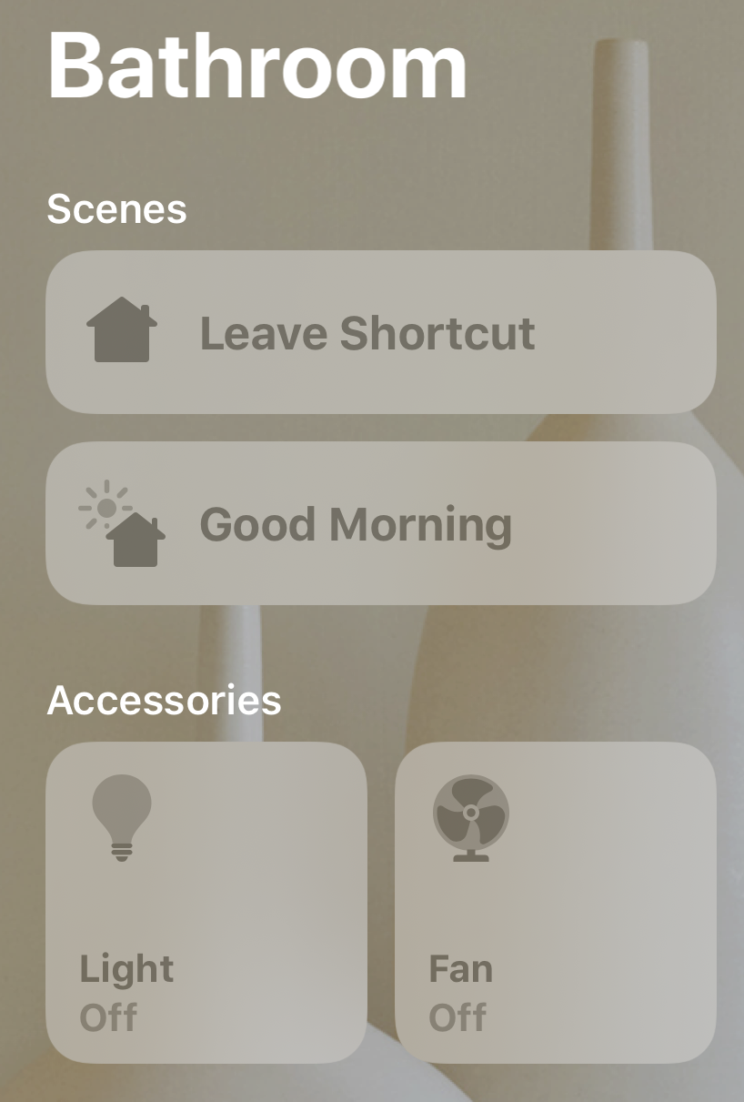

I have two and after the last firmware, either or both are randomly showing as “No Response” in HomeKit and/or not working with the Leviton app. The physical switch still works so not the same issue as yours but an issue nonetheless. Frustrating as they are tied into a few scenes and automations. I been meaning to make a post about this.
I feel since the update 3 weeks ago I've had my Leviton switches and dimmers systematically become unresponsive.
Currently....
Power cycling the switch at the breaker seems to fix them.

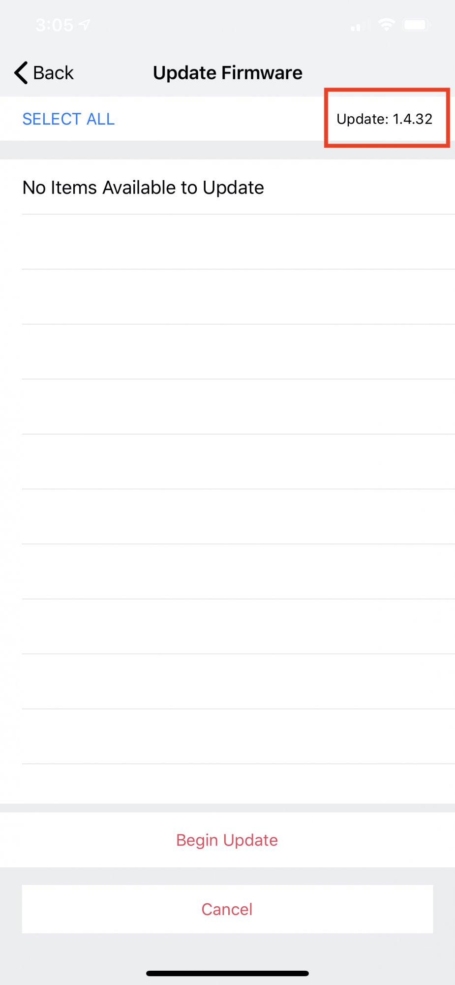

I updated the switches/dimmers firmware to 1.4.32 back in September. Seems like a stable build up until recently.

Because the app is crap (IMO). They bundle firmware updates in with app updates. Its added to the update list and very easy to overlook.
If the firmware sent with the app is > your accessories the list will populate with accessories (items). Since they rarely push updates this method is far easier/cheaper then the app downloading firmware updates on its own. When the next update comes out all they will need to do is replace 1.4.32 in the app and re-upload the app to the app store.

As an update to this, I have 4 switches which I have been unable to update to the 1.4.32 firmware.
I had tried again to update these switches before the issue occurred.
I killed power to all the switches using the breaker, and they have started working again. However I am still unable to update the firmware.
Maybe delete the app from your phone for a day then reload it the next and see what happens. I know a pia but might be worth a shot...
