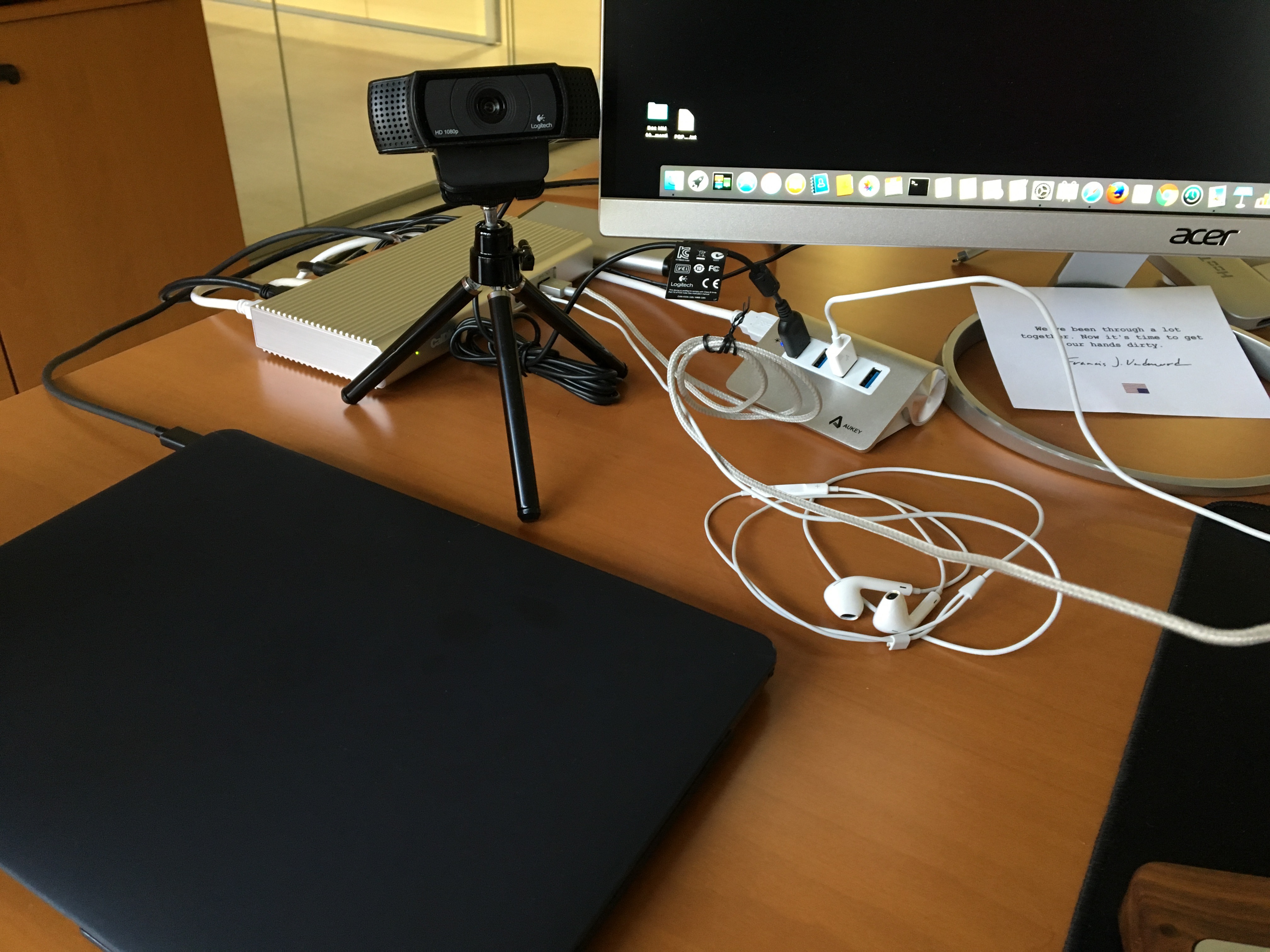

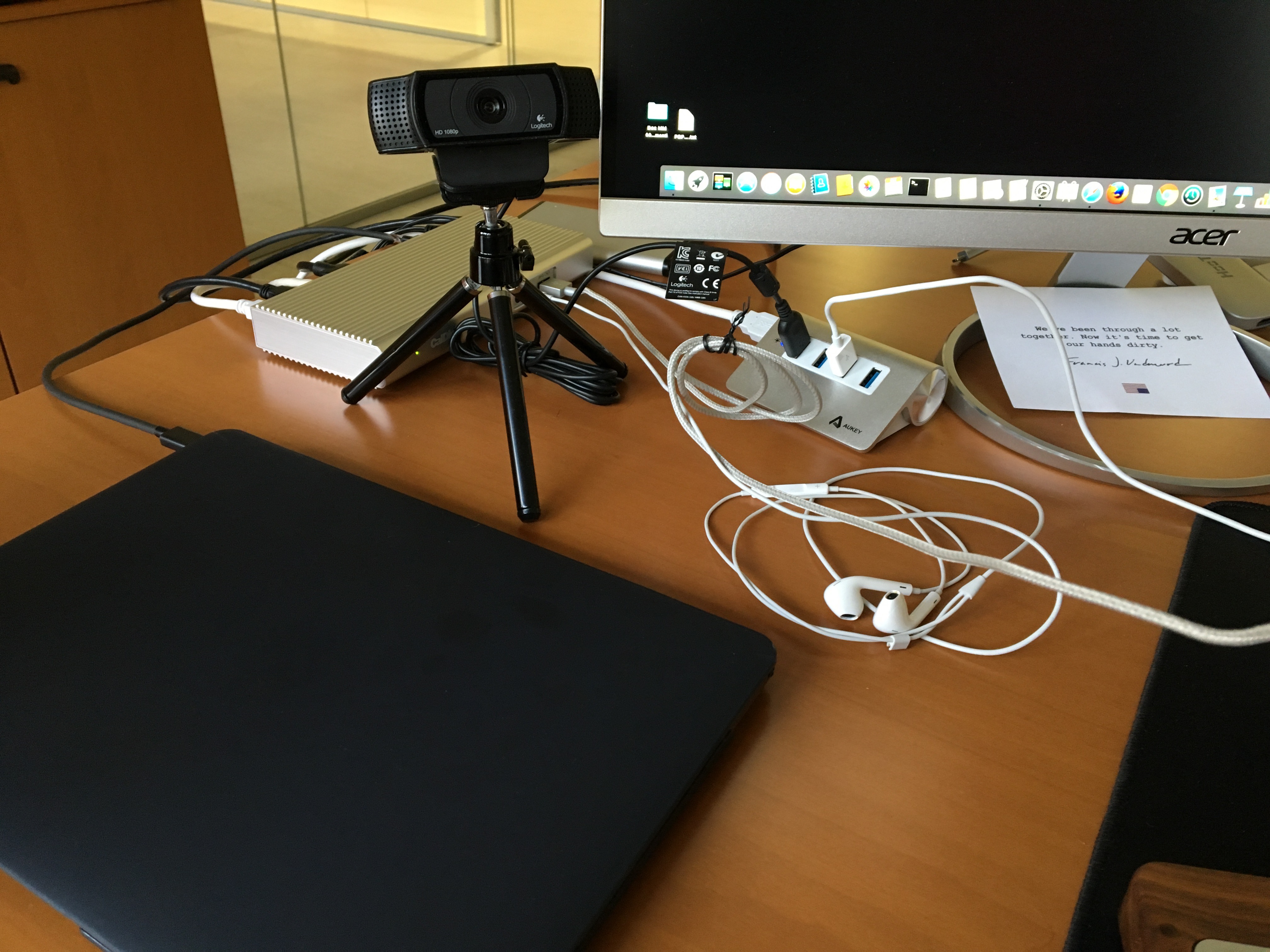

after just six months, here is my rMB desktop nearly as I would like to see it...I waited so long the caldigit, but now all is fine. 2G screen, USB 3.0 backup disk, an Aukey hub for miscellaneous and the RMB above it all.
