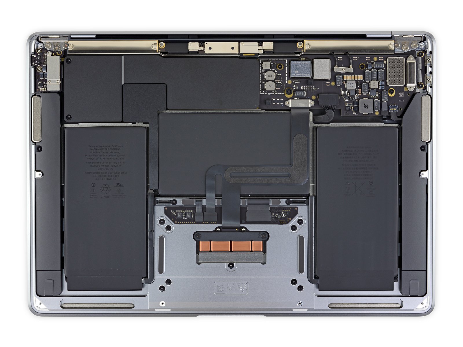

I have 16GB M1 MBA. Love it to bits.
While playing some games on it, I noticed that CPU temps reach 95 degree celsius and stay at that temps the whole session. (used the "Hot" app). The "battery gas gauge" temps were around 45C max.
I am not worried about processor getting fried, I know Apple must have done their R&D for the fanless design.
However, I am worried about battery degradation. Will it be minimal? Should I just stop playing games on this machine?

CPU isn’t going to heat the battery much at all.

There's a gap between system board and batteries but best to monitor battery temps.

Thermally, the battery is far away. The CPU temperature reading represents a very localized temperature. The system is designed to carry that heat away, toward the back of the machine.

Thanks, I got hooked to that thread and read the whole thing again. You are right that #21 caught my eye too and it is exactly my concern. Apple on their website also says that ideal "safe" temperature for battery is at around 35C max, so seeing 40-45C figure on the battery does worry me a bit.
I haven't purchased AC+ because it is very expensive where I live, hell I had to save diligently even to get this current configuration and I would be very disappointed if I were to damage the battery knowingly for few hours of enjoyment.
Was that listed as ambient temperatures though? Usually they are, as listing a sensor temp isn’t useful for the average user. It’s more a statement that battery health can suffer if you intend to use it outside, during the day, in certain regions where summer heat gets above 95F/35C.
But for charging LiIon batteries, the number I usually see is charging should not exceed 45C at the battery. And charge controllers should adjust the charge rate to stay under this. Discharging the battery is generally okay at closer to 55C.

Oh right! Yes yes I guess, Apple's website would list ambient temperatures indeed. You cleared it up right away. I just purchased an aluminium plated laptop cooler (that would also help my neck angle) and it visibly makes my mac run cooler even on the said sustained 95C loads. CPU does get hot around 97C but rest of the body stays cool or at best gets only warm to the touch. As opposed to without using a cooler where body would get hotter, certainly not warm and hot enough to work me up to make this thread!
I would assume since the body is only warm to the touch ambient temps would be well under specified limits and I can just use my mac happily without worrying too much about battery health.
Would it be okay if I charge it 100% and keep it plugged in for gaming sessions? Would that be equivalent to "charging" the battery?
Thanks, I see. Thing is the whole body is aluminium so I was worried if it would "cook" the battery inside by having the heat from processor radiating to the body and making every component run hot.
