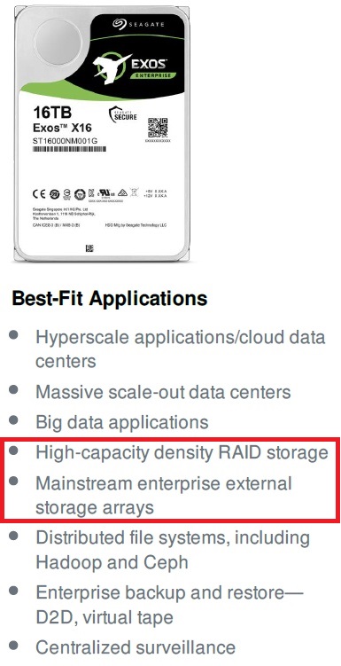

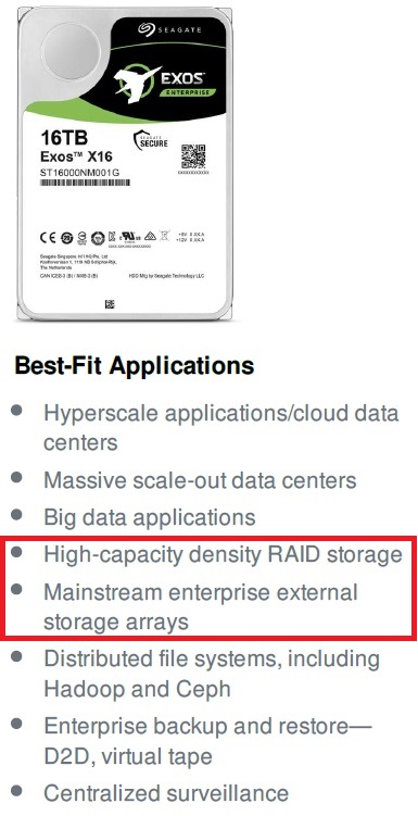

I am planning to remove the 5 Toshiba hard drives from the Pegasus J2i and R4i, and to use (instead) 6 of these hard drives:
Any difficulties that I should anticipate before doing so?

So, you think that consumer NAS drives are better than enterprise drives, enterprise drives that are designed for RAID arrays?

@s66 : When I look at the Seagate page, there are 4 categories of hard drives:
and the Exos Enterprise drives are listed with the NAS drives:
Everything I see in the specs / description leads me to believe that the Exos Enterprise drives are more durable than the IronWolf or IronWolf Pro.
For example: The # of Bays is "unlimited" for Exos Enterprise drives, and is limited to 24 bays for IronWolf Pro. Everything I see in the specifications makes me feel that the Exos Enterprise drives are better suited for this purpose than the IronWolf Pro drives. Of course, I am asking here, in case I am wrong!
Exactly. "Enterprise" > "NAS".
Check https://www.seagate.com/files/www-content/datasheets/pdfs/exos-x16-DS2011-1-1904US-en_US.pdf

The main issue with NAS/array drives vs. system drives is that arrays get some really nasty vibration issues. The Exos drives are specially designed to handle the vibration issues.
Perhaps in the distant past there were enterprise drives without vibration management - but those are from days of legend. All of my servers come with embedded HW RAID controllers and 8 to 24 drive bays.
