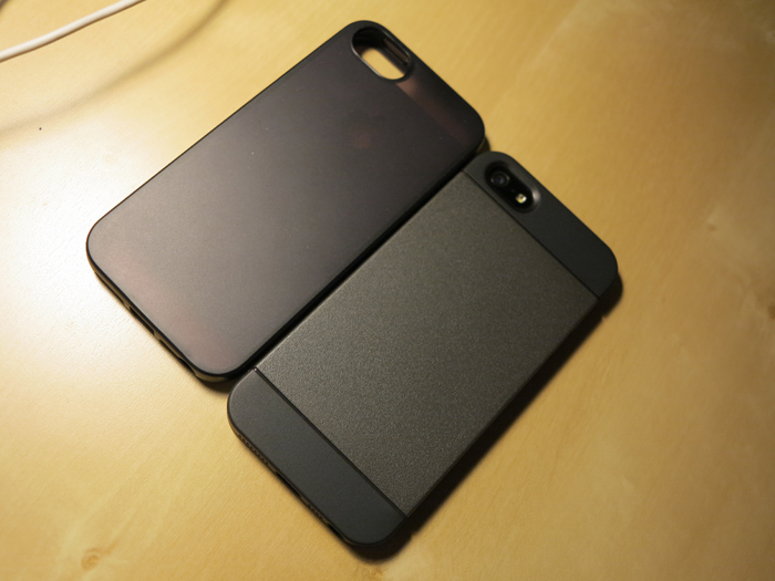

and here it is next to my Belkin, notice the belkin has a slight purple/reddish hue to it...that's accurate)

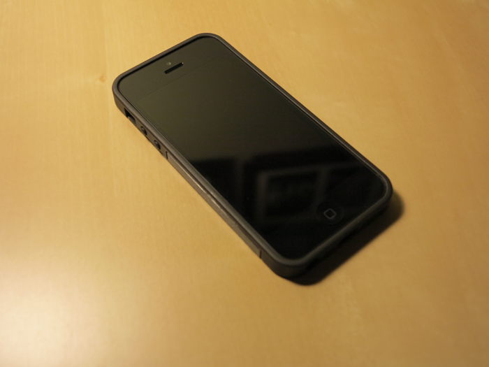

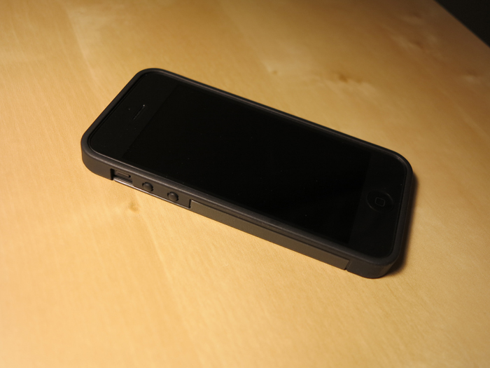

It's just the photos... Your TPU section is a lighter gray than the plastic middle section. Mine is nearly black after the dye job. With case installed, the edge is black, just like the black iPhone.

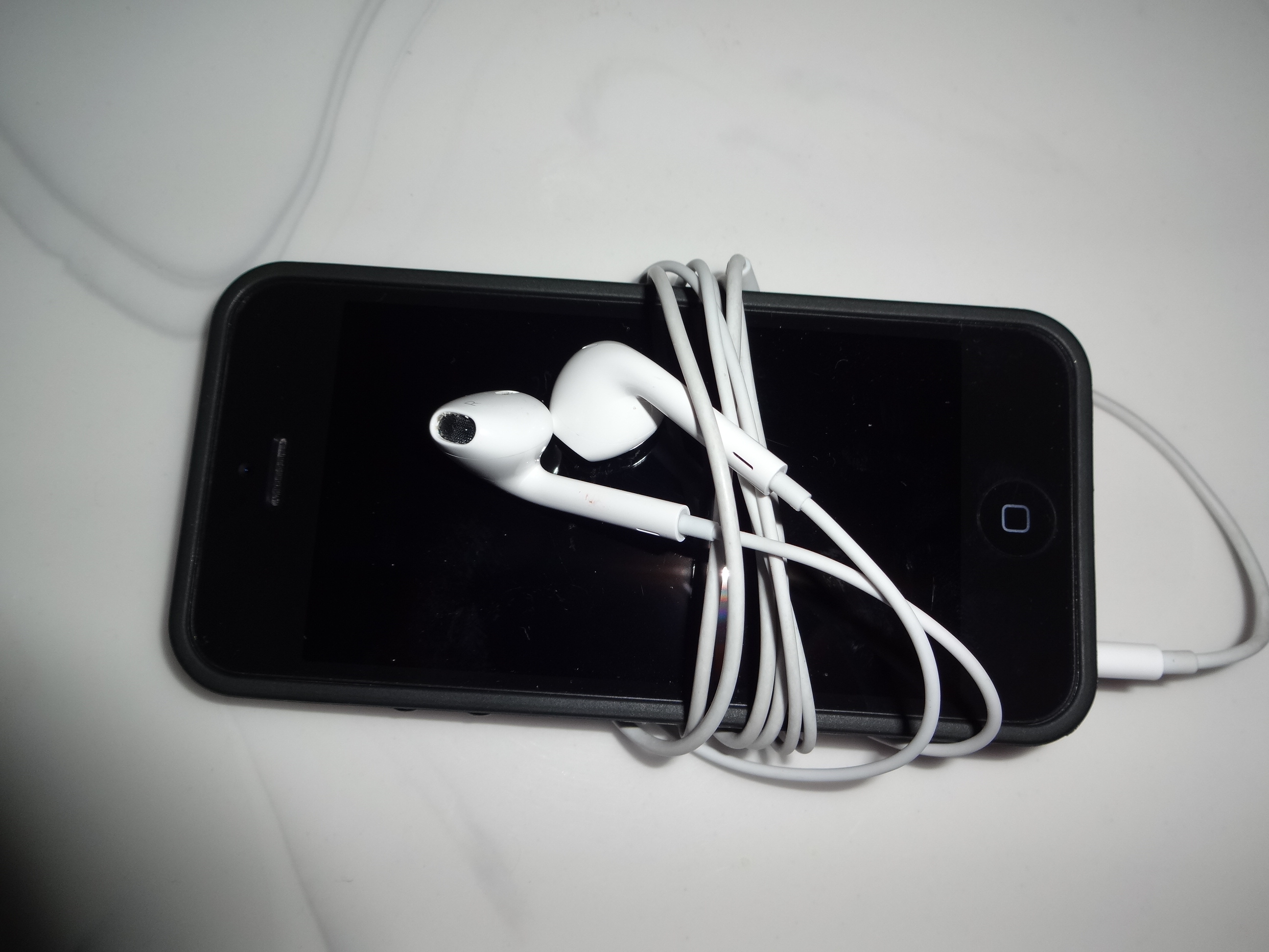

Here's a photo showing the OEM lighter gray color, compared to the black of the iPhone:
In my photos you'll notice that lighter gray is now black.

i notice an apple logo and darkening on the back of the empty belkin case, is that some kind of cardboard insert? or did the phone itself cause that discoloration on the inside
Good eye, it's a custom vinyl insert made by grfxp.com. It gives the belkin case a more iphone 5 two color look to it!

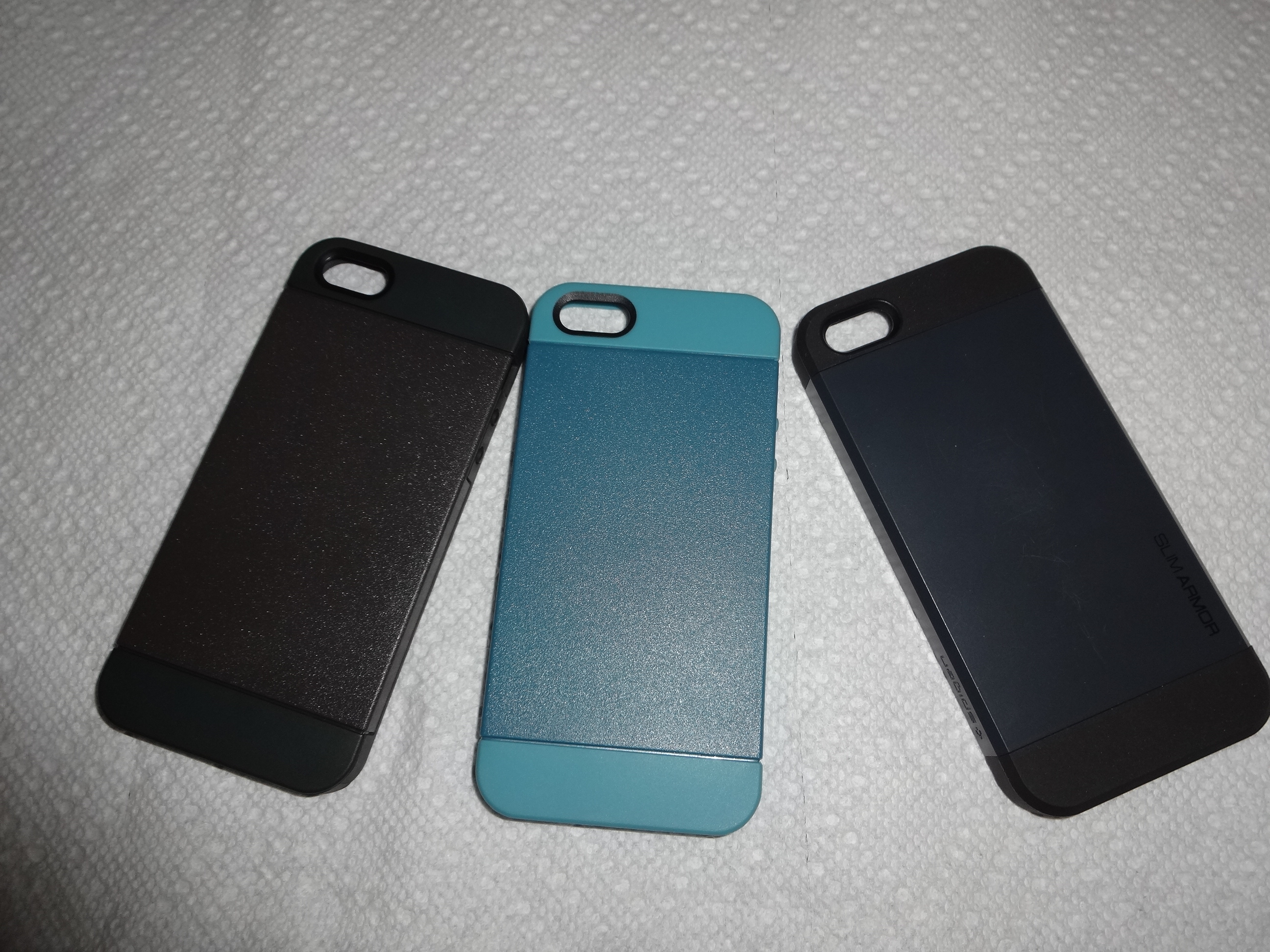

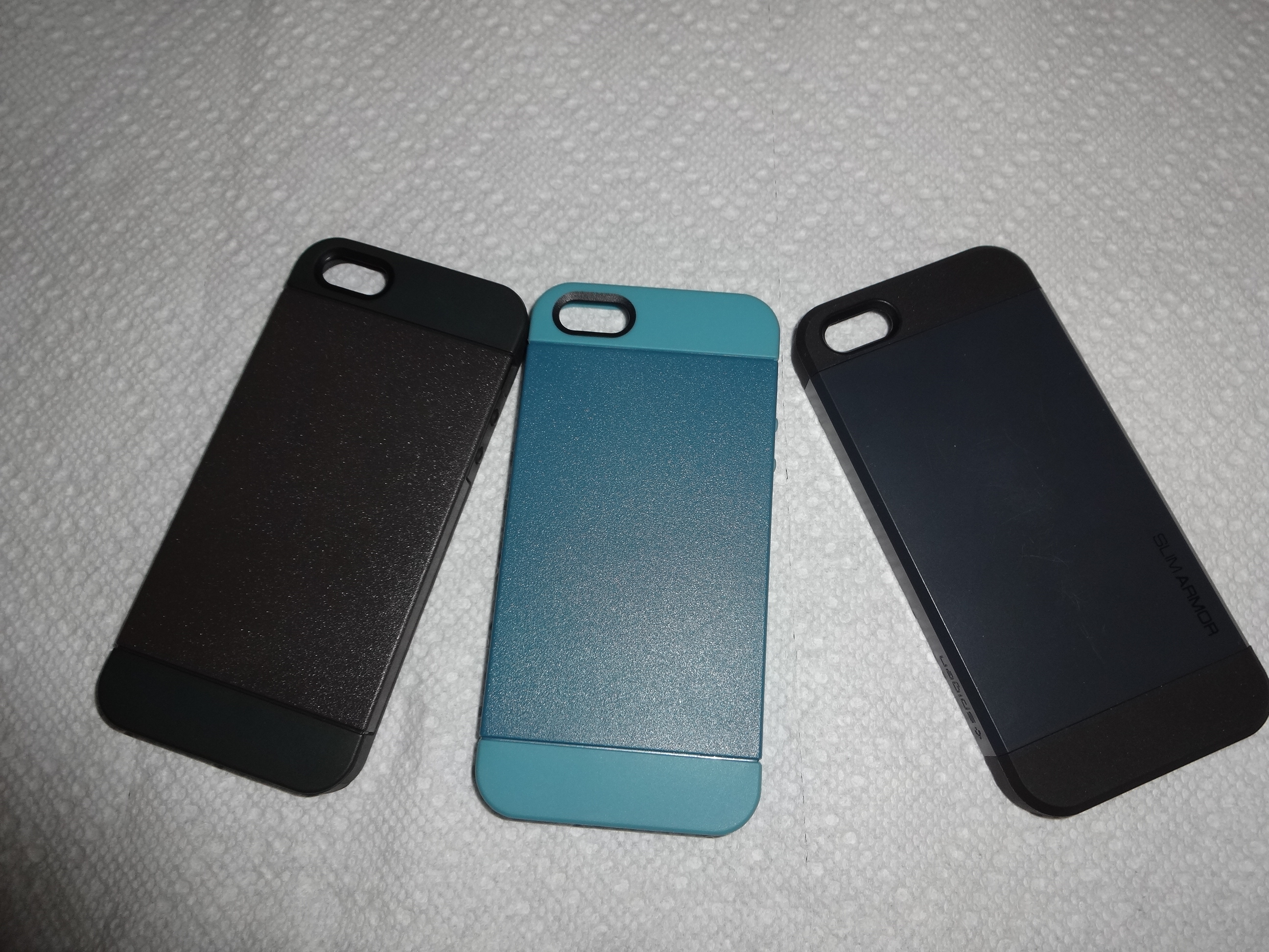

RIT dyed Tones compared to Slim Armor

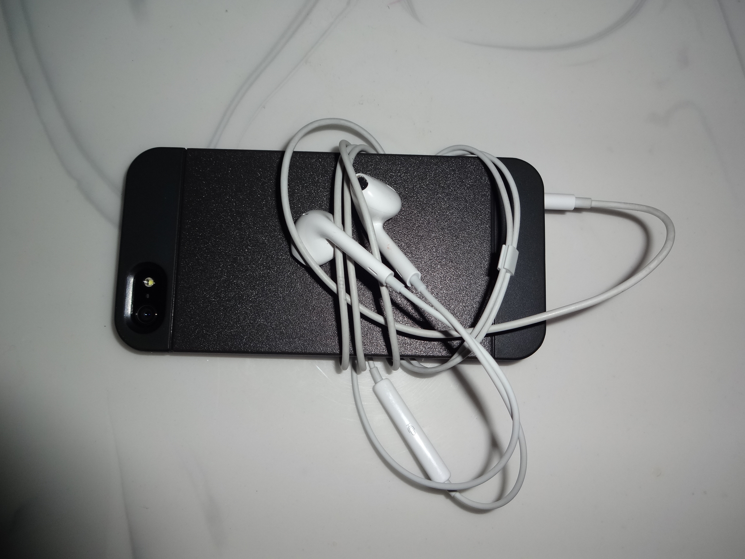

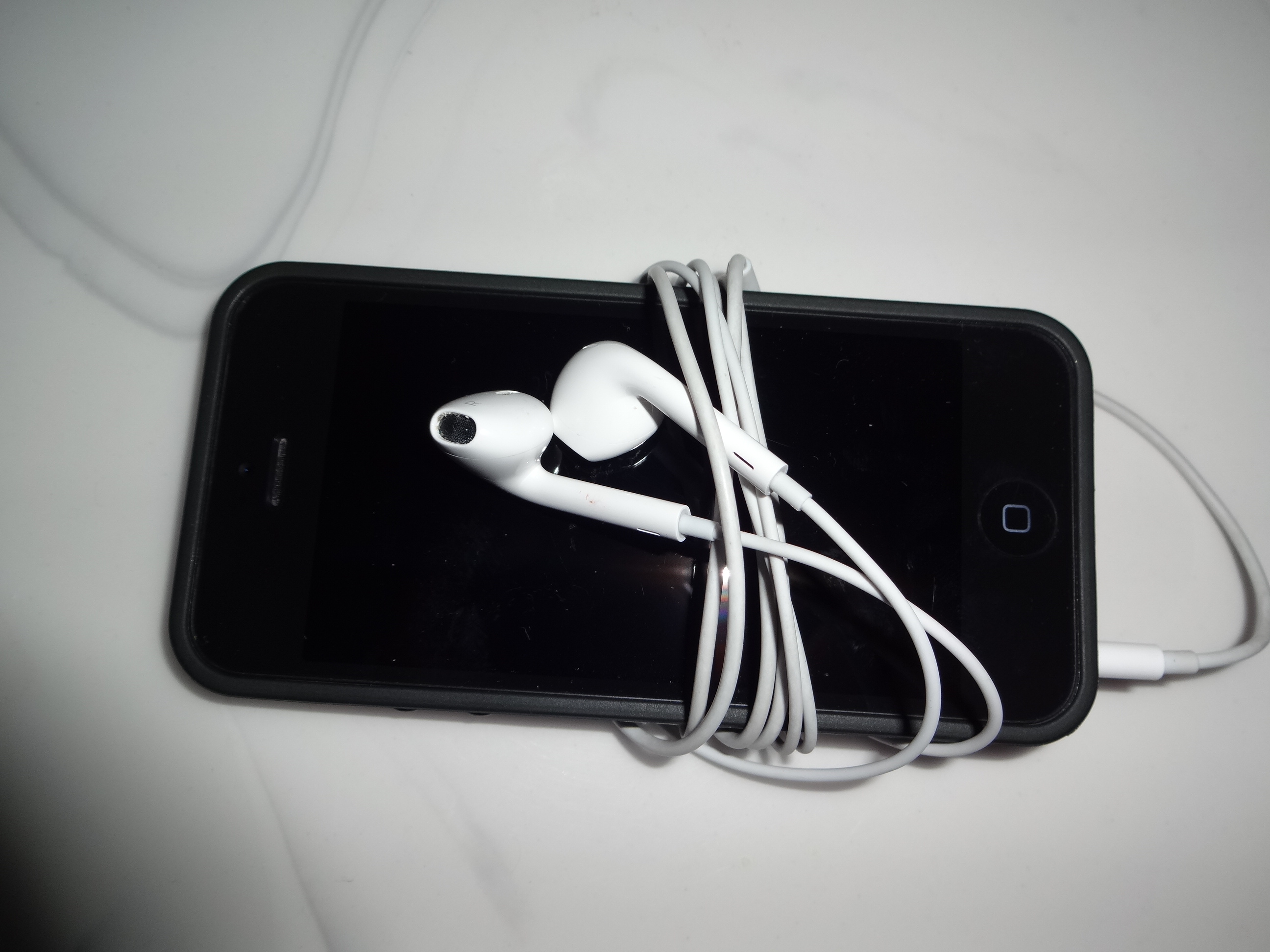

Okay, so I RIT dyed black my 'black' Tones case. Came out really nice!
I didn't use simmering hot water, but the very hot water from my faucet. It comes out very hot, that I can't keep my finger in the water stream for more than a second. Took about 35 minutes.
I read up a bit. The polycarbonate doesn't really take in the dye, which is fine. But the TPU does (hence the problems people had with a white Tones and blue jean stains). My came out black enough and since the TPU part is the top/bottom back and all the front rim, it really takes away the 'grey' look.
Very nice fix! I didn't boil the water, but on low on stovetop. Just scalding hot. Took 45 min at this temp to get real black.
Photos on how mine came out: RIT dyed Tones, OEM Tones Blue and Spigen Silm Armor for comparison.

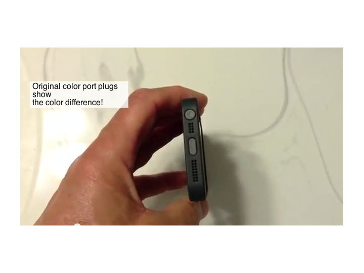

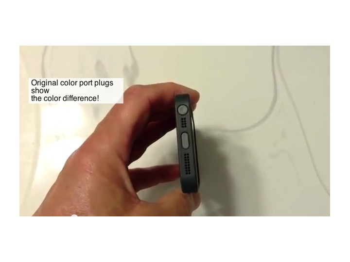

Okay here is a quick YouTube video showing all sides after the RIT dye black job I did. I put the original OEM port plugs in the case so you can compare the original Tones 'black' color with the new dyed color.
It's easy, just be careful not to make a mess, or use your wife's pots. I bought a cheap one at the store.
YouTube video and snapshot of the bottom case with original port plugs.
http://youtu.be/Sv146BNS6Og
