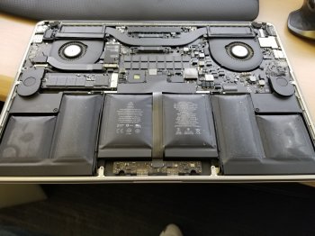

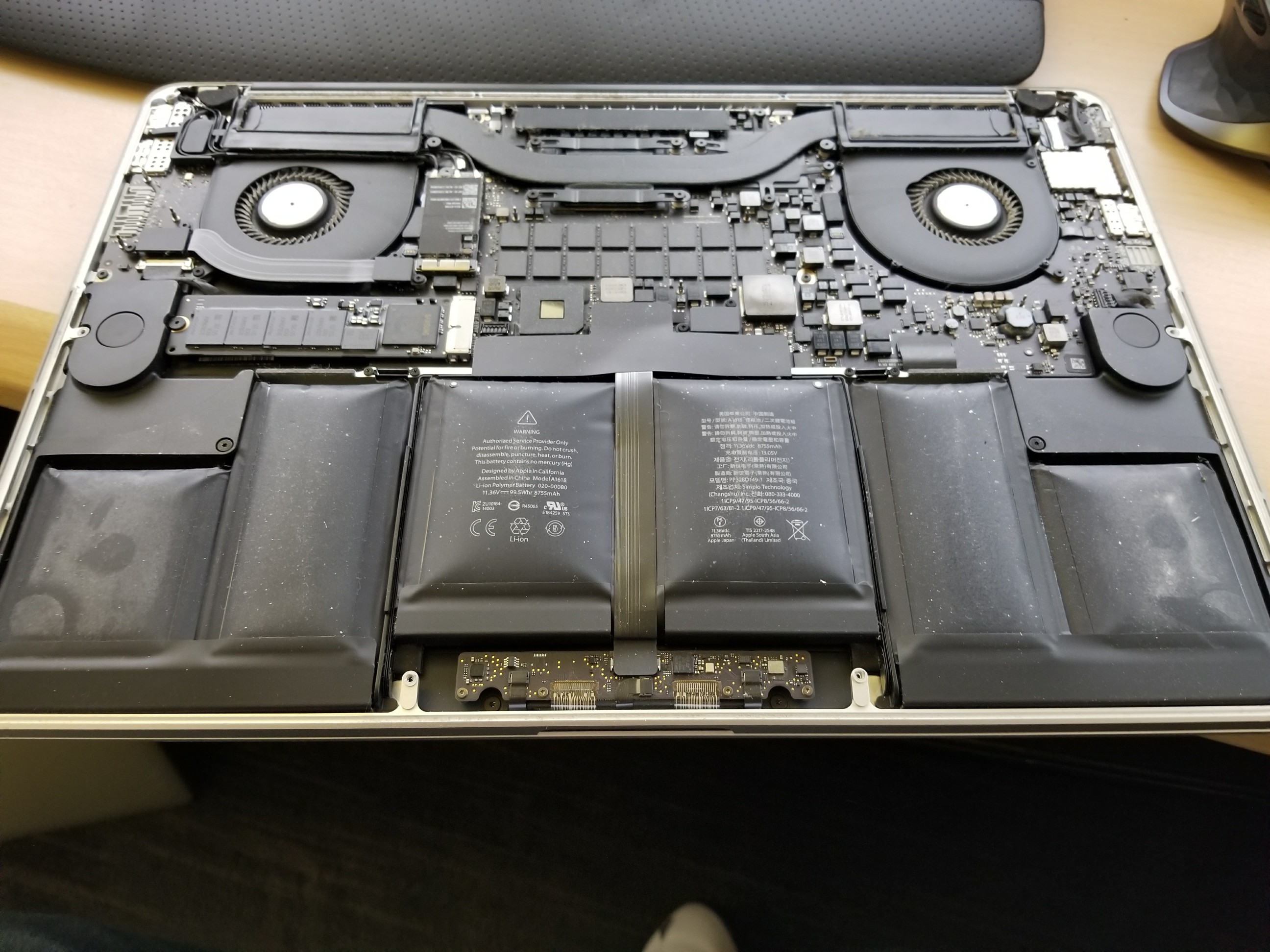

Second time in two years, I have to get the battery of MacBook Pro (Retina, 15-inch, Mid 2015) replaced due to swollen battery issue. Anybody facing the same issue?
Seems like there is inherent manufacturing defect of the battery for this model.

When I brought mine in, they ran a diagnostic test, and did a physical check. It was obvious the battery was bulging, since my trackpad was practically frozen stiff. And the laptop rocks from side to side.
They gave me a new battery with fresh top deck, since it's glued together.
Yep, had a guy at work bring his machine in because he said it was warped. I took a look at it, and the bottom cover was bowed out, so I told him it looked like the battery was swelling up. I hadnt seen that happen since the pre-unibody machines, so I was pretty surprised. Sent it in to our warranty provider and they replaced the top cover, so he got a new keyboard out of it as well since its all one piece. His battery only had 200 cycles on it

some nice airbags you got there on this macbook
at least it won't break when dropped
It might in fact explode 😱
