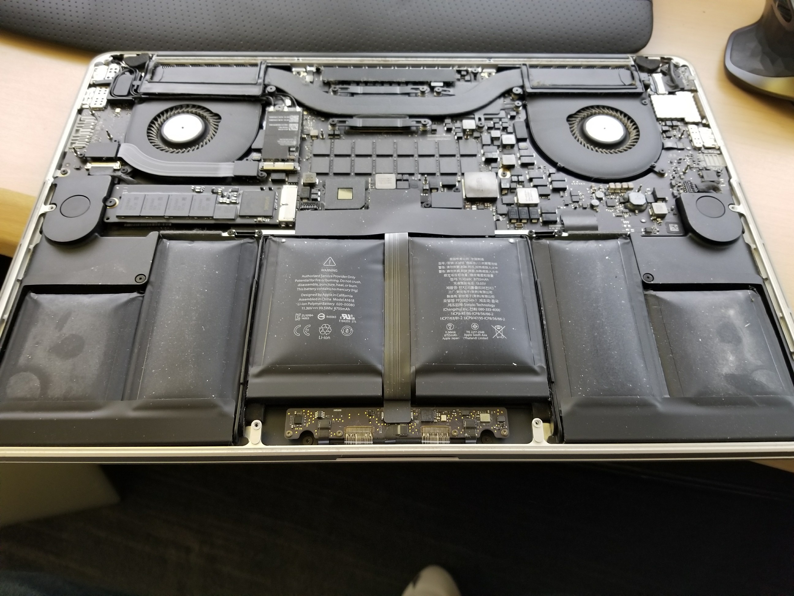

Yep, had a guy at work bring his machine in because he said it was warped. I took a look at it, and the bottom cover was bowed out, so I told him it looked like the battery was swelling up. I hadnt seen that happen since the pre-unibody machines, so I was pretty surprised. Sent it in to our warranty provider and they replaced the top cover, so he got a new keyboard out of it as well since its all one piece. His battery only had 200 cycles on it
I can see one battery being bad but from your image ALL the cells are bulging, that is crazy! Makes you think there is something wrong with the charging system.
Could be. They did change it out, and I gave the guy a new power adapter, so we'll see what happens from here. Of the 300+ mid 2015 Mac's that we have deployed, he's the only one that has had this issue (so far)

Second time in two years, I have to get the battery of MacBook Pro (Retina, 15-inch, Mid 2015) replaced due to swollen battery issue. Anybody facing the same issue?
Seems like there is inherent manufacturing defect of the battery for this model.

LiIon battery swell when they degrade. My guess in the battery on your powerbook is quite swollen also, but is inside a plastic case. At some point is will break that case. Since 2009 or so MacBook batteries are not been housed in plastic cases. The are in packs and starting with the retina MacBooks multiple packs under the keyboard and trackpad.
Your case of replacing the battery for free is unusual and may be due to laws in your country. In most countries you are on you own after a year or two, unless you buy an extended warranty.

Mine is 15” MBP Retina mid-2014 i7 16GB RAM 1TB SSD, got it in mid 2015. Just experienced swollen battery too. Of course it’s just outside of AppleCare warranty. Brought it into Genius Bar, guy told me it will cost ~US$200 to replace the battery but any other damage caused by the battery will be free of charge, i.e. motherboard, top panel, etc.
What I don’t get is this swollen battery look very similar to the current 13” MBP battery that’s being replaced right now under their replacement program. How do we know there aren’t more similar incidents? The supervisor even told me he experienced similar swollen battery with his own MBP and he had to pay for the fix too!

I have a Macbook pro, 15-inch, mid-2015 purchased around March 2016. The battery started swelling after about a year. At first it was very slight, but gradually the swelling accelerated. By February 2019 the swelling was so bad I feared it would catch fire or explode. So, I shut it down and put it on my tile floor. I called Apple and the told me to send it in for a $99 repair, which I did. The whole repair cycle from drop off at FedEx to having it back in my hands took less than 48 hours. That was 15 Feb 2019 and Apple never charged me the $99.
About 3 months ago, the swelling phenomenon started again. Now (28 Dec 2020) I have my MacBook Pro sitting on an inch and a half thick granite cutting board just in case it catches fire. Looks like I need to repeat the replacement dance.
BTW, I totally agree with reddevil0728 that there is "some intrinsic issue" since the same thing happened twice for me.

While it probably does not matter because of the recall, but, do you leave it plugged in all the time. That has been known to reduce battery life.
Yes, I leave it plugged in most of the time. When I bought it I basically switched from a Desktop setup to using the Macbook pro as a replacement CPU, but having the portability when I need it.

openmic wrote:
"BTW, I totally agree with reddevil0728 that there is "some intrinsic issue" since the same thing happened twice for me."
An important question:
Are you one of those "I leave it plugged into the charger all the time" guys?
Then... THAT'S where the source of your troubles lies.
Once you have a fresh battery installed, here are my recommendations as to "maintaining" it:
- You can leave it plugged into the charger during the day, but 3-4 times a week, take it OFF the charger and let the battery run down to about 40% or so. Then, plug it back in.
- At night, whether you power it off or just let it sleep, DISCONNECT THE CHARGER FROM THE WALL OUTLET. Then, plug it back in the next morning.
I suggest doing this via the wall outlet to reduce wear and tear on the Magsafe connection.
Do these two things, and I'll reckon your battery will last A LOT longer.
My opinion only.
Others will disagree.
Some will disagree vehemently.
Reactions: openmic
