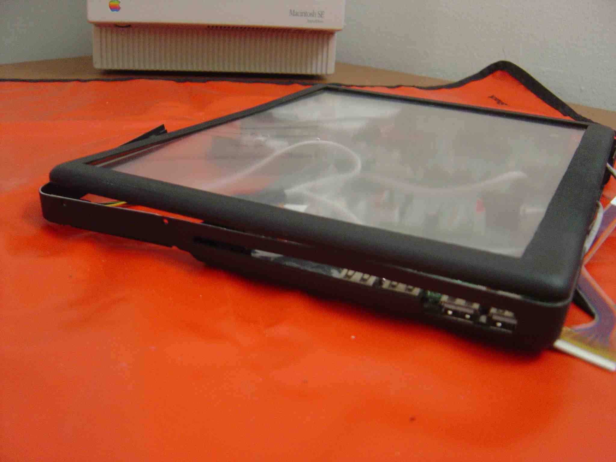

I wonder if a slight wedge shape would have worked for that. Like, thin on one end, thicker on the battery end. That way it could sit at an angle on a table to be used while sitting down, too.
I dunno, just thinking out loud. I'm excited to see the final result!
Actually, thats exactly what i was thinking, but like i said, it'd be very slight! about .06-.08in to be exact. Even on the other side of the device, there is a need for thickness...it's where the logic board is, and while the board itself is thin, when u add in a fan and heat sink, u need more space.
But it's looking alright so far. Also, the tablet will be severely easy to open up and service, unlike the powerbook. there will be about 6 screws holding all together on the outside, while on the inside there will be 4 hinges. The hinges will allow you to swing around each layer (touchscreen, lcd, all else). Hopefully it all holds together well!

how thick is the touch panel overlay? I am building a tablet G3 iBook and am a bit worried about how 'creative' I will need to be when it comes to adding the touch panel.
yep, they charge $20 extra for the mac version of their drivers. I didn't ask why.
It's not too thick. The exact dimensions are given on the product page.

"A minimum space of 3 mm (1/8") is required inside of the LCD case."
Is the panel actually 3mm?? Seems thick. How does it compare to the thickness of the LCD screen?

Yep, i'd say it's about 3mm. A little thinner than the LCD. The total cost before shipping was around $165. It was around $175shipped.

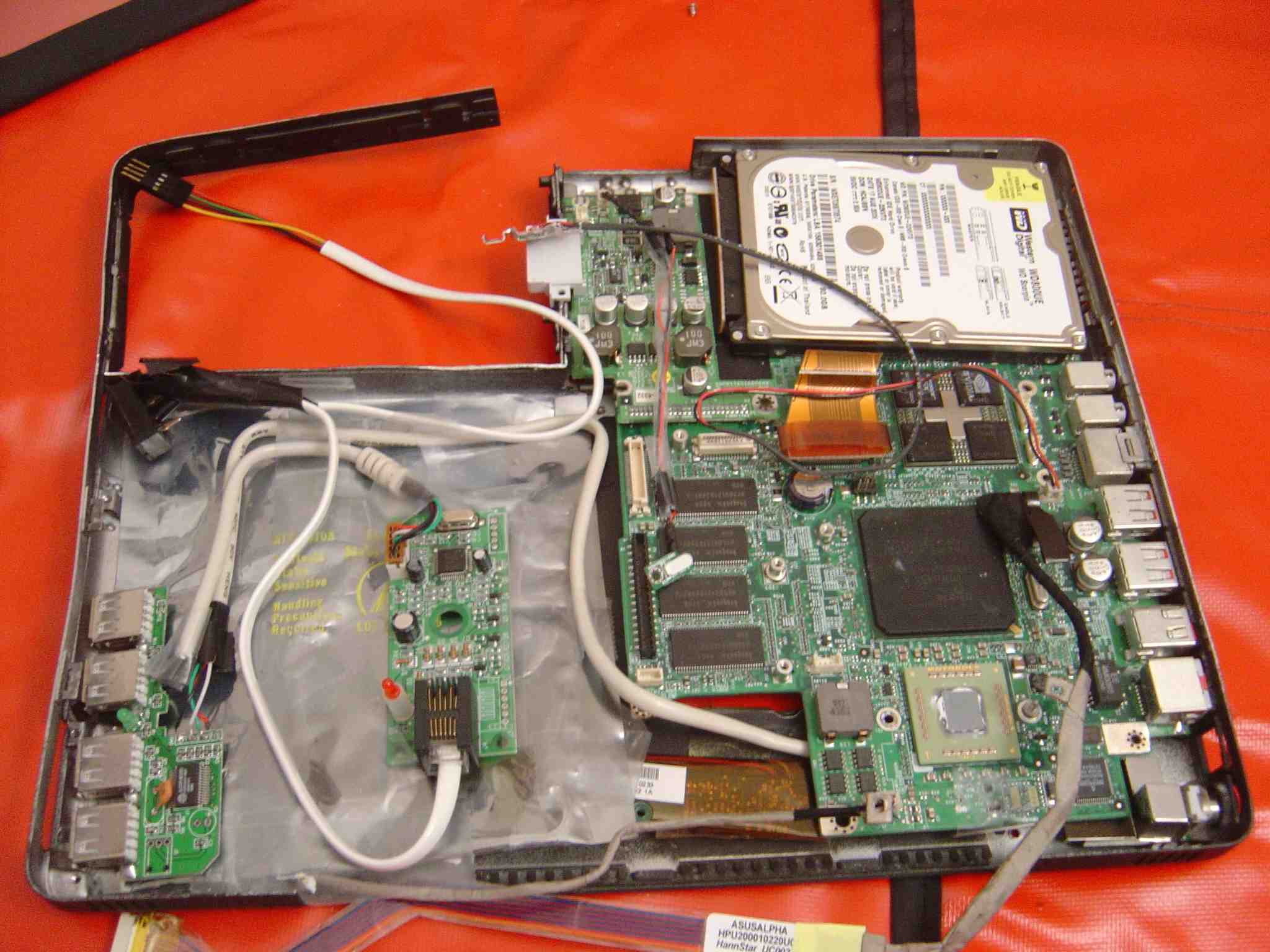

I have been contemplating a similar mod as this one, and here are my thoughts on it.
If you remove the SuperDrive, you should have enough room left for a second hard drive (bringing the maximum capacity of the system up to 500GB) and a small 4 port USB 2.0 Hub. What you could then do is directly solder the tablet to 1 of the left side USB ports, and then, solder the hub directly to the other one. Fashion caps of some kind to cover those ports up... don't want them shorting out.
The only hitch to this would be powering the USB hub, but if you can work out the voltages on the DC-DC board, you should then be able to run a lead off of there back to the USB hub to supply the needed 5V at 2.6A.
By dremeling into the existing slot for the old SuperDrive, you can minimize the amount of destruction that you do to mount the USB hub, and shabim shabam, you just doubled the number of USB ports on the system, as well as doubled the hard drive capacity of the system. Also, right in there should be a good place to re-wire your power button and your future hold switch/button.
The IR port is a good idea, but the question is... where would it go? Where is a good place to put it.... it all depends on how you want to place the Slate when you hook it up to a TV.
One last thing. What panel are you using, and what resolution is the screen? I have been seeing SXGA+ (1440*1050) screens on ebay, and if I were to start this mod, I was thinking of using those.
Wow, you've pretty much described what I've done here. The 4 port usb hub miraculously works without needing power (I had a keyboard in one port and sync an ipod in another with no problems at all...i ruined the last port in my first soldering effort...)
As for caps, all you really need is static paper to lay down on the metal...that's what's done on the rest of the notebook where the logicboard is. Maybe I miss understood your point
There is space for another HD, but it'd be a really tight fit (unless you went with a 1.8") and then you need to find a way to power it (on my powerbook, the connector for the superdrive is identical to that of the HD but I doubt if it's the same interface beyond that, and I don't have the guts to risk it and try). But I suppose there are external HD's that are USB powered now, so I'm sure you could easily gut one and drop it in.
I let the IR port go awhile back.
I'm keeping the same LCD panel that was in the powerbook to begin with, which was 1024 x 768. The touch screen itself comes from a company called keytec, who sells their stuff through magictouch.com . Not the highest grade stuff (meaning it feels like trash after playing with iPhones/iPod Touch's).

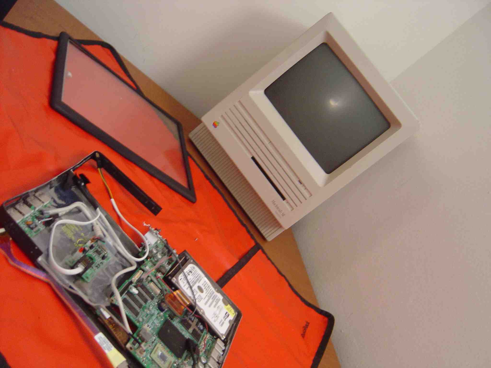

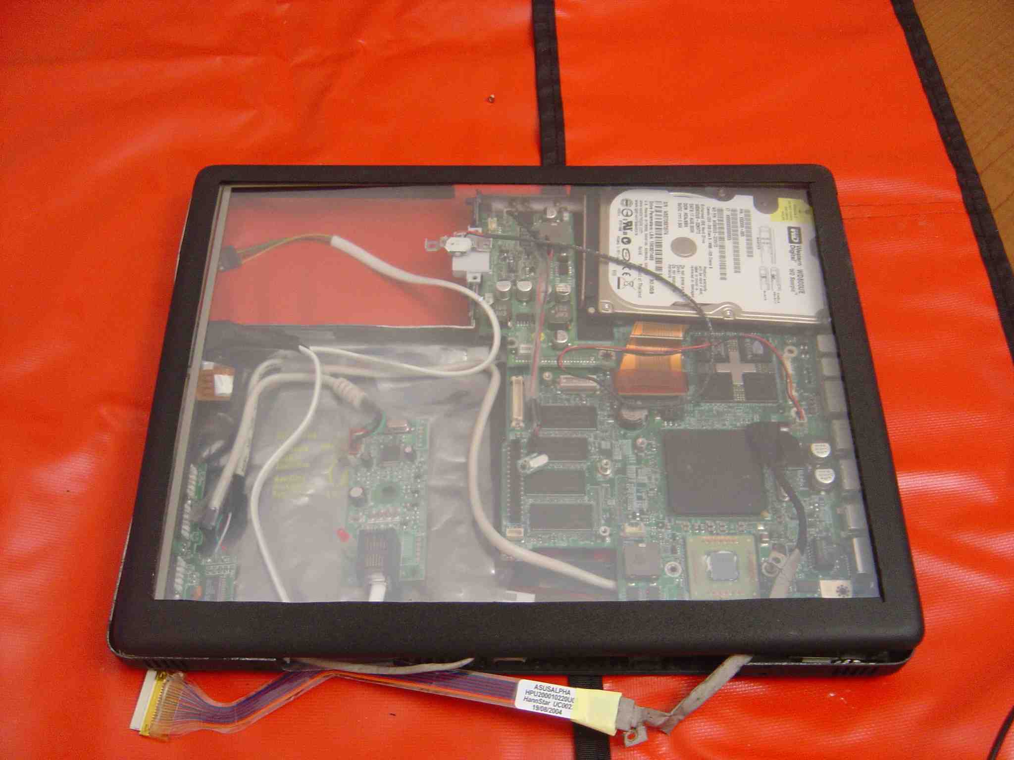

Anyways, turns out I left the LCD screen at home, so here's a shot of the stuff sans screen and some structural innards.
What I was talking about with the Hard drive is that you can get adapters that basically have it drop right into the same place as the SuperDrive, what you can then do is simply hack that thing apart to instead of having the long axis of the drive be perpendicular to the eject slot, have it be parallel to it, then, you might (MIGHT!) have enough room left for the USB Hub.
The caps that I was talking about would actually be for the outside of the system, to clog up the USB ports essentially so you don't accidentally put anything in there (never know that havoc that might cause)
Good to see it coming along, can't wait till I have the cash to do mine (god it would be so sweet if I can get the SXGA+ screen to work... those already have the wacom digitizer built into them, so that saves hackery to put in the touch abilities)
Well, as you can see from my pix, if you're willing to rework and even stack some stuff up, you can definitely get a 1.8" HD in easily, and a 2.5" one with some work. I'd rather leave more room for air flow, and save some money 🙂.
Oh yea, and I've already set to make some plastic caps for the used up USB port, as well as the modem port (i pulled that waste of time out!).

Thanks! I've got to go home for winter break and get my LCD screen, and my dremmel...but after new years you'll begin to see progress hopefully!
I like the classic in the background of that picture! 😀 I don't think I could handle doing any of this work you've done! Keep it up!
I found it in the dumpster 🙂
Thanks!
