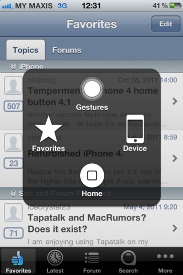

To those who have Home button problems and don't want to exchange the phone in case of getting a refurb unit, upgrade to iOS 5. It has a Assertive Touch feature under Accessibility. It allows you to have a virtual Home button. See image.
Double tapping the Virtual Home button will bring out the multi task tray.
Woes begone!
