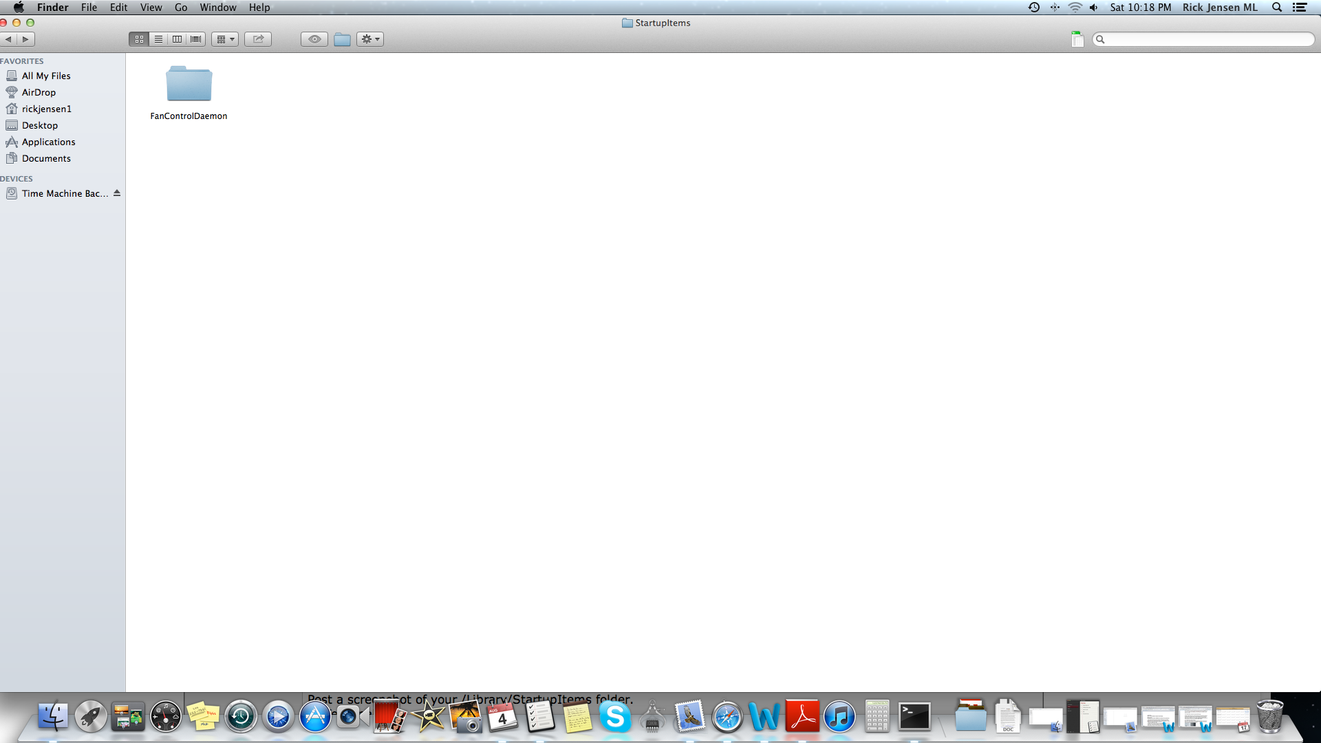

Post a screenshot of your /Library/StartupItems folder.

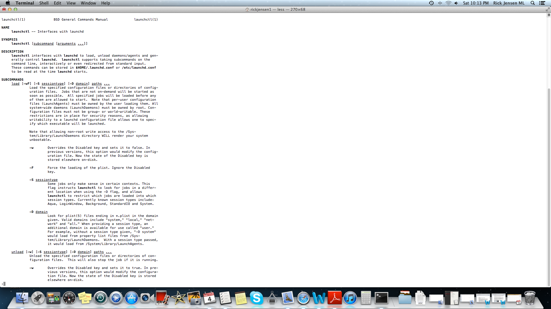

In Terminal :
Code:
man launchctl
1st output:

Screenshots attached. Wasn't sure if you meant a shot of code in terminal, or of HD folder, so attached them both.

Provided you installed iMacFanControl1.2.dmg and downloaded the modified FanControlDaemon and moved it to the /Library/StartupItems/FanControlDaemon folder. Ownership and permissions seem to be right judging from the output.
