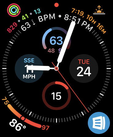

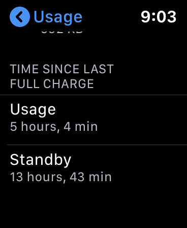

AOD On, Noise Off, Background Refresh Off, Screen time setting 15 seconds per glance, complications as shown below, iPhone XS Max on iOS 13.0. Around 100 notifications. Watch used to get two factor code to unlock my virtual computer for work about 7 times. Checked usage on watch about 5 times and took screen prints throughout the day. 35 minute indoor treadmill run workout with watch also powering bluetooth Plantronics Backbeat Fit earphones.
Below are pics of where I ended up at bedtime. I was awake not quite 14 hours, so I learned ALL hours in use are counted as standby, even when watch clearly in constant use for workout, etc. You can't really add the two and count as good since actual usage double counted as "Standby"
I also learned I don't know how the watch calculates "Usage".
There is no way the screen was on for over 5 hours, nor did I have an app running for that time, etc. Any help on how "Usage" is calculated would be appreciated.
Looks like watch might have just made 18 hours in this scenario if you add usage and standby, but as mentioned, "Standby" includes a workout with bluetooth. But my S4 would have been at 40% or more at bedtime.

Did not know that about standby as far as usage being included in the standby hours. I always thought you had to add both to get actual battery life number.
Seems obvious now since I tracked my total time on watch closely yesterday. Still wondering if Apple is inflating the "Usage" numbers too. In fairness, I don't know how long the remaining 15% would have lasted me and whether it would have discharged slowly or not. Can't stay awake that long with my early work start.
Standby beeing the total time after charge was obvious to me from the start, also on S4 from 5.2 on (my first AW). And im also in the dark where they get the Usage numbers from, as they are always much above that which i logged as actually using the watch for either apps, workouts, notifications or general interaction with the watch.
