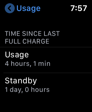

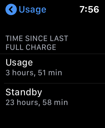

Below are some battery percentages I took at different times of the day along with screen shots of usage. The first screen shot is the series 4 and 2nd is the series 5.
Both watches were set up the same, latest watch OS, etc. Both had the noise app always listening, raise to wake on, background apps refresh on. Only difference series 5 of course had always on display turned on.
Series 4
7:55am removed from charger
11:15am 94%
11:46am 91%
7:05pm 69%
10:43pm 55%
11:55pm 53% removed from wrist
7:56am 46%
Series 5
8:00am removed from charger
11:01am 93%
12:50pm 85%
6:53pm 58%
10:21pm 40%
1:02am 31% removed from wrist
7:56am 23%
