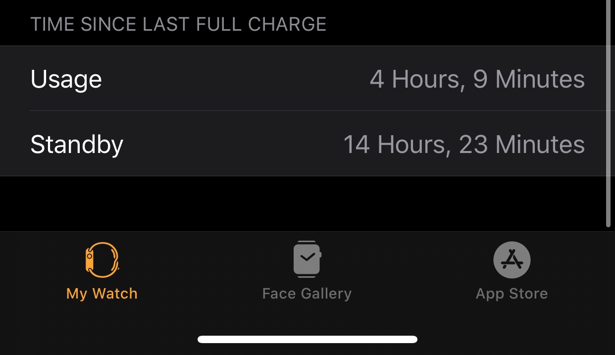

39 hours 15 minutes standby
3 hours 23 minutes active
w/ 16% left.

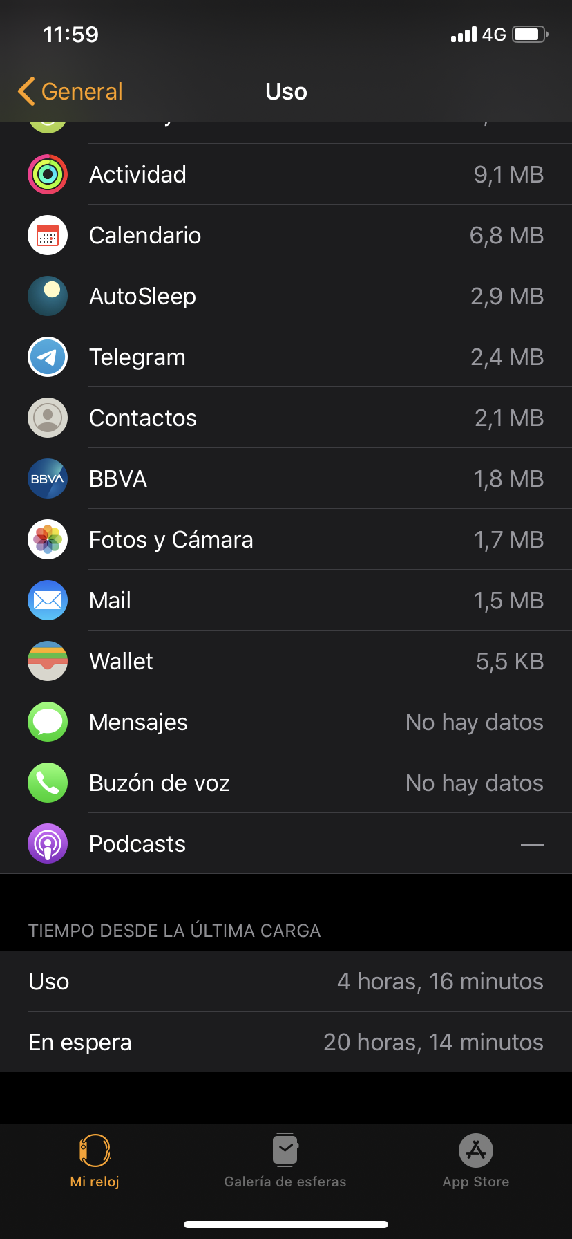

sbti 44mm. aod on, wrist to wake off, cellular always on but mostly near my phone. busy work day yesterday, no gym and after 18 hours was at 56%.
day before, did just under an hour at the gym with cellular streaming from apple music and workout app running. At 18 hours was around 40%.
Battery seems to get better with every charge and thrilled that I can now do a solid workout and still have plenty of battery before hitting the pillow.
