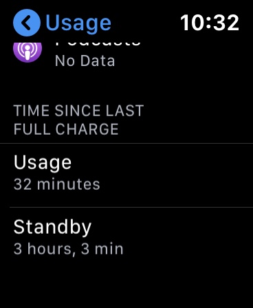

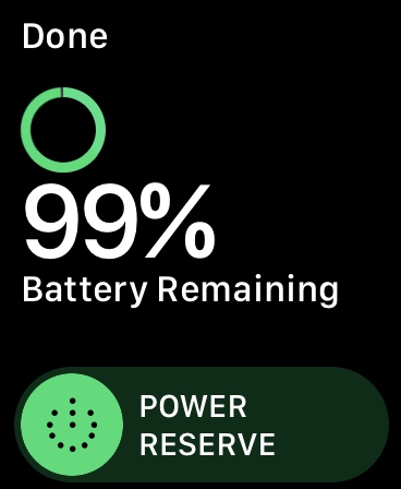

1% after 3 hours ...
Its my S5's first day of use, so far the battery has stayed at 100% ~2hrs usage , exactly the same as my S4.
