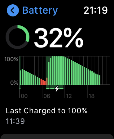

Hello. I upgraded from series 1 to series 6 gps a week ago and can’t believe how poor the battery life is. Please see screenshot. Seriously thinking about returning it to Amazon as faulty or maybe performance not adequate.
I would add that it has barely been used today.
The battery on my series 1 that was several years old used to last me a day and a half minimum.
Very disappointed as I had been looking forward to getting it
Hardly use the watch at all to be honest. Today a few times the hand washing timer came on, read a couple of message notifications, set a dinner cooking timer. That’s it. Due to poor weather today the step counter didn’t even hardly get used.
I have it on charge overnight and today I forgot take it off the charger til almost midday. The battery is tending to be at around 10-15% by the time I put it on charge at night but today it’s even worse since I forgot to take it off the charger til late.
It’s now two hours since the screenshot and it’s on 16% so gone down 16% in two hours and I’ve not even looked at it.
I will try restoring it tomorrow
You should be able to expect one and a half days out of a Series 6. If a reset does not change anything, I'd ask Apple for a replacement.

Which apps have you installed onto the Watch? Could it be one of those is draining power?

Might try a pair and unpair. My mums watch battery plummeted after a software update and this resolved it completely. As a point of comparison, I usually end the end day with about 40% battery left. And that includes reasonable usage including running with music streaming via cellular through Bluetooth headphones.

Only got a few apps installed,a voice recorder, radio app, grocery list and football scores
I’m going to try the unpairing and see how it goes today then if necessary reset and start from new. I did restore from the series 1 backup when I got this watch last week which maybe wasn’t a good idea
I had similar problems with a new series 5 I just purchase. Unpairing and repairing never seemed to help but using “erase all content and settings” from the watch itself and then repairing seemed to do the trick. It’s been two days since then and i average between 3-4% battery drop per hour. I was around 10% per hour before.
Yes, I am going to try that tomorrow. Doesn’t seem quite so bad today- I took it off charge 6 hours today and it’s on 55%, still not great though

The Apple Watch will also use more battery if it cannot maintain a Bluetooth LE connection to your iPhone (BLE takes very little energy). It will then try to connect to wifi and will use its own GPS (instead of the phone's GPS). Just to eliminate this as a possible cause, suggest keep your phone paired and reasonably close to your watch during the day while you are testing your battery life. (Check that the phone connection icon is green in the control center).
Obviously you will not wish to constrain yourself this way all the time, but just to eliminate one excuse for rapid battery drain. Also, if it is downloading an update or something this may increase battery usage. The point is that the battery usage may increase some days for other "behind the scenes" activities that you are not aware of, so should not make a judgment based on a single day usage.

I would try doing a factory reset and set up the AW from scratch, *NOT* restore from a previous backup.
Don't install any third party apps (automatic app install - off)
In the Watch app, go into General, Wake Screen and ensure "Wake on Wrist Raise" and "Wake on Crown Up" are turned off. Also ensure "Listen for Hey Siri" and "Raise to Speak" are turned off under Siri.
Swipe up from the bottom of your Watch and activate Theater Mode (double mask icon) so that the display is not always on while you are asleep/not actively using your Watch.
With the settings I listed above and wearing it overnight (sleep tracking on) I have easily gone up to 36 hours between charges. I typically have 30-45% remaining before I put it on the charger every morning when I get up.
