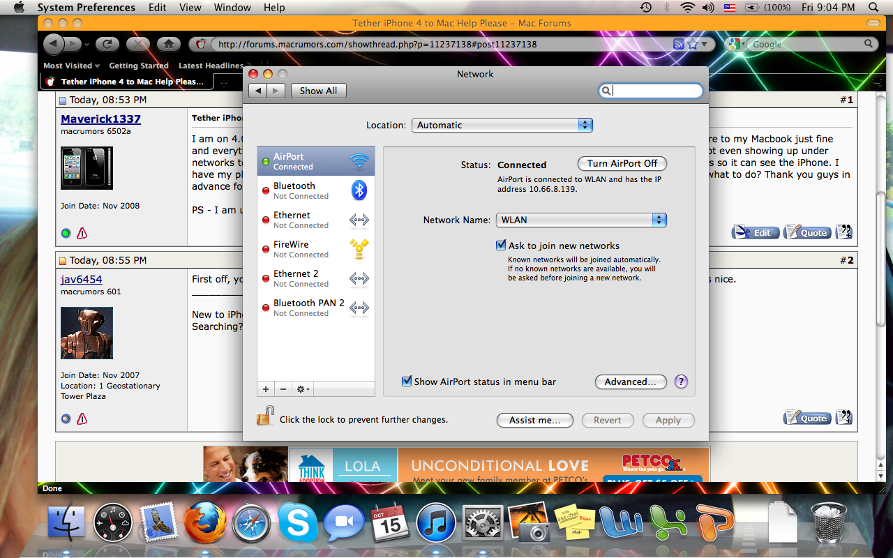

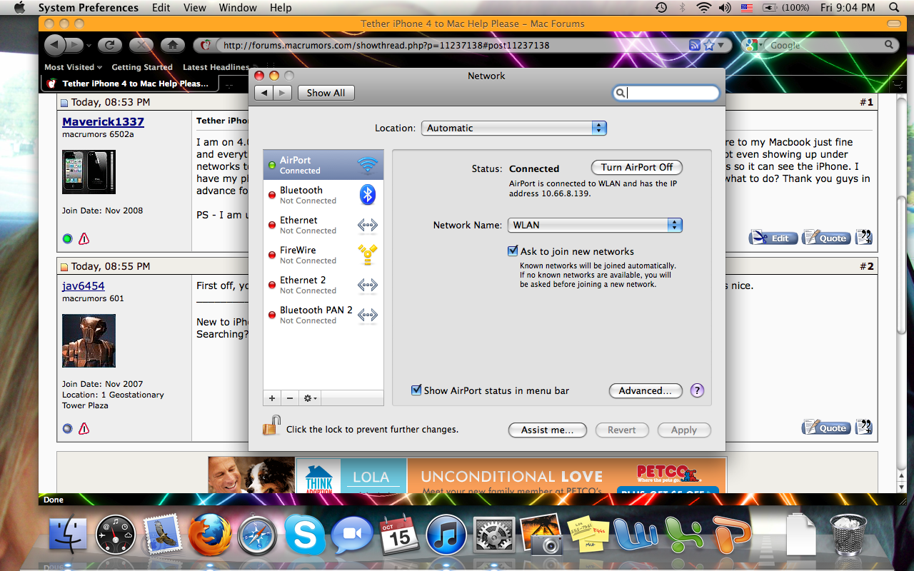

First off, you don't need iTunes open. Go to System Preferences > Network. What does it show? A screencap is nice.
Here is a screen shot. But keep in mind I have added those options, and this is of course with tethering on USB only.

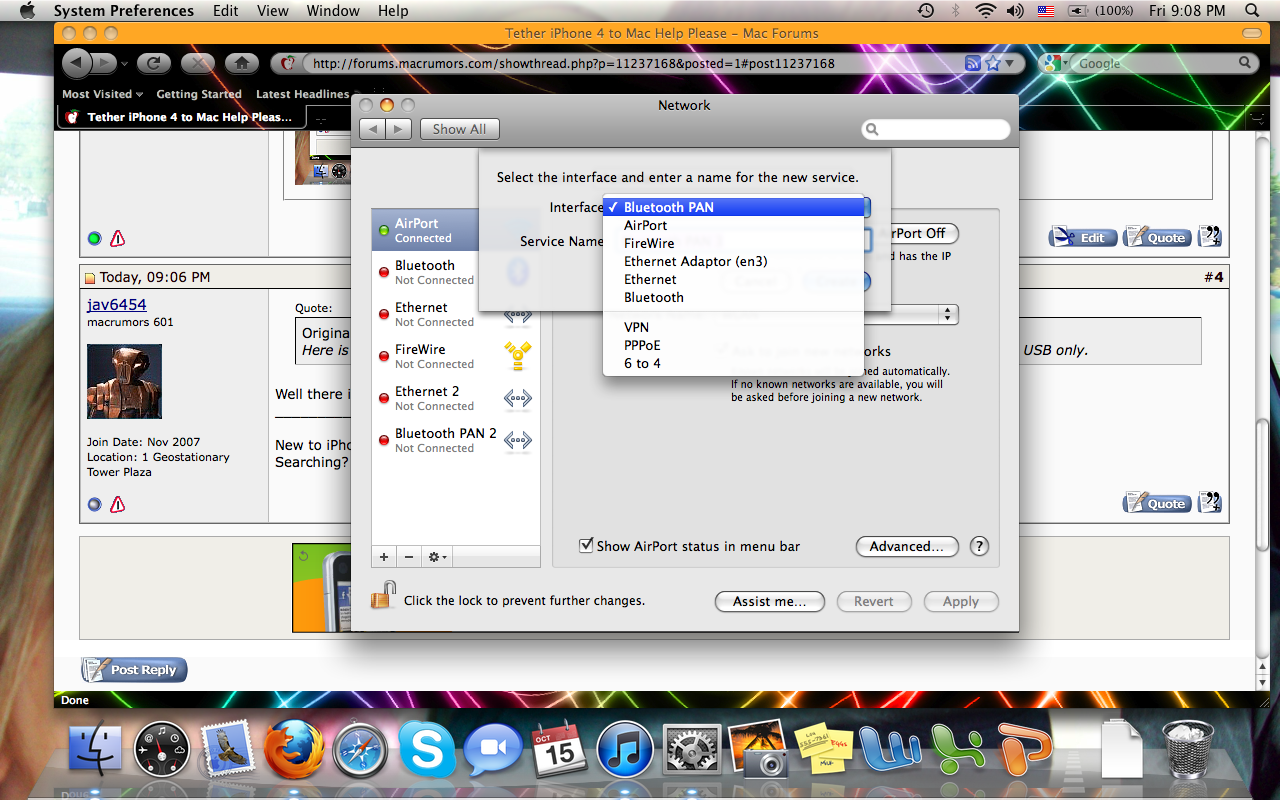

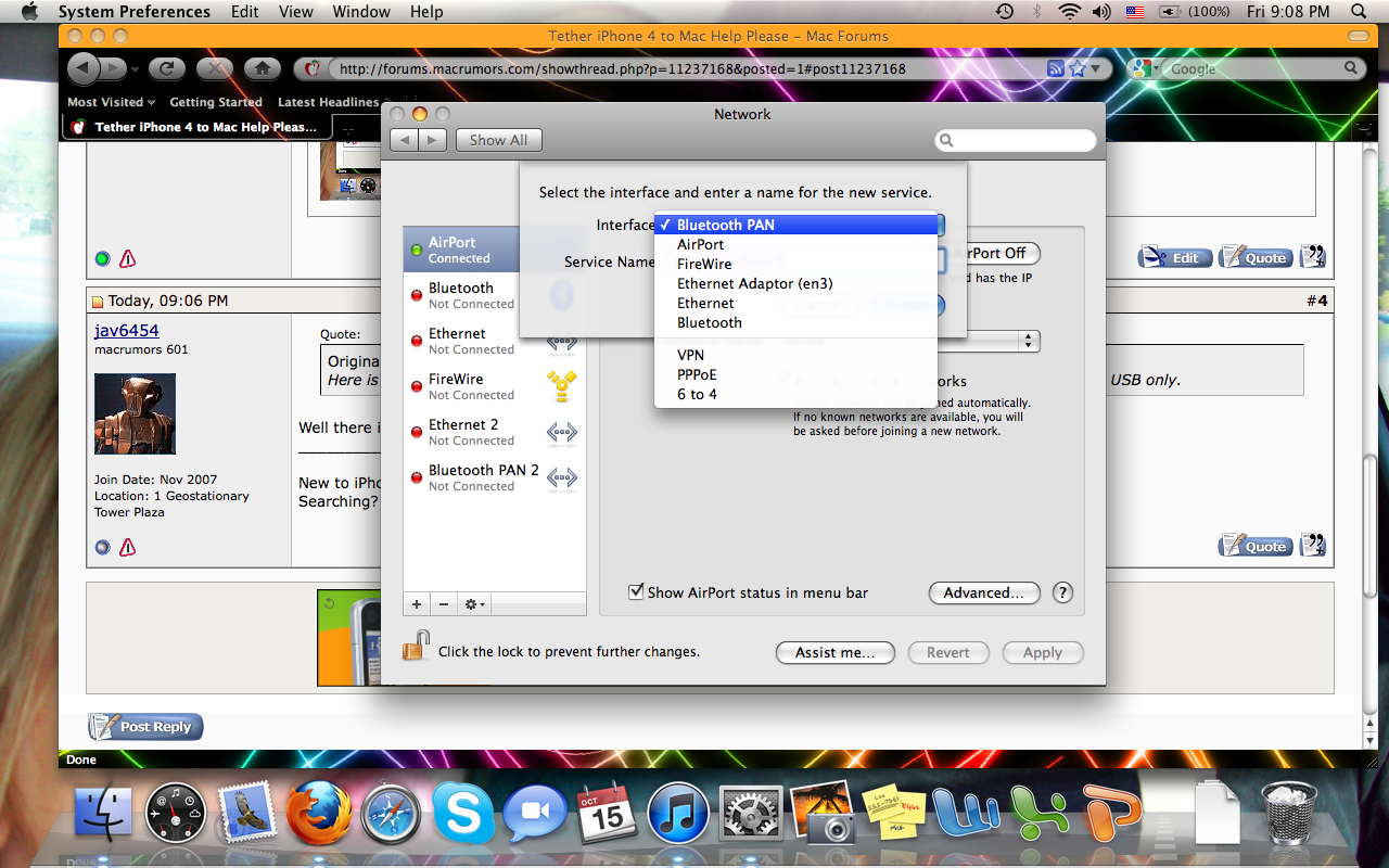

Here is another screen shot of what I can "add" for devices. I really don't know how to add a phone as a device. I've read that when tethering a Mac sees and iphone as an ethernet but I don't know if that's true.

I finally found the problem or fixed it. I created an Ethernet Adaptor (en3) and then clicked on it and clicked apply and it finally connected. Thanks everyone for the help.
