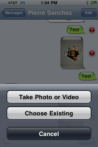

so I had to rename it Carrier Bundle.bundle
I got it to show the video or photo, but still failing 🙁 and I've tried everything...well almost Im off to the at&t store and get a media net package....

I have a 3gs and ...at least I don't have a ATT carrier whatever folder
