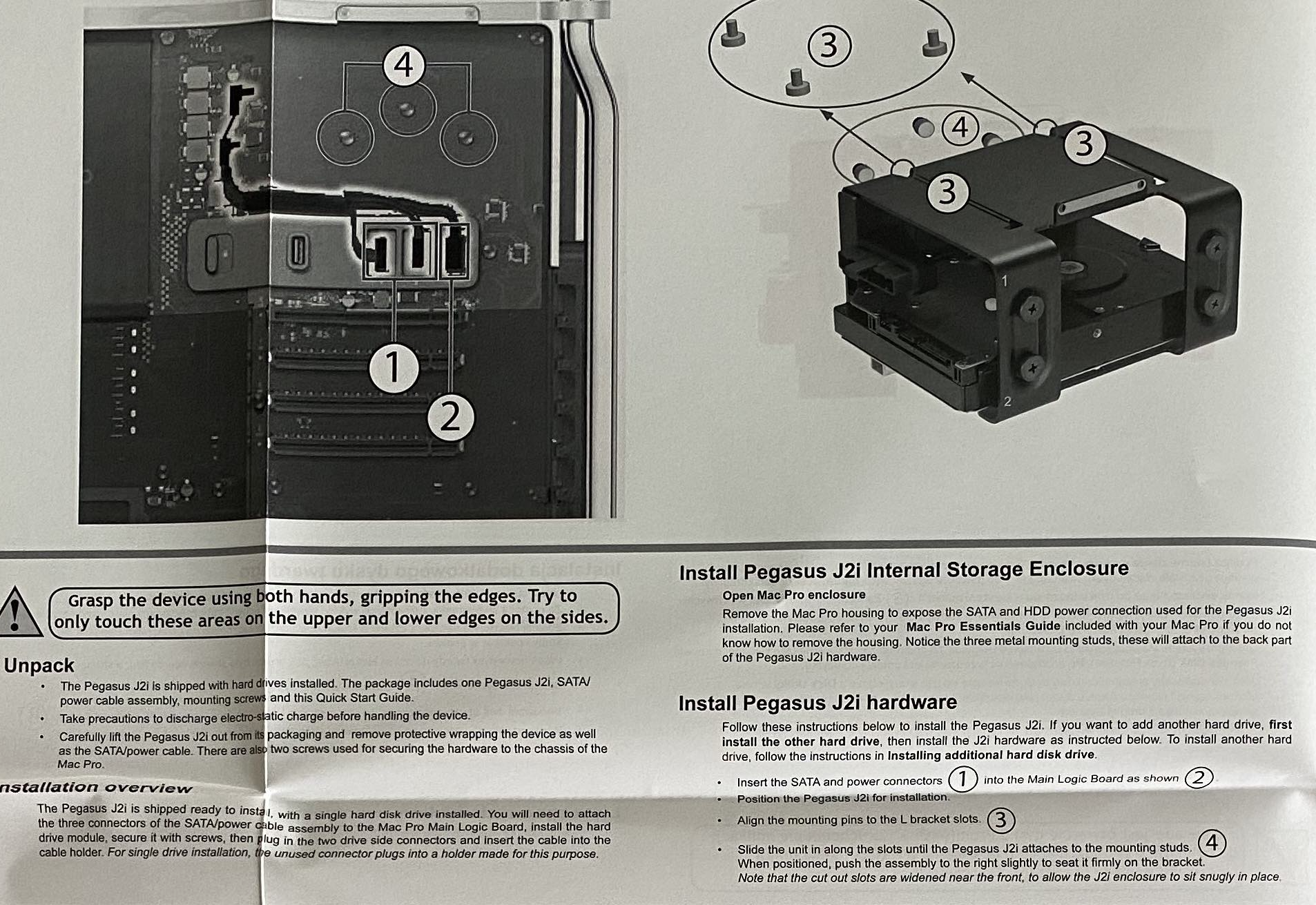

I already have 4 SSDs and a PCI Hardware RAID card with internal ports. That cage area would be perfect to mount them in. Third-party options'll probably become available in the coming year, but I'm lousy at waiting and not interested in paying the Apple premium for something as simple as this. Forcing the cage to be bundled with a hard drive is a pretty tacky cash grab!
So, I've taken a close look at the "custom" power port on the logic board and it's pretty clearly a standard 10-pin molex connector. Anyone with a multimeter and some time can easily make their own cable, which is what I plan on doing. Identify GND, 5+, 12+, wire appropriately, save $400.
Add a 3D-printed cage, some thumbscrews from McMaster for mounting tabs as demonstrated in the J2i manual, call it a day. Total price: Maybe $20!

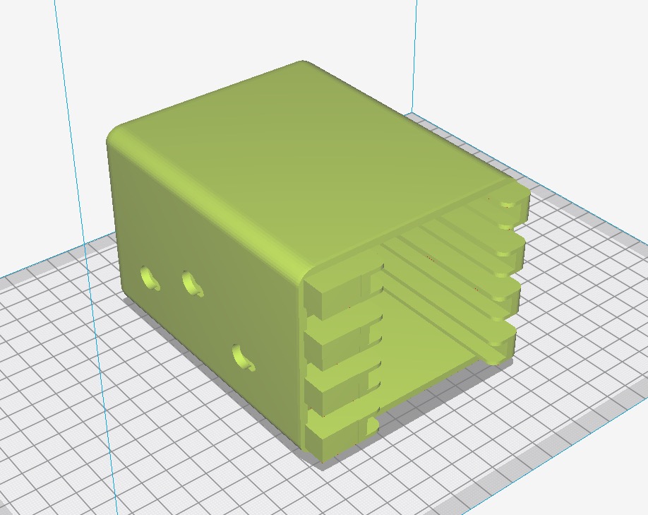

Voila. Took me an hour to whip up from the dimensions in this picture. Only for SSDs but once I get home and print it I can fine-tune it more, maybe make some full-size 3.5" removable sleds with locking clips. I'll post the pin-out of the 10-pin cable once I have my Mac Pro in my grubby hands. Merry Xmas.

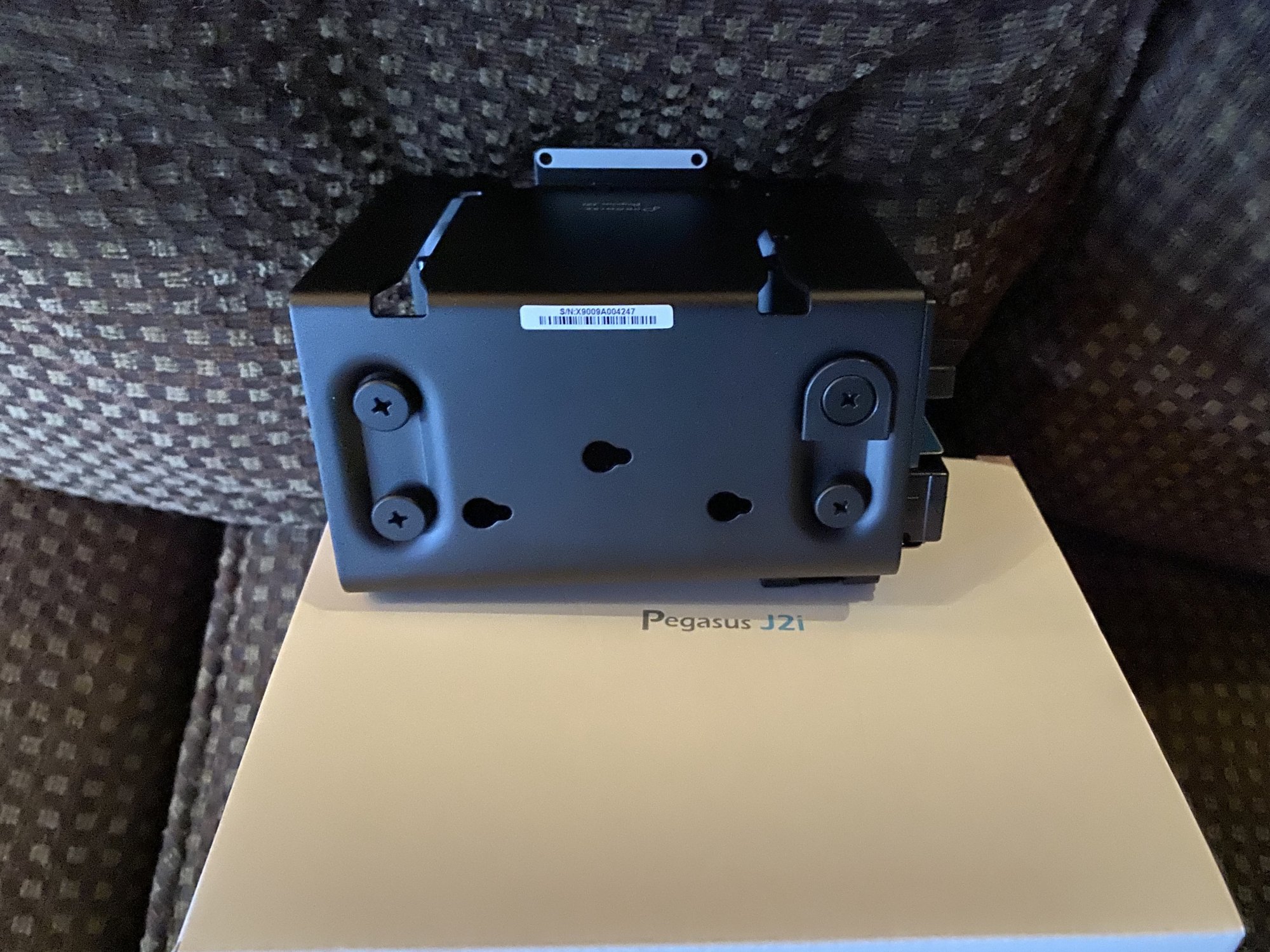

The cage to mount hard drives internally should have come standard with this new Mac Pro. $400 for a metal cage, an overpriced 8 TB surveillance spinner I don't need, and a "custom" power connector, just to use internal drives I already own? I could buy an iWatch with cellular for that!
Who's with me? Attica!
10-pin Molex connector, $0.81
Molex crimp pins (buy extra because you'll probably mess it up) $0.19
4x SATA power splitter cable, $8
I plan on buying a J2i just to model my own cage after it, then returning it. I also plan on posting the .STL of any designs I make if anyone's interested.
