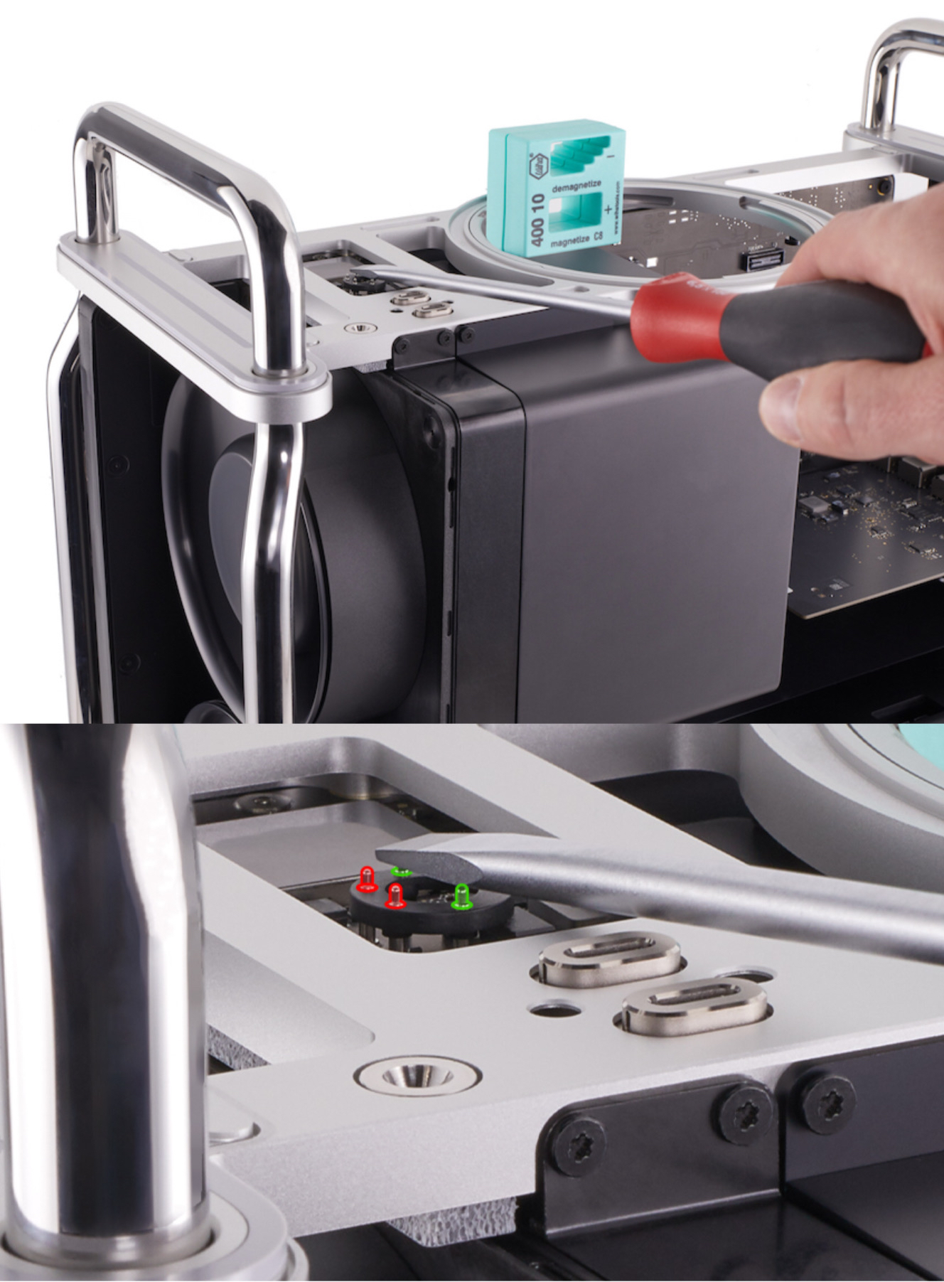

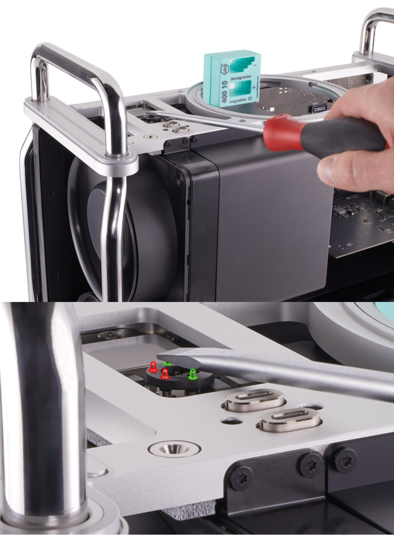

For future reference: To operate the MP7,1 without its shell, you can bypass the housing sensor with a magnet and manually short the contacts of the power button.
As described in the service manual (page 14 ff).
Apple can't guarantee proper cooling in this case that's why they recommend to remove the magnet so the fans run at full speed.

Thanks, that's a nice hack around for what is still an awful design. The cables still have to come on and off. The dust is still an issue. But at least you can test, with this absolutely insane-for-the-end-user hack.
