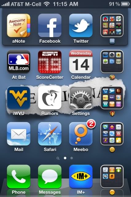

I picked up a MicroCell yesterday. Brought it home, got it all setup in a half an hour and then in an hour I received a constant signal and it has worked since.
No issues with calls echoing or any other problems. I get perfect 5 bars in all of my townhouse apartment. I am very pleased. It sucks I had to shell out $150 but for a guaranteed 5 bar constant connection for voice calls for my girlfriend and I. It's well worth it.
After reading about many problems with the MicroCell I was a bit nervous purchasing it but it comes with a 30 day return policy so saw no reason not to try it. Glad I did.
Wirelessly posted (Mozilla/5.0 (iPhone; U; CPU iPhone OS 4_0 like Mac OS X; en-us) AppleWebKit/532.9 (KHTML, like Gecko) Version/4.0.5 Mobile/8A293 Safari/6531.22.7)
I got mine yesterday, & it's working perfectly. I had some initial issues with Facebook, but then I found out the problem was on Facebook's end. I haven't had any issues with voice quality, calls dropping, texts going through, etc. Working like a charm.
I had NO service at my house until the MicroCell. I encourage everyone to pick up one & at least give it a shot.
