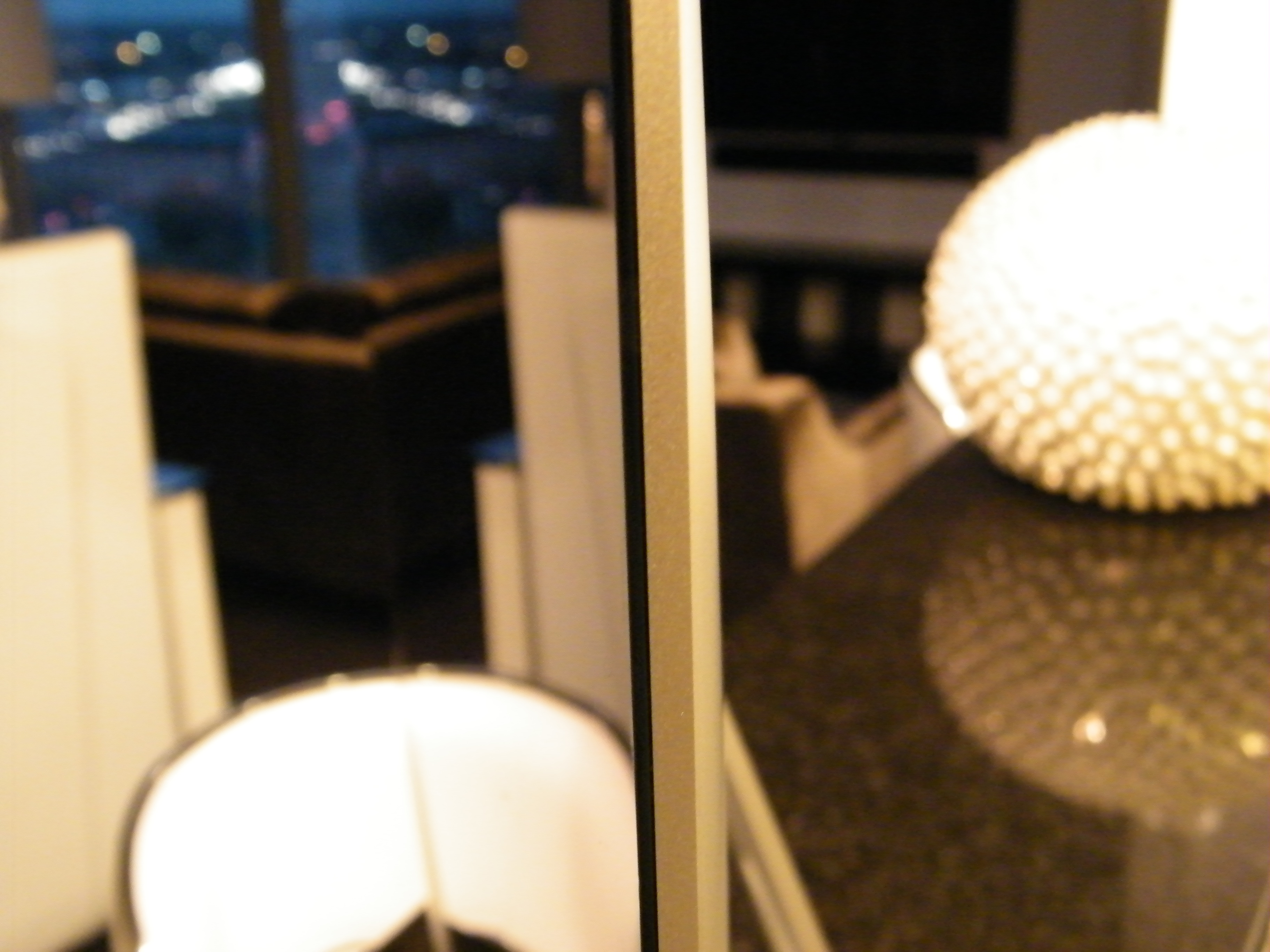

Hey guys, as a temp solution we sealed the imac up with some 3m 465 adhesive tape. Its not the same as the original tape since it leaves a little residue when removed but it also rubs off easily. We are still looking for the right tape and have some coming in at the end of the week. Im so glad i ordered a maxed out 27" or i would have been tempted to do the same. At this point i would not advise anyone to open up the 2012 imacs until someone gets a hold of the service manual which should have the part numbers for the replacement tape.
Yeah the imac looks like new, you cant tell it was opened up from the outside.

The imac is just as easy to take apart with the 465 tape but it took me over 30 minutes to clean up the residue. I replaced the 465 tape with a 3m 16mil VHB foam tape, its stronger than the 465 tape and it peels off easy just like the factory tape. It still does not look the same as the factory tape.

The only recommendation i have at this point is maximum thickness of the tape should not be more that 16mil. The 465 was only 2mil so i had to place it on the housing and the back of the lcd frame.

Amazon has several brands of 16mil 1/2" VHB tape in small quantities for from $5 to $20
That's good to know, thanks again. Where did you find your tape? From what I've only been able to find it in massive quantities online. Given the choice of spending $2000 on a bulk order of tape, or a $1300 factory SSD, I'd go for the SSD 😉
I purchased the 465 from drillspot.com several years ago. I found the 3m VHB tape from my local Grainger industrial supply store.
