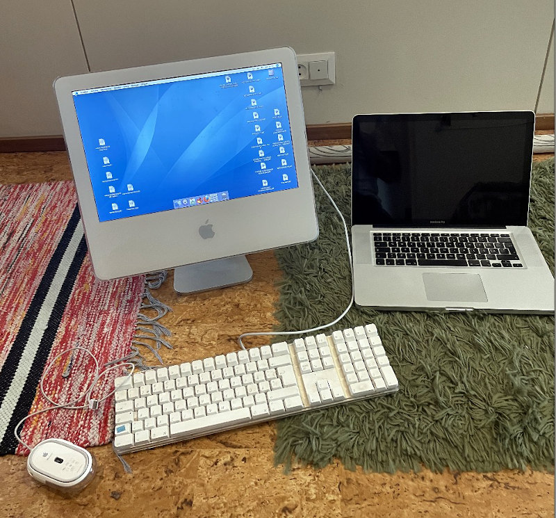

Tomorrow I will be picking up couple of old Macs from a friend. He doesn't know anything about them, they came from an old relative. He doesn't have a power cable for the MBP so he cannot even boot it.
Well, IMO the MBP looks like a unibody. I think there is an alu power button in the right rear corner...maybe. And it has a led in the front right corner, it is half visible. It seems there is something weird going on with the touchpad. Cannot even guess what year it might be. Hoping it is the one with 2 piece bottom case, 2008?
But, what about the iMac? It doesn't have a camera. Does that make it 2005 iMac G5? If yes, that would be cool as I don't have one. What screen size is that, 17"?
The iMac is definitely a G5 because the Intel models feature the iSight device. According to this thread it's specifically an early iMac G5 model.
So, the only way it doesn't have the iSight camera is if it is one of the very first iMac G5 revisions (rev. A and B of the G5).
That might be a nice acquisition in terms of its release history from a collectors angle. Be warned that the iMac G5 range were prone to capacitor failure (the one in my signature is afflicted with this) but if it's survived this long without problems then fingers crossed it should be ok. Nonetheless, when it arrives you should look over the logic board to check that they're not exhibiting signs of swelling.
The black keyboard is a give-away.
Well, yeah but Retinas also have black kbds. But, they do not have the Macbook Pro -text on the display - nor the led in the front / the power button which I think I can see - maybe. 😉
Thanks, I'll take a look. I was happy to see in some youtube-video that the G5 iMacs are easy to open so it will be one of the first things I'll do. I have loads of caps etc. in stock as I have fixed lots of vintage audio gear so I might even have all that I need if there was some that are bulged or already leaking.
So, it can be one of 3 models: 1.6 or 1.8 GHz models released in august 2004 or the "Ambient light sensor" -model from may 2005 with a 2.0 GHz G5. The last one has Airport stock, better gpu and fastest bus speed. Max RAM is 2GB (PC3200 DDR) and they can all run Leopard. 👍
The third tell is the shape of the thumb insert cut in front of the trackpad:
it is a curve (a curve derived from one-quarter of a circle) on the unibody series. It’s bit less curved and more wedge-like with the retina series. This tell is most visually (versus tactilely) evident at the left and right corners of the insert.
With unibody models, one could imagine resting a ball bearing in those corners, and the bearing (if holding the entire laptop just so) would stay put. Tilting the laptop just so could get the bearing to roll to the other end and stay there.
Retina models? Probably not, for either of these experiments.

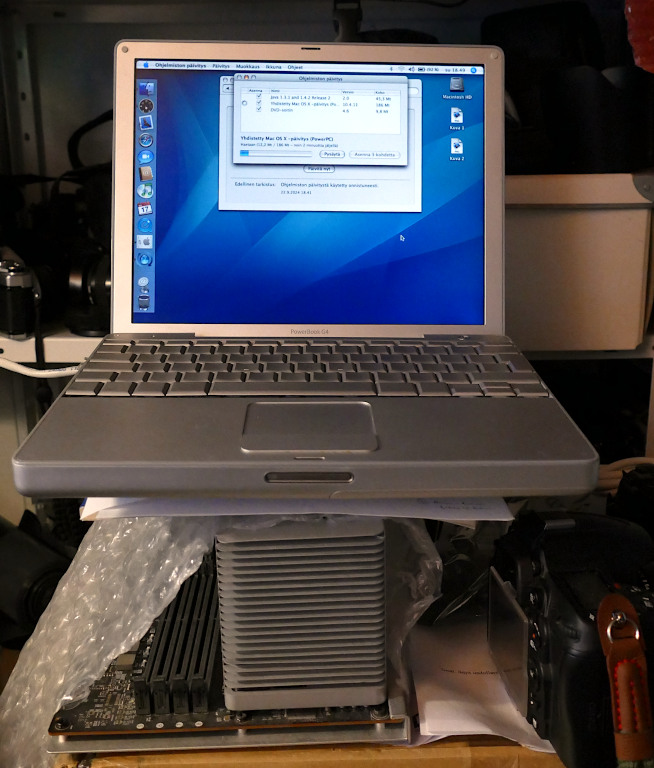

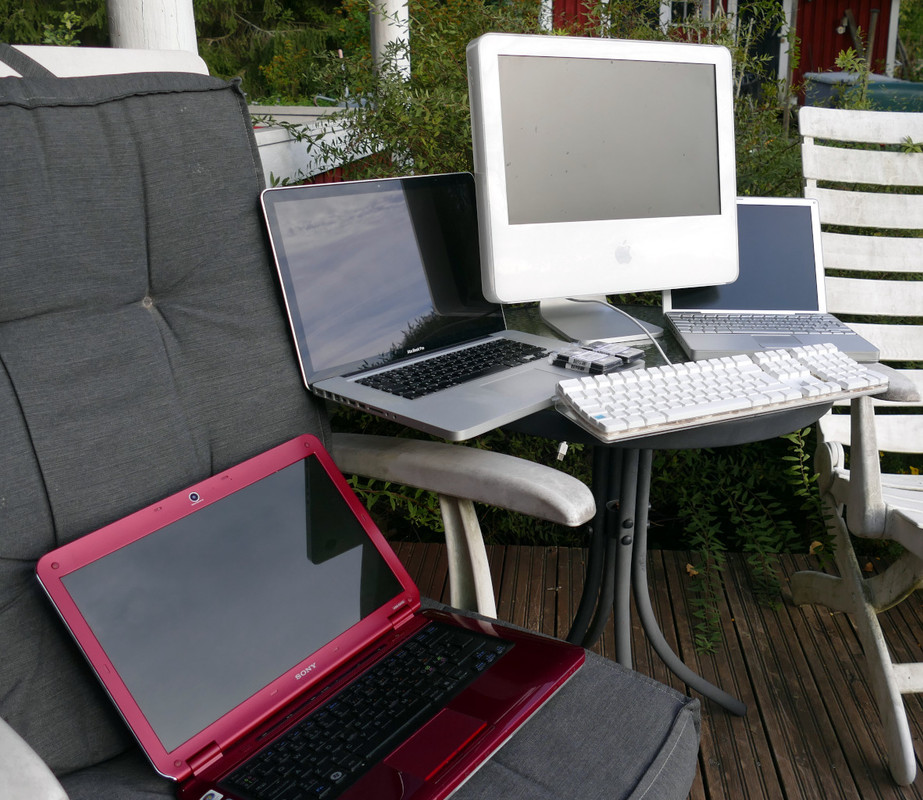

So, visited my friend. He had rummaged through his garage and found some more goodies for me. 😀😎👍
So, the set is:
- iMac G5 (PowerMac8,1) 1.8GHz, 1GB RAM, 17", no Airport.
- PowerMac G4 12" in very nice shape. Don't have details yet due password.
- MacBook Pro 15" mid 2010 i5 2.4GHz, 8GB RAM
- PSUs, keyboard, mouse, 4x2GB 1333GHz SO-DIMMs
- Sony VAIO, no details known. EDIT: Its this one. Probably from around 2006 2008. Boots to Windows 7 but is also password protected. I guess I need to reset the pw somehow. I guess this could be a decent machine to run a light CNC-software but not much more. EDIT2: it has a Blu-ray -drive! 😳
He also had a PowerBook G4 15" but needs first to get his pics out of it but offered it also to me later on. 😁
So, I wiped the drives on the Macs already and started new OS installation (PM G4: 10.4, G5: 10.5 and MBP: 10.11). Once they are done I will figure out what shall I do and if I will install SSD's to some of them. MBP for sure but not sure yet about the others.

My goodness… those systems are relaxing on the veranda and watching the geese fly by.
They are living a very hard life.

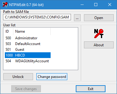

Download the ISO for the Hiren's BootCD and decide whether you want to burn it to a CD or a create a bootable USB stick. Once it boots, follow these instructions for a stress removal or reset of the password:
  • Boot your computer with Hiren's BootCD PE.
  • Goto Start Menu -> Security -> Passwords -> NT Password Edit
  • Open your SAM file (It is usually located in C:\Windows\System32\config\SAM).
  • Click your username and the click 'Change password'. To set a password, type your password both 'New password' and 'Verify' fields and then click to 'OK'. To remove the password, leave both 'New password' and 'Verify' fields blank and then click to 'OK'.
There's another password reset/removal program on the CD but NTPWEdit is better and works all the way up to Windows 11 - as I can attest from personal experience. Congratulations on a great haul and I hope that you have fun with those new toys. 🙂
Reactions: Amethyst1
Hah, thanks for the tip. 👍 I should have that already but had totally forgotten about it. I used it once with some other machine few of years ago. Now I just need to find the disk I burned back then - and follow your instructions.

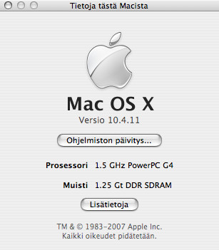

Now I know more about the MB G4 12". It is the 1.5GHz version with 1.25GB RAM! 😀 Out of the box the OS 10.4 only supported WEP but with ethernet I was able to update to 10.4.11 and now have proper access to wifi!
