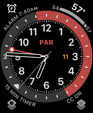

tldr; inner dial is always 12-hour time; outer dial and red hand is always 24-hour time for a second time zone; colors indicate sunrise/sunset for second time zone (in 24-hour time)
Here are my observations on how I think the GMT watch face works:
  1. The inner dial is a standard 12 hour clock for the current time zone (set on your iPhone)
  2. The red hand is a 24 hour clock for the current time zone. It will do one full rotation in 24 hours, using the 1/2 notches in the outer dial.
  3. The number next to the red hand is the hour in the second time zone which you can set by tapping once on the watch face while active
  4. The triangle in the outer dial is also in a 24-hour scale, and is supposed to indicate how many hours ahead or behind the current time is from the second time zone. I observed that if the second timezone is 1 hour ahead of current time, the triangle will be at the 23/24 hour mark. If the second timezone is 1 hour behind, the triangle will be at the 1/24 hour mark (between the 12 and 1). If the second time zone is set the same as the current time zone, the triangle will stay at 0/24 (12 o' clock). This is confusing to me because when the second time zone is ahead, the triangle will move back.
  5. The color dial indicates sunrise and sunset in 24-hour time for the second time zone. I'm not used to reading a 24-hour clock, so this can sometimes be hard to read. Right now half of the Pepsi dial is between 3 and 4 (0700 hours) and the other half is between 9 and 10 (1900 hours). When the red hand reaches the separators between your two selected colors, it will either be sunrise or sunset in the second time zone.

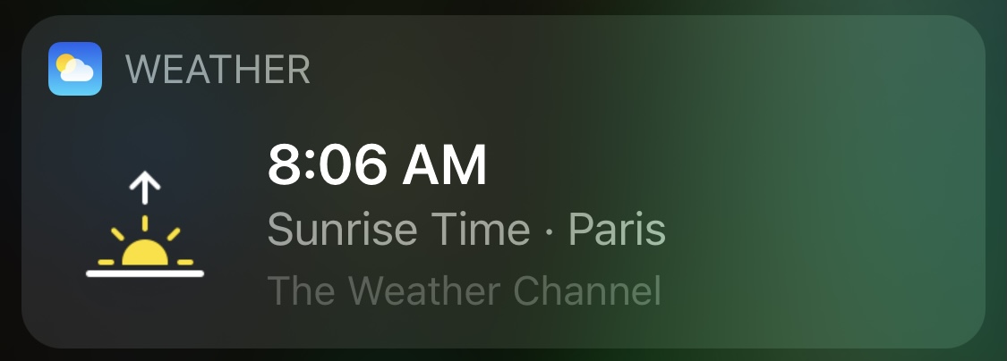

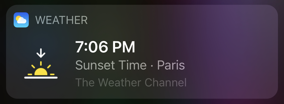

So the color border keeps shifting twice a day because daylight is not 12 hours all year long...
My watch is set for 24 hour time and present location for second time zone which allows me to see the military time hours, which I like. My problem is that the sunrise and sunset remain at 12 hour intervals, and do not change with actual conditions. Am I missing a setting, or how does this work as Day length changes?

Yeah, why does the triangle move back when the second time zone (or reference time zone) is ahead??
Because the time is clockwise from 1 to 24 hours so when the triangle rotate counter clockwise the time is increased, meaning the bigger number will come to the red hand instead of the smaller one. Make sense?
Sorry, no. Could you state in another way? Who knew analog could be so complex . . .
You have a circular and the number run from 1 to 24 “clockwise”, like a watch. You want the number on red triangle to increase, which way you will rotate the circle? Clockwise or counter clockwise?
The correct answer will be counter clockwise, not clockwise. That’s why you rotate counter clockwise for the time ahead. To increase the time. It has nothing to do with forward or backward but increase or decrease time.

Why does the bezel keep rotating?
The red hand is moving anyway. On real GMT watch the bezel stays put, right?
It's so that when it is midnight in the second time zone, the red hand will be on the triangle.
The bezel does not rotate unless you are changing timezones. The bezel WILL adjust based on sunrise/sunset for the second timezone, but day-to-day you will not see much difference. There will be a bigger difference season to season.

I think Apple fixed the "current location" bug with the latest update so that sunrise/sunset is now accurate.
