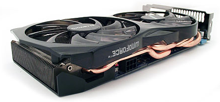

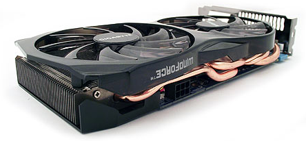

I installed my new SSD in the empty optical bay and ordered a GTX 660 from gigabyte. The card will arrive on monday. I also bought 2 6pin power cables. Do I need to connect both?
Bye
^^^^I went to the Gigabyte WebSite and for this device:
GV-N660OC-3GD
The answer is YES!
See attached.
Lou
GV-N660OC-3GD
The answer is YES!
See attached.
Lou

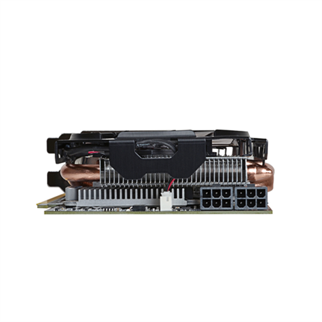

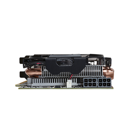

Hi lou, the card is in my hands but there seems to be just one power port...
Do you think that my mac 3,1 and one power cable will be enought??
