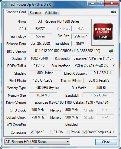

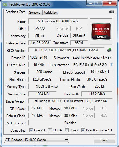

I have two HD4870 1GB Card and i will flash it.
1.Sahpire HD4870 1GB Vapor-X
2.Radeon HD4870 1GB
For the Radeon HD4870 1GB , i used Zeus , but there are a Script Error and for the Vapor-X 1GB , it means , that i must be flash it manually.Please help.How i can flash the HD4870 Cards.
