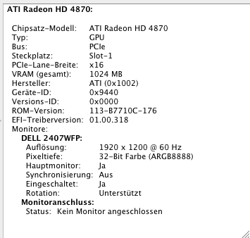

ok. the problem does not longner exist.
I flashed my 4870 with a PC and it works!
you can find the mac modified ROM (HD4870 Vapor) in the attachment.
  • 4870-vapor.rom.zip
    4870-vapor.rom.zip
