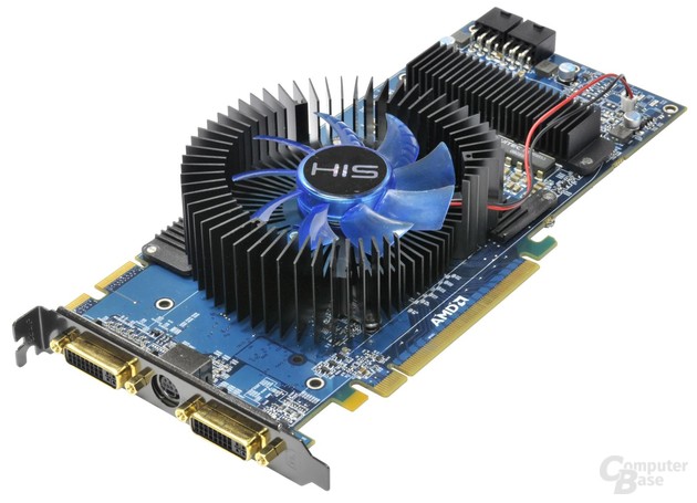

Cindori this card also works without any problems:
I use it since a year.
It's HIS Radeon HD4870 512 MB RAM. No need to use patches. Works great under Leopard and Snow Leopard (Tiger also, but without acceleration).
Check my posts I've posted ROM to this card in Ultimate HD4870 thread.
