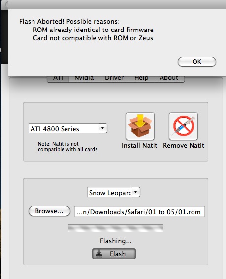

Problem flashing a Sapphire New Edition
I got the right (I think) Sapphire 4890 New Edition with Qimonda chips:
Part Number: 288-1E115-D20SA
SKU: On the card: 11150-11. Oddly, on the box it's written 11150-11-20R
I put it in my Mac Pro 1,1 in slot 1 and backed up the Rom in Windows with GPU-Z (.bin file attached)
With the Mac off, I moved it to slot 2, with my ageing (and dying) X1900XT in slot 1
I got the ROM number 1, according to the ROM table gathered by Peloche, and attempted to flash it with Zeus, but got the following message:
Flashing aborted
ROM identical to card
Card not compatible with ROM or Zeus
Any ideas about what it could be? I thought this card was one of the more widely used, so Zeus is certainly compatible with it, right?
Also, on a separate issue, how do I have to power the cards during the flashing process? 1 cable to each? Only to the X1900XT?
Flashing aborted
I just tried Winflash, and it says it cannot erase my ROM.
Here's a screenshot of the message I get on Zeus with the X1900XT in slot 1 and the 4890 in slot 2.
