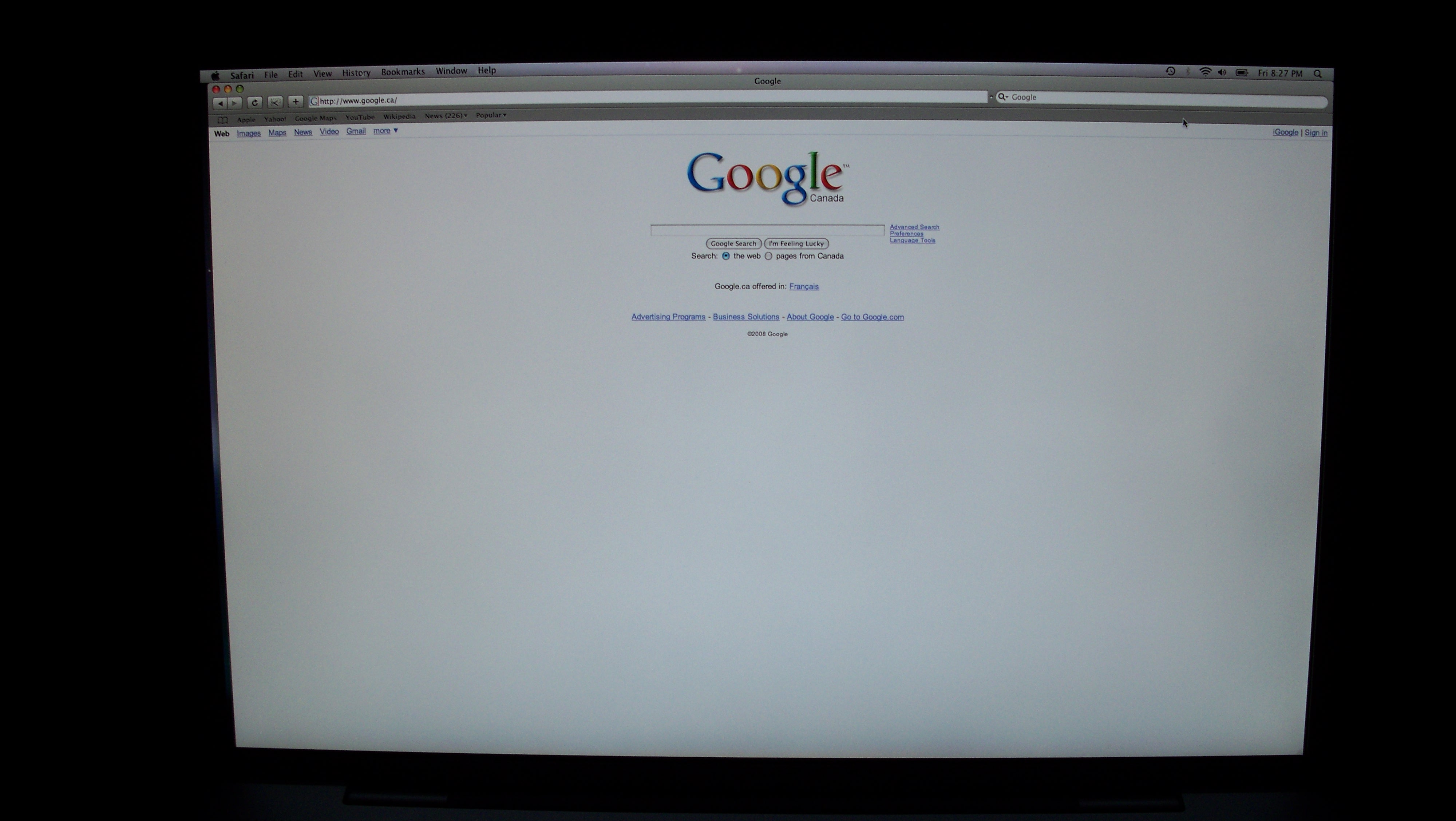

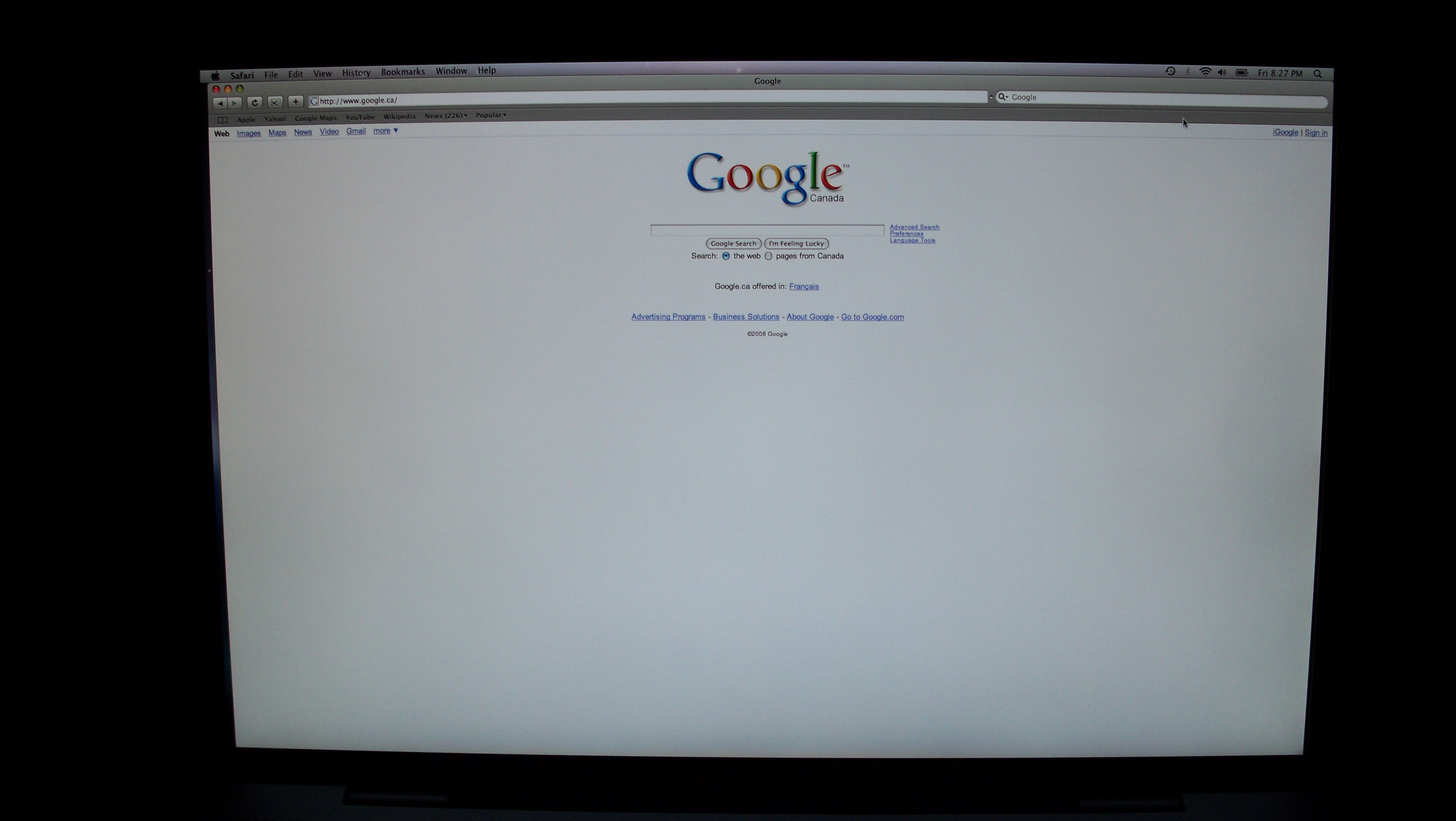

As for my screen, I did the google test and I don't think there's much yellowing at all. I noticed the colour shifted towards yellow near the bottom, especially near the corners (had to really look for it), but it wasn't anywhere close to some of the pictures that I saw online.
