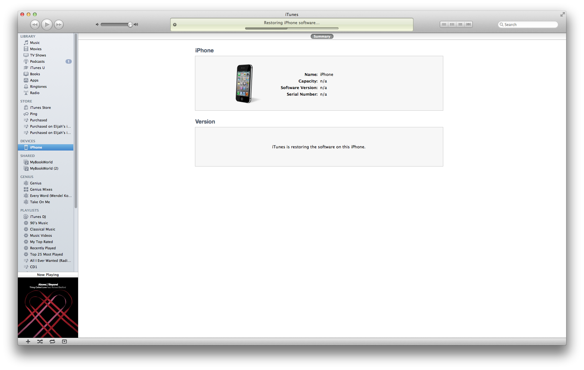

Ok, my iPod worked, finally. I feel much better now. Hopefully I won't have any issues updating my iPad and iPhone.
