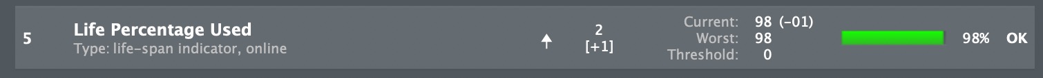

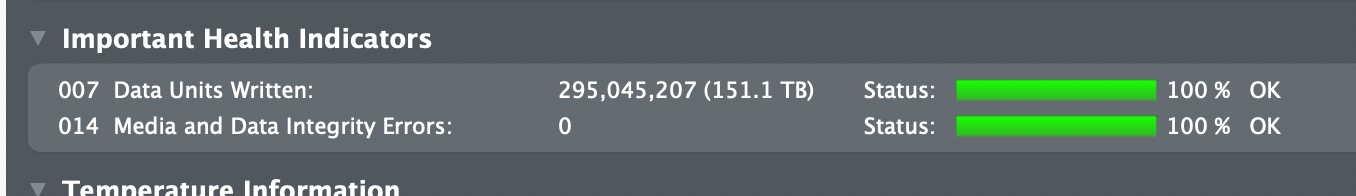

I have a 4TB SSD on my M1 MBP and I have 151.1TB writes and 98% health according to DriveDX.
To address your post - I think most consumer grade cheap SSDs would expect a 150-300 TBW for a 256 GB SSD. Based on tests done (I can't remember the links) - realistically, especially the name brand ones (Samsung Pro), can see 1000+ TBW. For Apple SSDs I would expect 1000-1500 TBW for a 256GB - which DriveDX's health indicator (based off of Apple reported system values) seems to indicate.
So using math (which I suck at) - you have 1444 TBW estimated lifespan based on that health value.
My Mac has 7500 TBW based on my health value. (4TB vs 256GB)

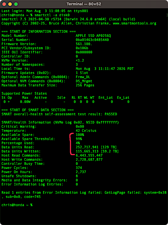

The original monster thread on this topic is too big to be useful now but it includes many factual nuggets... such as:
1. The percentage usage reported by third party tools Drive DX and SmartMontools, has also been discovered deep the Apple own diagnostic data available from Console. See this post and the ones before and after it.
2. There are data points reported by extremely high usage machines which support that Apple SSD life really isn't in the too-good-to-be-true category, and that this really isn't an issue. The high usage one I saw there was 1.15 petabytes TBW, that's 1,150 TB and only 36% SSD life used. (link).
Because I was concerned originally I followed that thread for a long time and monitored my own machines, but have long since relaxed about it.
