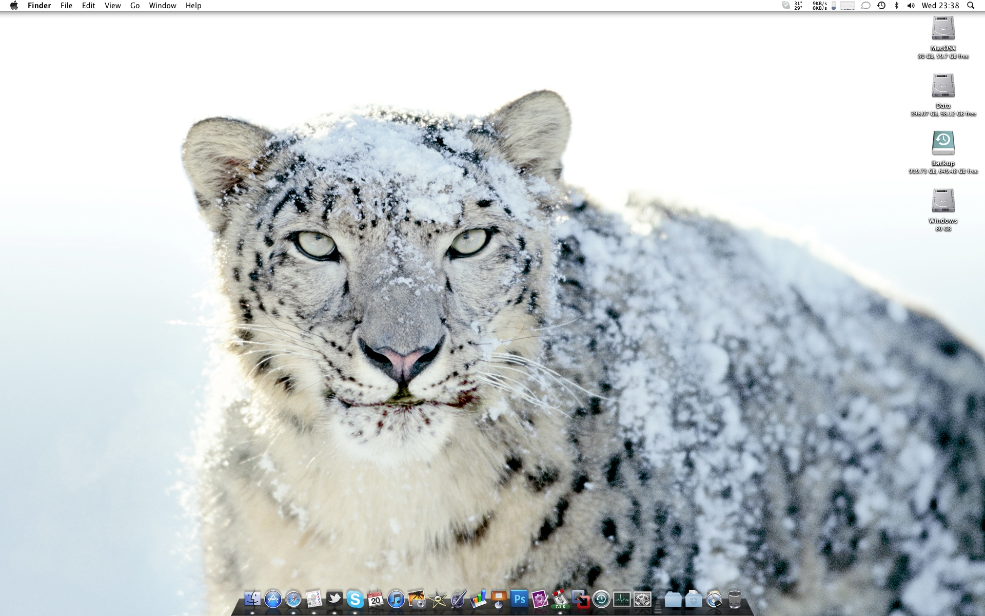

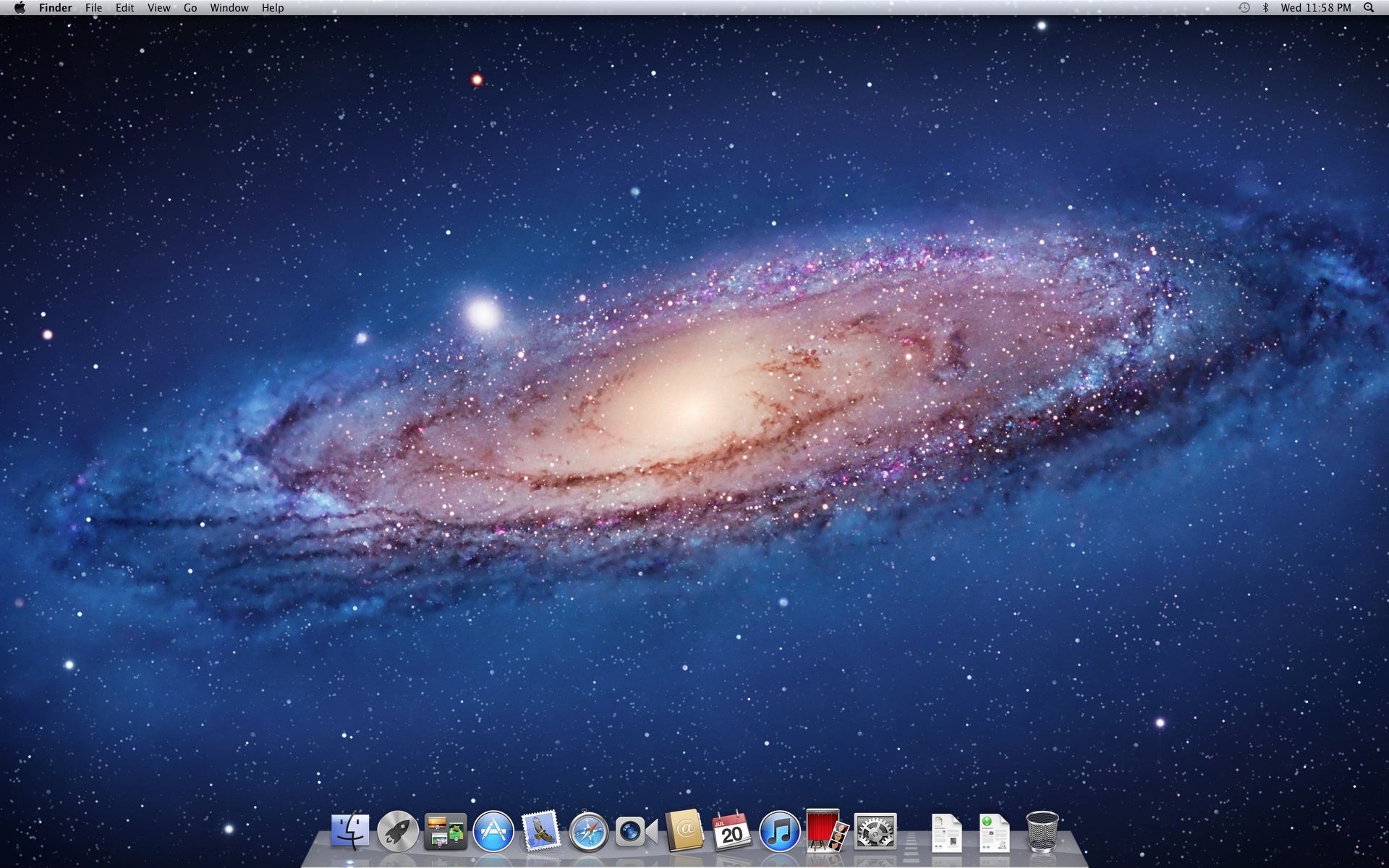

Goodbye Snow Leopard, hello Lion 😀
Screen shot 2011-07-20 at 11.38.31 .jpg Screen Shot 2011-07-20 at 11.58.49 PM.jpg
Actually installed the GM successfully on my hack just after it came out, but waited on confirmation that it's the same build no. as the release version before I replaced Snow Leopard.
I made a bootable Lion installer using this guide (Step 2) but used netkas' Lion boot file instead of iBoot and my Extra folder from my Snow Leopard install with "-usecache" boot plist flag added.
To make sound work with my 889a I had to rollback AppleHDA to 10.6.7 or earlier and to get sleep working I had to apply this patch to the AppleRTC kext.
