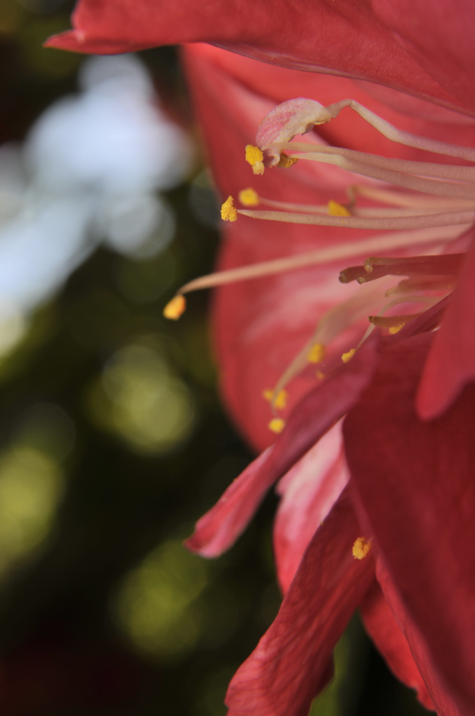

I'll start by posting a couple of shots I took just now with my reversing ring which came in the post today. I reversed an old 50mm f1.8 onto my D40, and these are the results of my first effort. Hopefully with a few pointers I will be able to improve.
I thought I would be ok shooting at ISO 800 but actually alot of my shots were pretty noisy when I got them onto the computer.
Also another problem I had was trying to get my subject in focus - I read somewhere to set focus to infinity and then move in and out to get it right, but it's difficult to judge through the viewfinder. My next purchase is a tri-pod which hopefully will help, these shots were taken hand held with no flash.

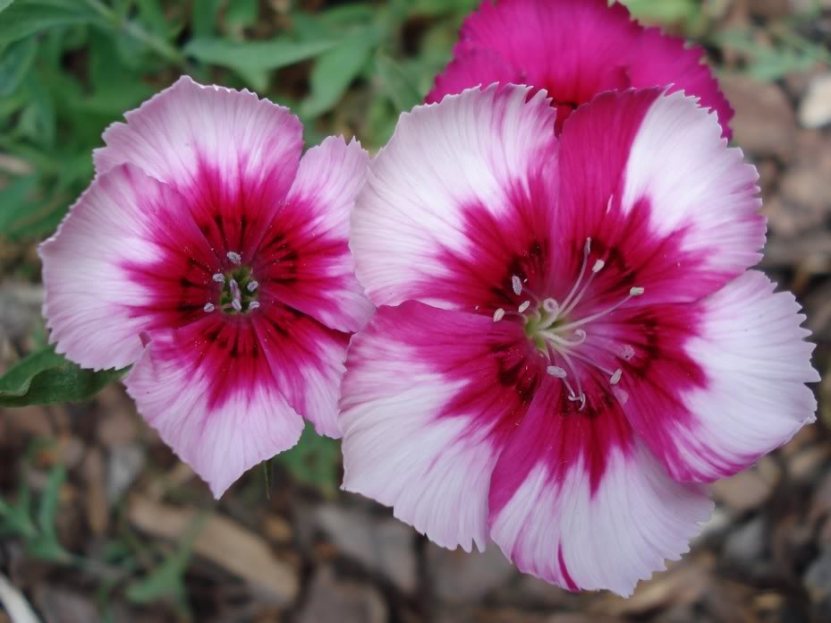

I don't actually have a reversing ring. I just hold the two lenses together. I use a 50mm f/1.8 and a 100mm f/2.8 usually...
Some examples:
All taken over the winter. Spring shots coming soon! 😛

Thank you very much! For the laces, I just happened to be in a room with office type lighting (harsh overhead, bright white lights?). I just adjusted the white balance. As for shudder speeds, I don't think I ever dipped below 1/20 of a second...
wheelhot:
for the eye shot, I had the 100mm on the camera, and the 50mm reversed. The other two had the 50mm on the camera, and the 100mm reversed. This caused quite a bit of vignetting, but I kind of like the effect in this situation. 🙂

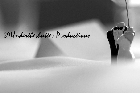

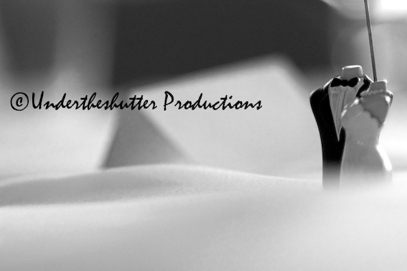

I tried a shot today reversing my 50mm 1.8 onto my 55-200mm. The DoF is so freaking shallow it's unbelievable. I had trouble getting what I wanted, and the penny was only about 1" (if that) from the back end of the 50mm.
