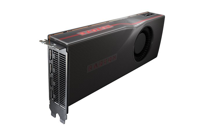

The Vega II has an 'older' raster and display subsystem. It is likely bandwidth inside the GPU chip itself and not the MPX modules or external connections that are the issue. I suspect that the Vega II could drive 3 6k display; just not very well (passible if just putting static 2D images on the screen). And for the money Apple is asking for the Vega II they don't want them 'stumbling' with XDR (which also cost a boatload of money), so they are cutting it off on the 'good performance' range.
Navi ( and hence the W5700X ) brings some changes to the internal bandwidth between the subsystems in the AMD GPUs.
"...Finally, AMD has partially updated their display controller. I say “partially” because while it’s technically an update, they aren’t bringing much new to the table ...
..The one notable change here is support for DisplayPort 1.4 Display Stream Compression. DSC, as implied by the name, compresses the image going out to the monitor to reduce the amount of bandwidth needed. .."
But there needs to be more internal bandwidth get the data to the compressor before there can be less data coming out of the chip. So even if don't turn the compressor on there is just more bandwidth internally between major buffers/"memory stores".
Thanks for this explanation, it is really helpful. I was also surprised to see that a Vega duo would not be able to handle 3 XDR displays! It seems two separate Vega II scan handle it easily due to more pcie connections being used.
