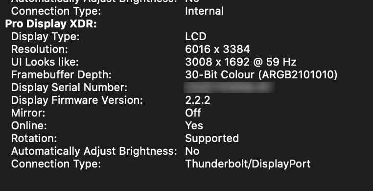

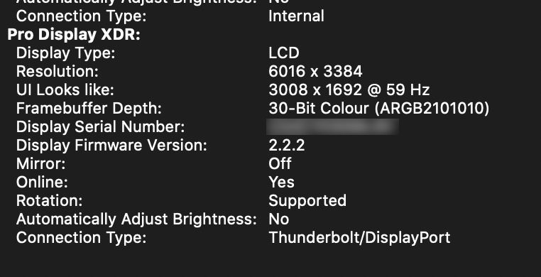

Try going to the System Report and seeing what firmware it says your displays is on. About This Mac -> System Report -> Graphics/Displays. It sounds like a bad firmware load?
Indeed it does, but the firmware is the latest version (2.2.2). I wonder if there is a way to reset the monitor to factory settings or something like that?

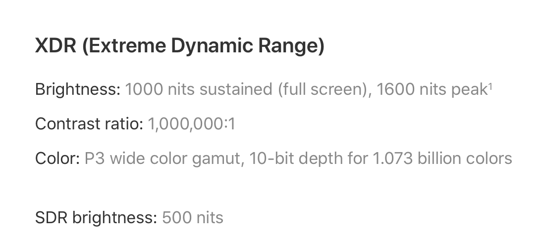

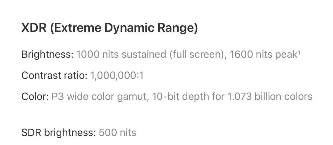

it's 1000 nits sustained with the P3-1600 profile. it's on the website and documentation.
Extreme Dynamic Range. Extreme Dynamic Range (XDR) takes brightness and contrast to the extreme, surpassing what is considered standard dynamic range (SDR) and high dynamic range (HDR).
1000 nits of brightness. Pro Display XDR can sustain 1000 nits of brightness across the full screen. This means that a pro can edit an HDR photograph or video with the entire frame at 1000 nits of brightness, indefinitely. It also has a peak brightness of 1600 nits.
Poster is saying SDR is limited to 500 maximum. Your image says SDR - 500 nits which is what is argued.
Yet, Apple website says any image can be at 1000 nits of brightness.
