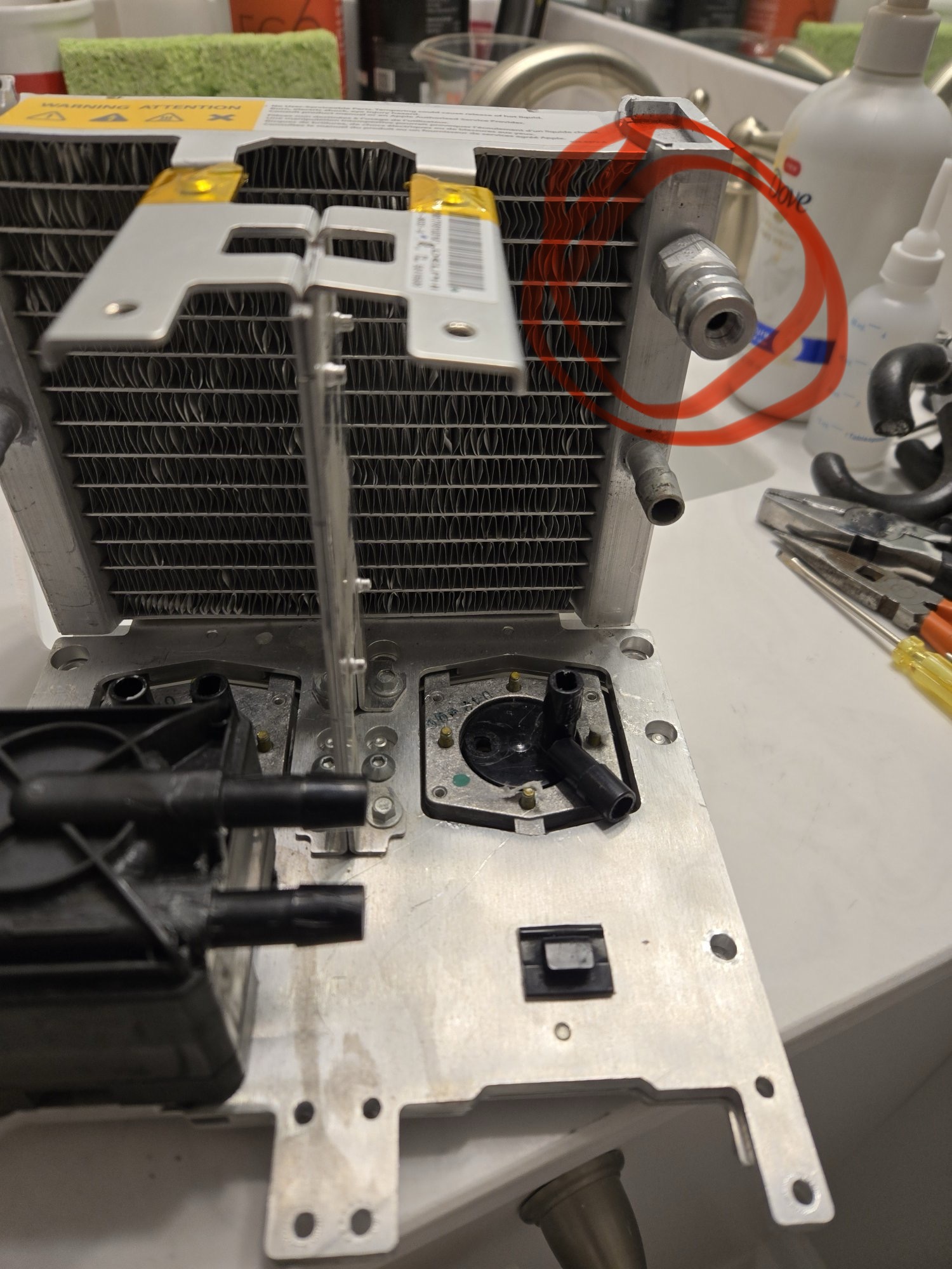

Perhaps, just perhaps, the leak is actually at the pump intake or output hoses/barbs, not the pump itself. If this were the case, the leaking fluid would drip down the side of the pump and appear to be coming from the pump housing. That is my fond hope.
Sure enough, that was exactly what was happening!
I extracted the LCS and examined the pump area carefully. There were dried streaks underneath the intake and output hoses/barbs. This seemed to confirm my suspicion, so I opened up the fill/bleed line and forced some more coolant in (I needed to do this anyway - there has been some loss to the leak). Immediately after forcing more coolant in under pressure, here is what I saw when I looked closely at the pump housing right underneath those hoses/barbs:
BOTH lines were leaking! I was able to tighten the clamps on both lines a little more - I have been "gun shy" about tightening them too much, since the barb underneath is plastic. Too much pressure might crack it.
However, with a little more careful tightening, both leaks stopped. I am now taking a few hours to slowly add some more coolant to the loop to replace whatever has been lost (the exact amount needed is pure guesswork - I really have no measure of what was lost).

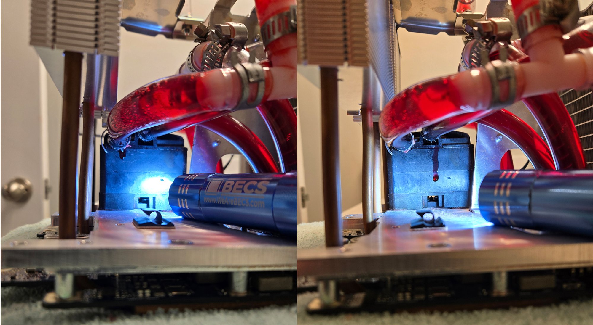

Sure enough, this latest leak was from the pump housing. I found it and sealed it with silicone sealant.
I then retested, and there is still a very small leak from the pump housing, but it only occurs during Thermal Calibration, which really flogs the pump hard. During routine operation, there is no leakage. Remember, I use bright red coolant and I put a clean piece of white paper towel under the LCS when the system is running, so that if anything leaks I will be able to spot it right away. I can therefore say with confidence that it runs leak-free normally, but leaks a small amount during Thermal Calibration.

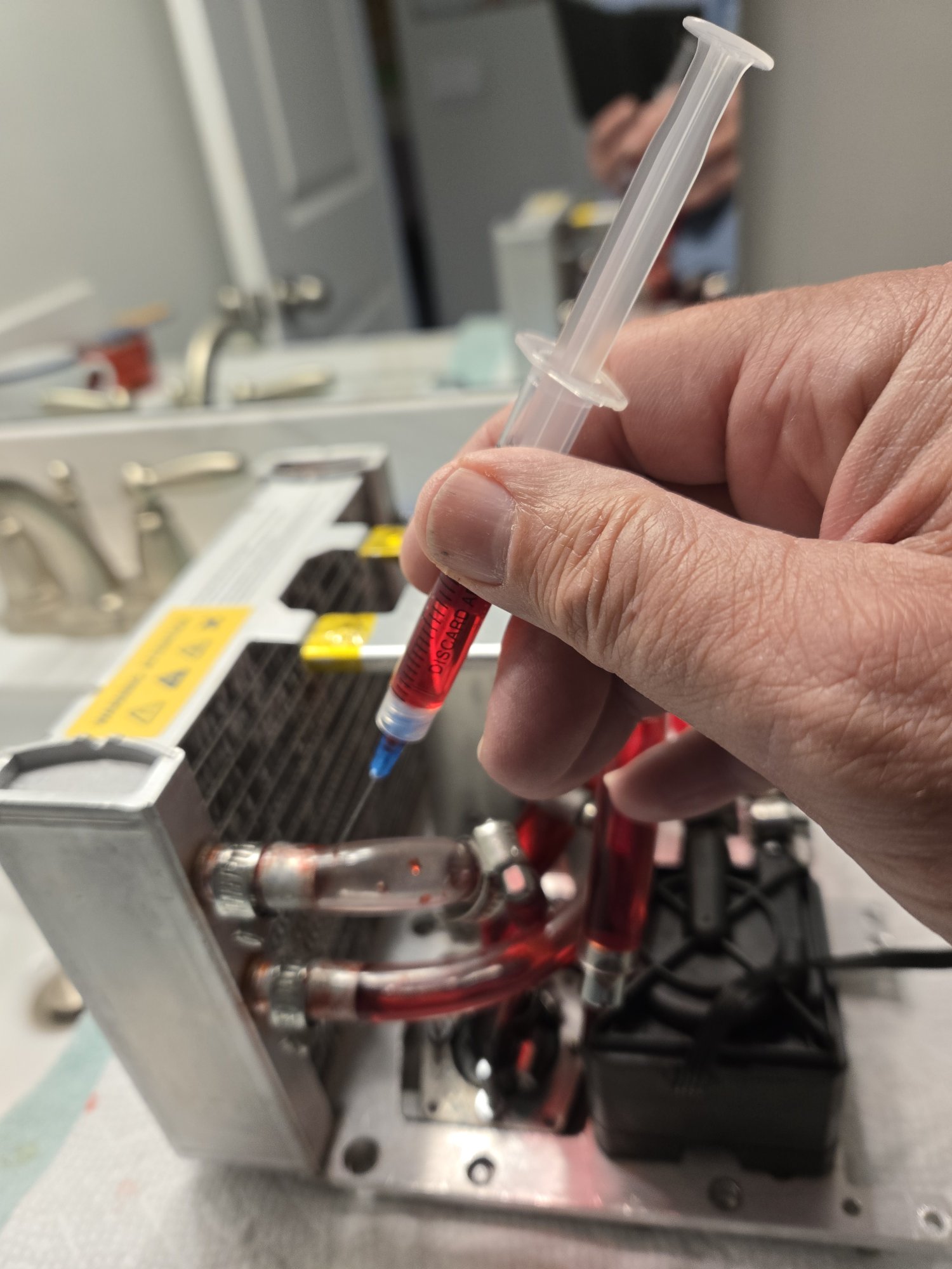

I have come up with a novel idea for getting more coolant into the loop without opening the loop back up. It is an odd enough idea that I will hold it for now and report it and it's results together, in the next few days - stay tuned!
I tried out said "novel idea" yesterday and it works well. What is it? It is a mechanism for getting rid of those last few air bubble/pockets in the loop, or viewed alternately, adding that last little bit of coolant to the loop.
.... and the idea is ... [drum roll please!] ... using a hypodermic needle/syringe to poke two pin prick holes in the hosing. I then add more coolant via the syringe inserted into the second hole while the air the coolant is displacing is is expelled through the first hole.
These syringes are available on Amazon as a four pack for less than $US 5.00.
In the photo above, I am using the needle to poke the first hole (the air exit). I then repeated with the second hole (coolant injection) and then used the loaded syringe to pump in the coolant it holds. I then sealed up both holes with silicone sealant, waited one hour and I was ready to go (it sets it in about 30 minutes, so I give it twice as long, just to be sure).

There’s an R-134a AC fitting which is used for the factory fill and bleed. While it’s possible that they have have performed a vacuum fill (drawing a vacuum then pumping in coolant with little need to bleed), with the right hoses and tools, that’s what this fitting is for.
Thanks @Eriamjh1138@DAN, but short of a "how to" guide showing what to do with that port, I have no idea how to use it and have stayed away from it. My guess is the factory did a vacuum fill... makes the most sense.
I don’t either, but it’s basically like any shrader valve. For AC lines, the mate with hoses depresses the valve stem pin opening it.

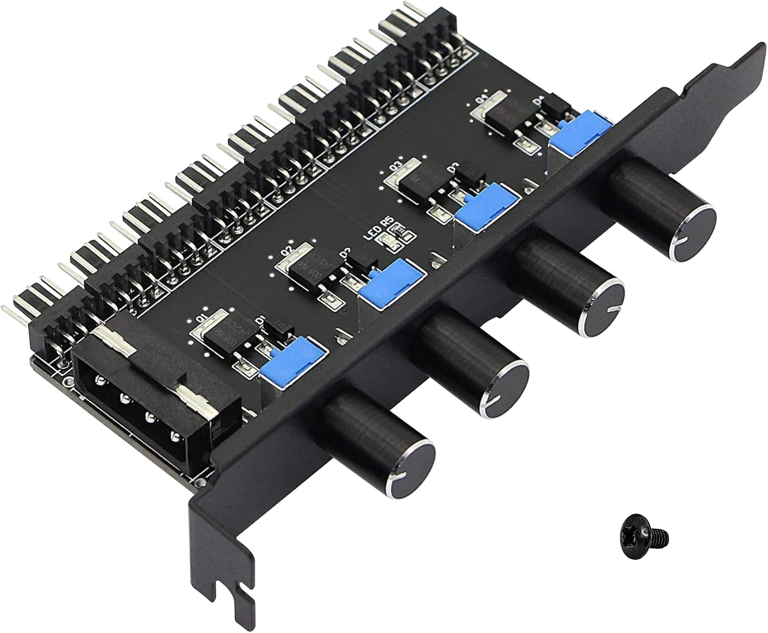

As the final act in this play, I am planning to replace the stock Apple CPU fans with uber-quiet ones AND run them through the manual fan speed control piece that I found while working on Air Cooling a Quad:
I will power this beast directly from a MOLEX, sourced from the DVD/CD drive area, and run all four stock CPU intake and exit fans through this device instead of Apple's fan headers and thermal control software. The result SHOULD be fans whose speed I can manually control, and at the same time, uber-quiet fans. A cool, quiet Quad... the objective all along!
