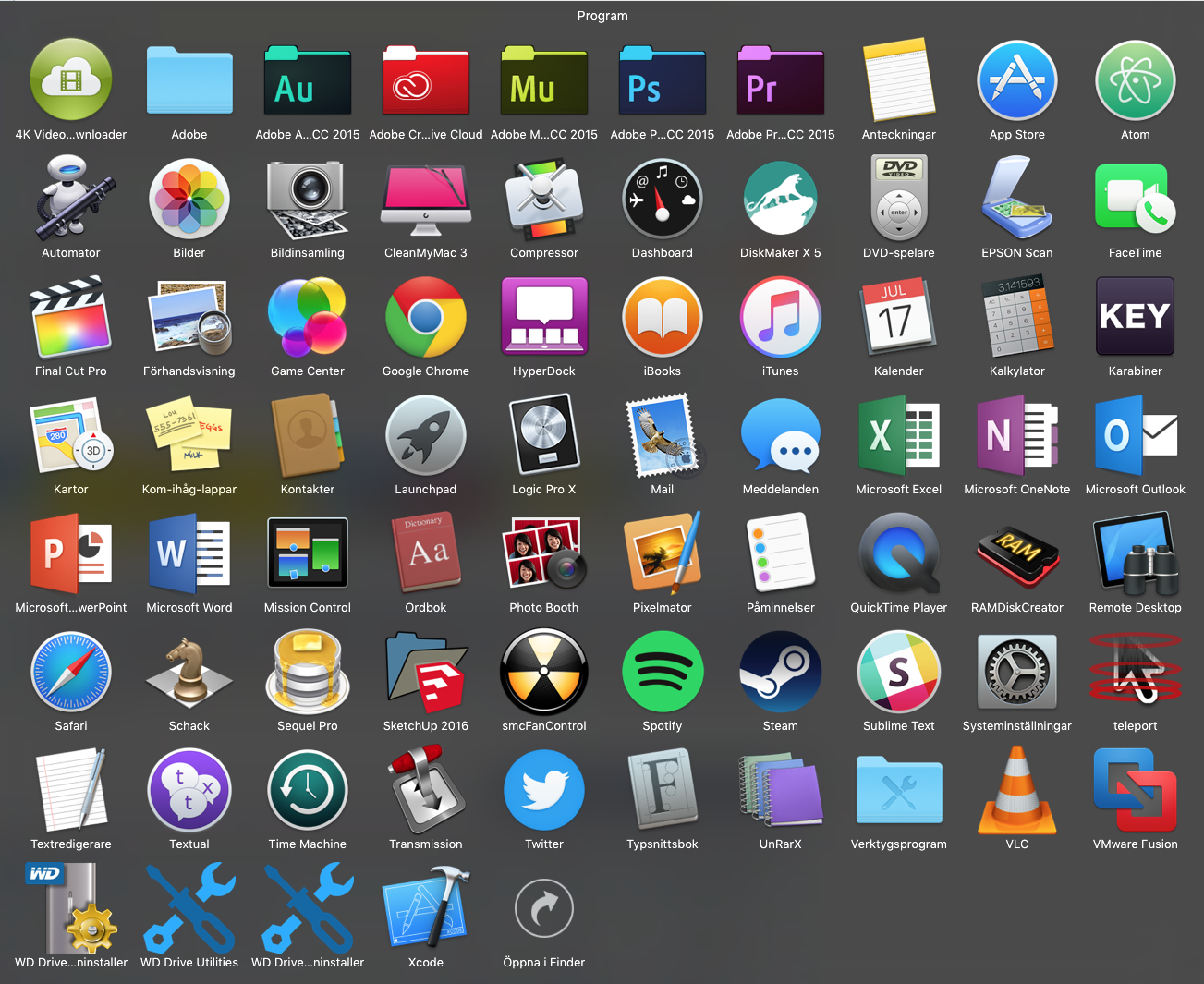

The only "extensions" in system preference pane is Java and Logitech Control Center.
Here is my apps, nothing unusual, 6 apps is making obvious "hooks" in the OS: WD Drive manager, Adobe Creative Cloud, VMware Fusion, smcFanControl, HyperDock and Karabiner. I probably missed some apps that also uses some form of extension:
So if anyone else have the same freezing issue, what apps do we have in common?
But as i said, my rMBP has no apps or extension at all, just a fresh install of latest El Cap and still freezes just as much.
