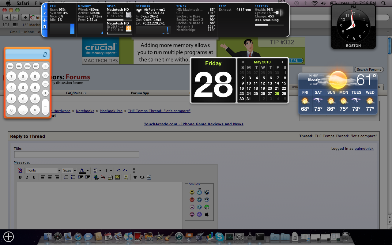

Model: Mid April 2010 MacBook pro 13" 2.4GHz Intel Core 2 Duo, 4Gb RAM. Base model (no upgrades, all stock config)
Program used: iStat Pro
Average CPU Idle: 45ºC.
Fans Idle: ~2000rpm.
Fans Full: ~5067
Fans started : @ ~90ºF
Full CPU after fans: ~190ºF.

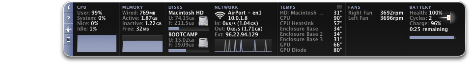

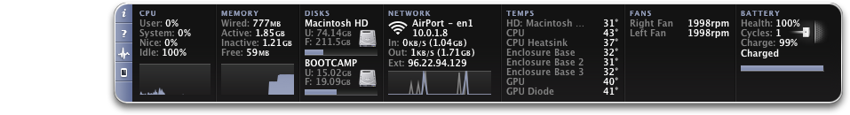

MBP 15" i5 2.4 Ghz
Idle and after 4x yes>/dev/null
