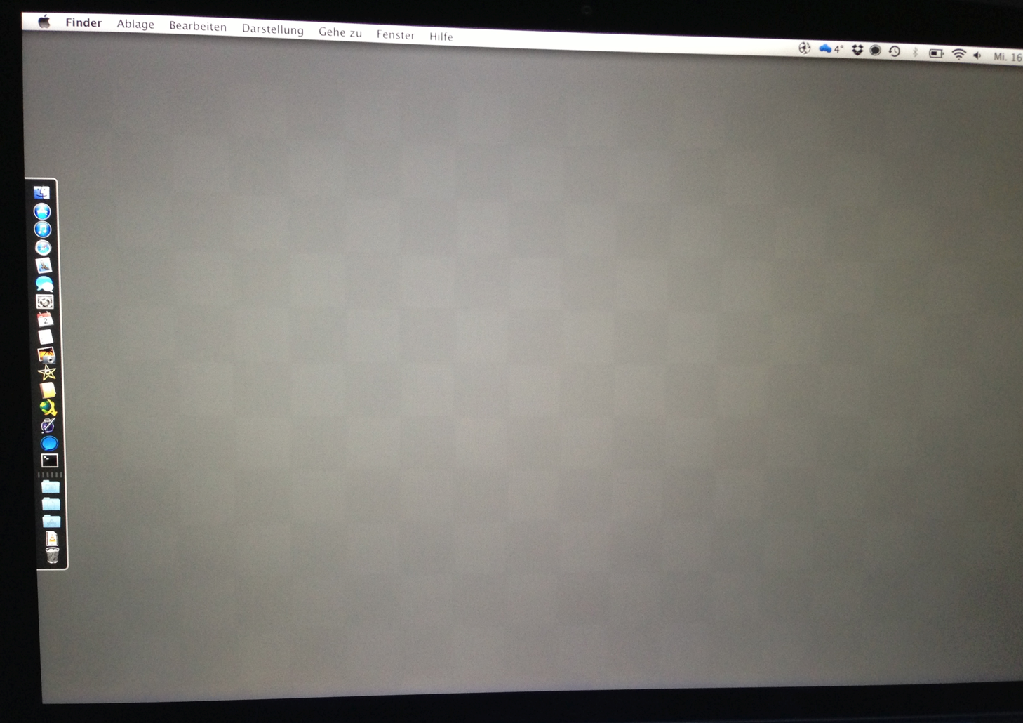

Was this a 13" or 15" rMBP?
Finally I have seen a pic with image retention. That does look bad.
How long does it stay before it fades away?
5 - 10 minutes 🙁 same time it took to appear
just got it today ... jeeze. oddly enough it was manufactured in nov already.
guess ill have to take 2 macbooks to the store on monday cuz my old cmbp is also broken *sigh*

Now I did the test for 5 mins and when I switched to gray I had very faint squares left over on my screen.
Then went to Apple website (lot of whites) and then the squares were gone.
I feel like this is normal?

I went to lunch today leaving a video open (so no screensaver). After 20 minutes I returned and the browser window showed slight image retention.
I just did a quick IR checkerboard test for 3 minutes and obviously my screen just began to show the defect. After 1 minute of waiting I could barely see the checkerboard, BUT could still see the burned-in text from the browser.
(Week 45, 15inch, LG)
Next stop Applestore!
