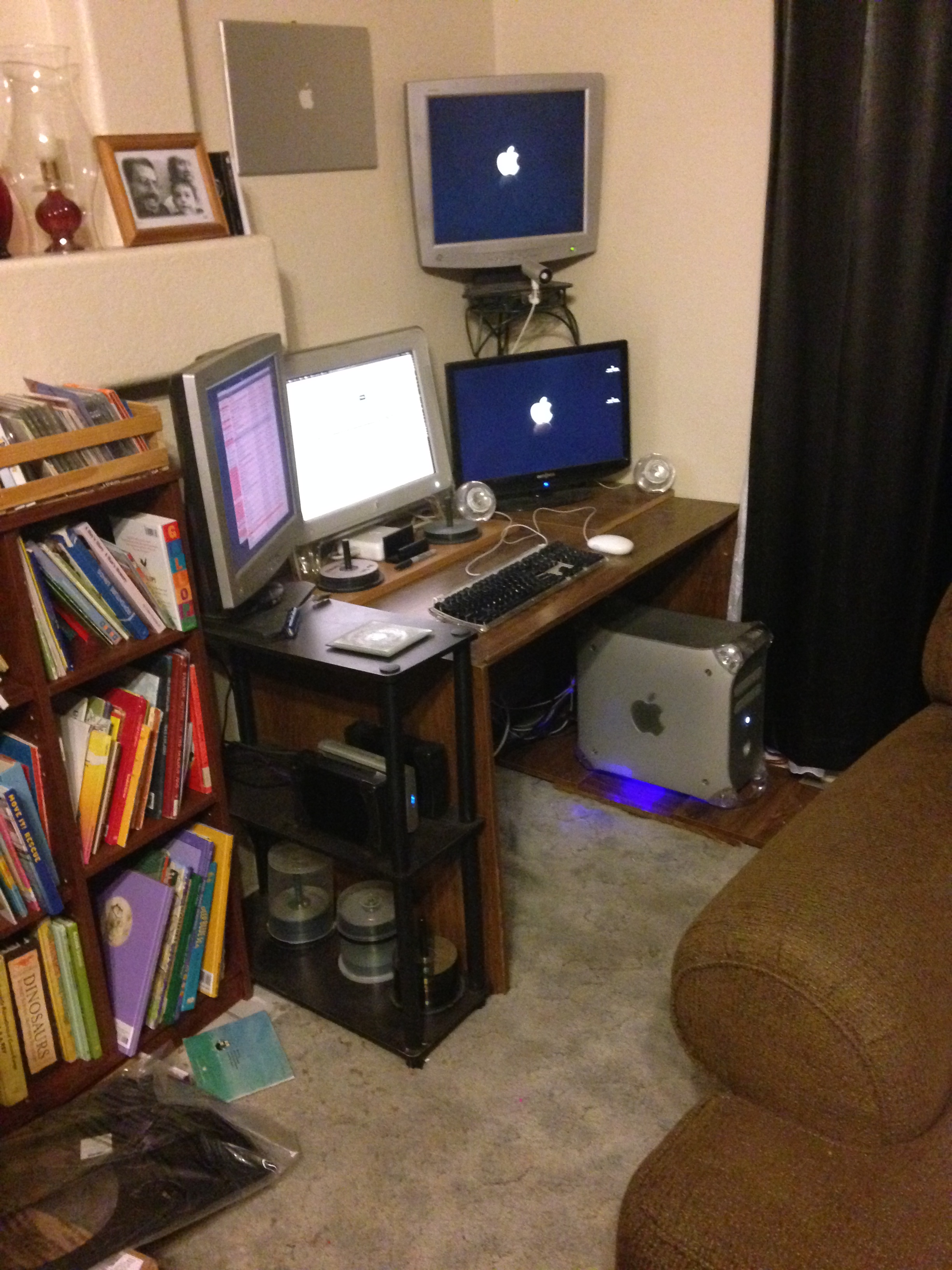

haha powerbook mounted on wall
Nope! 😀
Thanks for playing, please try again some time. 😉
That's the back cover of my old LCD which was replaced. Just the cover. Going to eventually turn it into a backlit lamp.
I had a keyboard case on my wall for awhile too. It's just so conveniently designed to do that when you don't need it at that very moment!
I got to take it easier on the coffee. I'm starting to see things! 😀

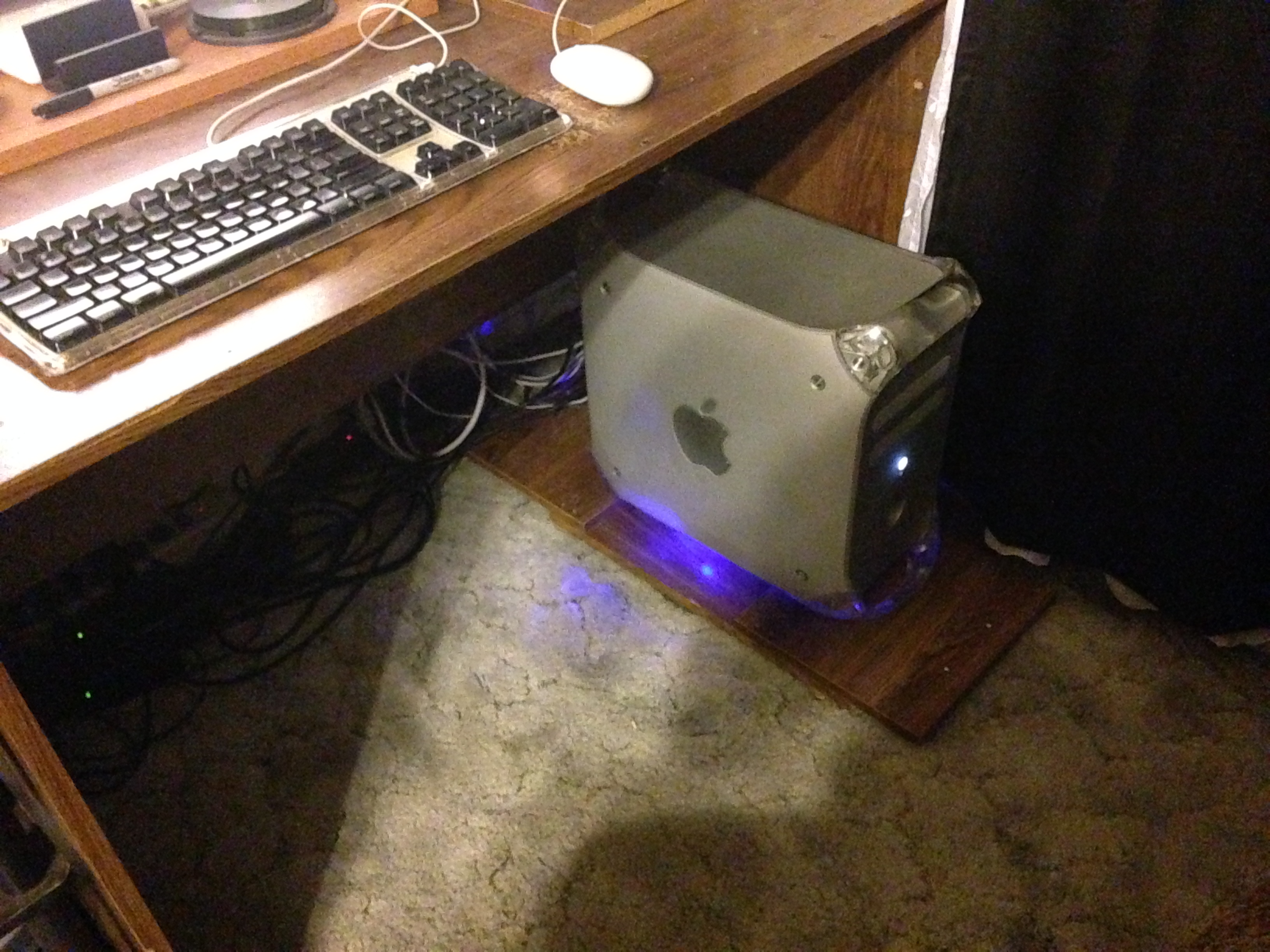

I notice that cool, blue light underneath the PowerMac---do you have some kind of LED light or something? I mounted LEDs underneath my MDD when I used to use it. Currently I have color-changing ones inside my G5. It's a wonder what they can do to make a computer look even more eye-popping!

How are you getting 4 monitors? Are you using a PCI video card or two in addition to an AGP card?

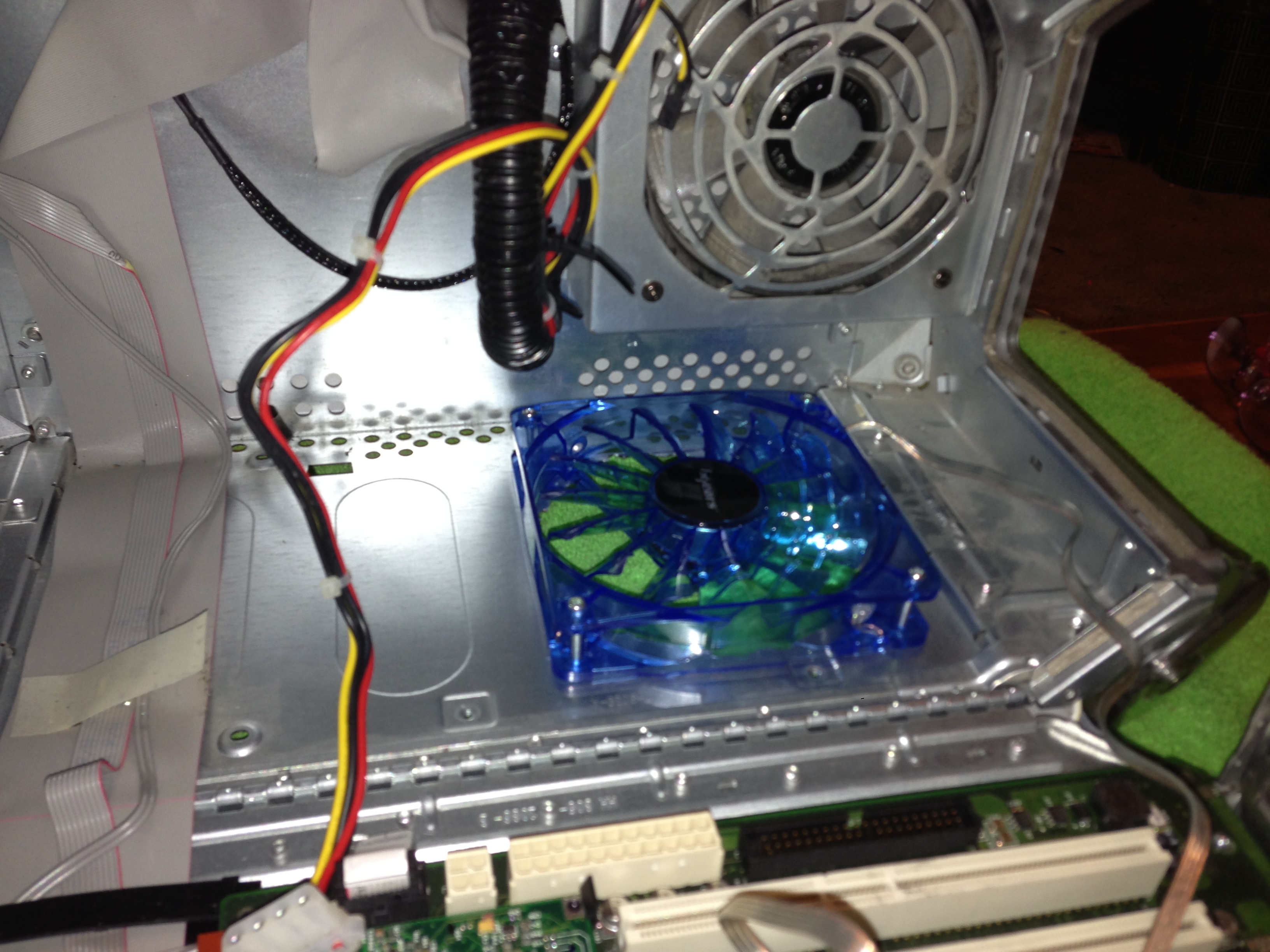

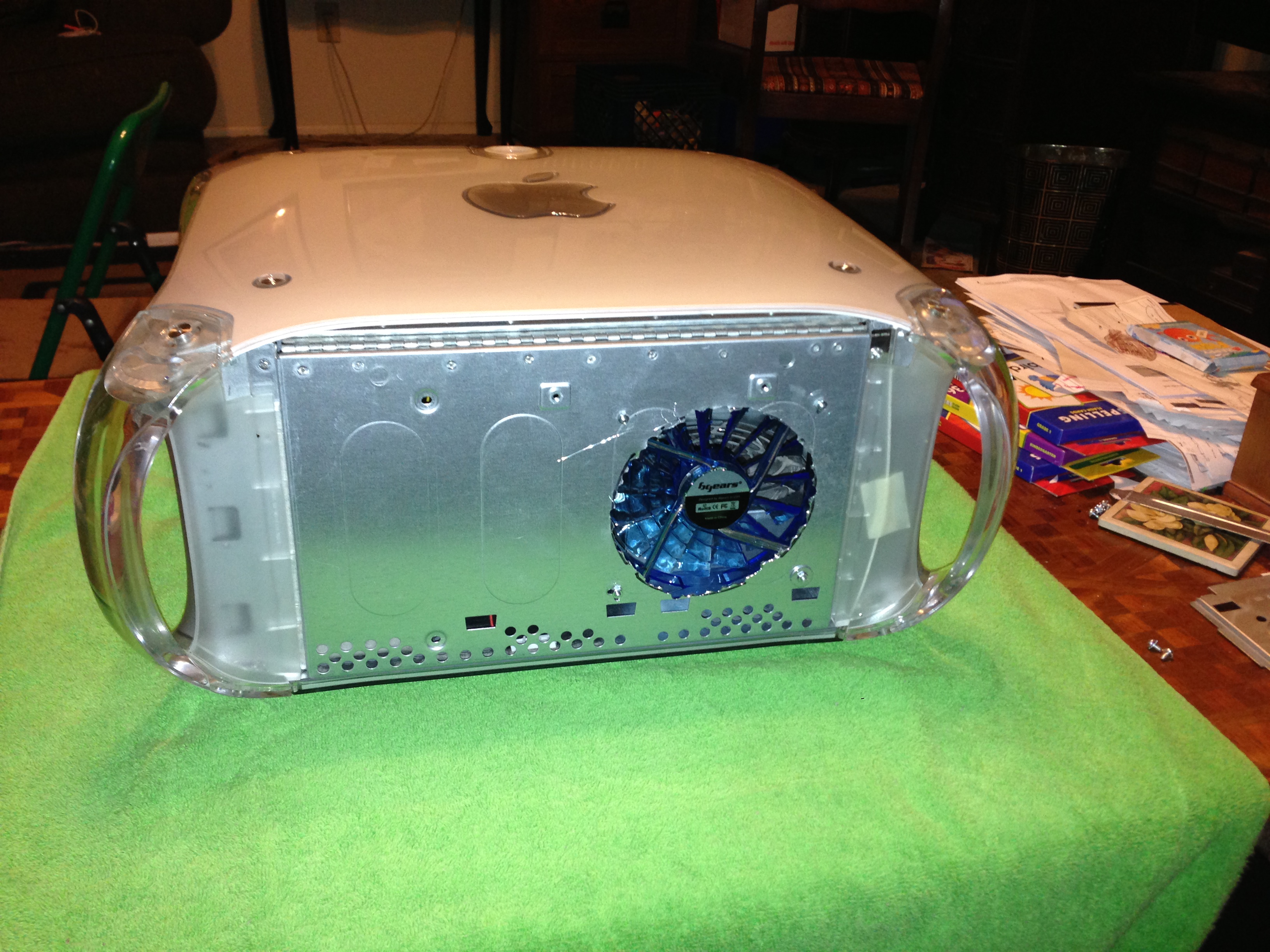

I got the Mac in November 2013. Been working on it since then. Early this year I bought a fan for the dual cpus. It was the only color Radio Shack had and I wasn't paying attention. It had a blue LED.
When I swapped out the case fan I went with a blue LED because of that. But that's not the LED you're seeing here.
Over the summer to combat the heat I drilled out a center hole in the bottom of the case and mounted a fan (with a blue LED).
I don't know where that thread went, but the fan that's in the center is the one you're seeing the light coming from.
Yes.
ATI Radeon 9800 Pro (AGP) is driving the Cinema Display (A1006 DVI/ADC converter, a gift from a member here) and the HD monitor (VGA).
ATI Radeon 7000 that I picked up in an eBay auction for $15 (only bidder) is driving the two FPD1810 Gateway monitors DVI/VGA.
I have an ATI Rage 128 as well and have driven 5 monitors before (I posted proof) but right now I want my USB card more.
Eventually, once I get all of this ironed out there will be three dual display cards in there for 6 displays.
Ah, yeah, I was suspecting something like that. I know I've seen people do that to their G4 cases when making a Hackintosh out of them. (or hacking 'em in some way 😉 )

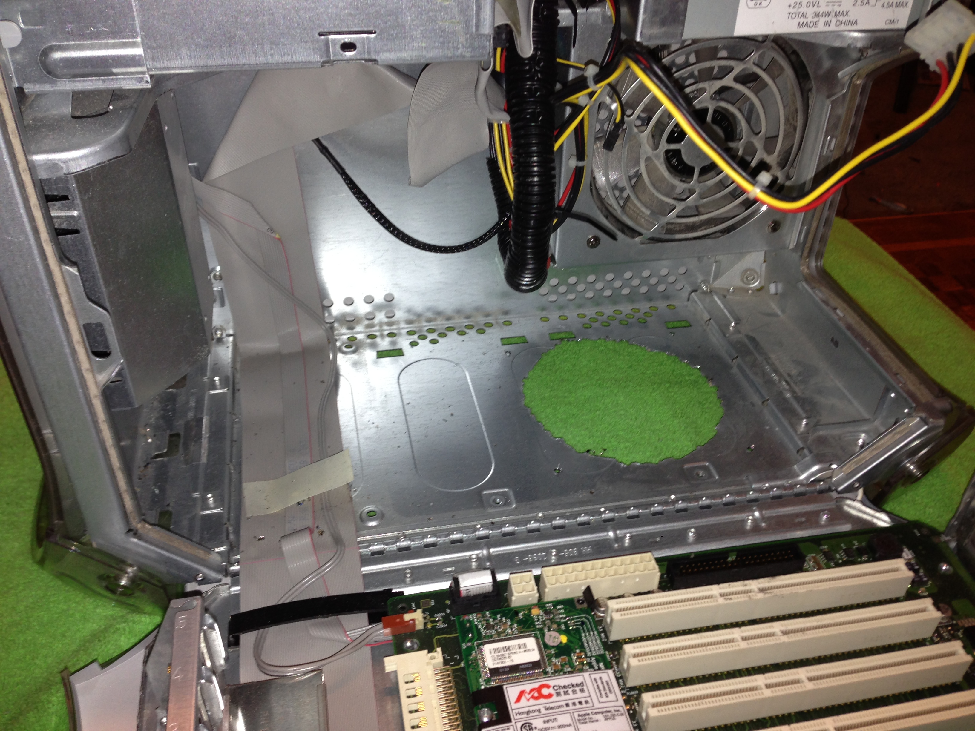

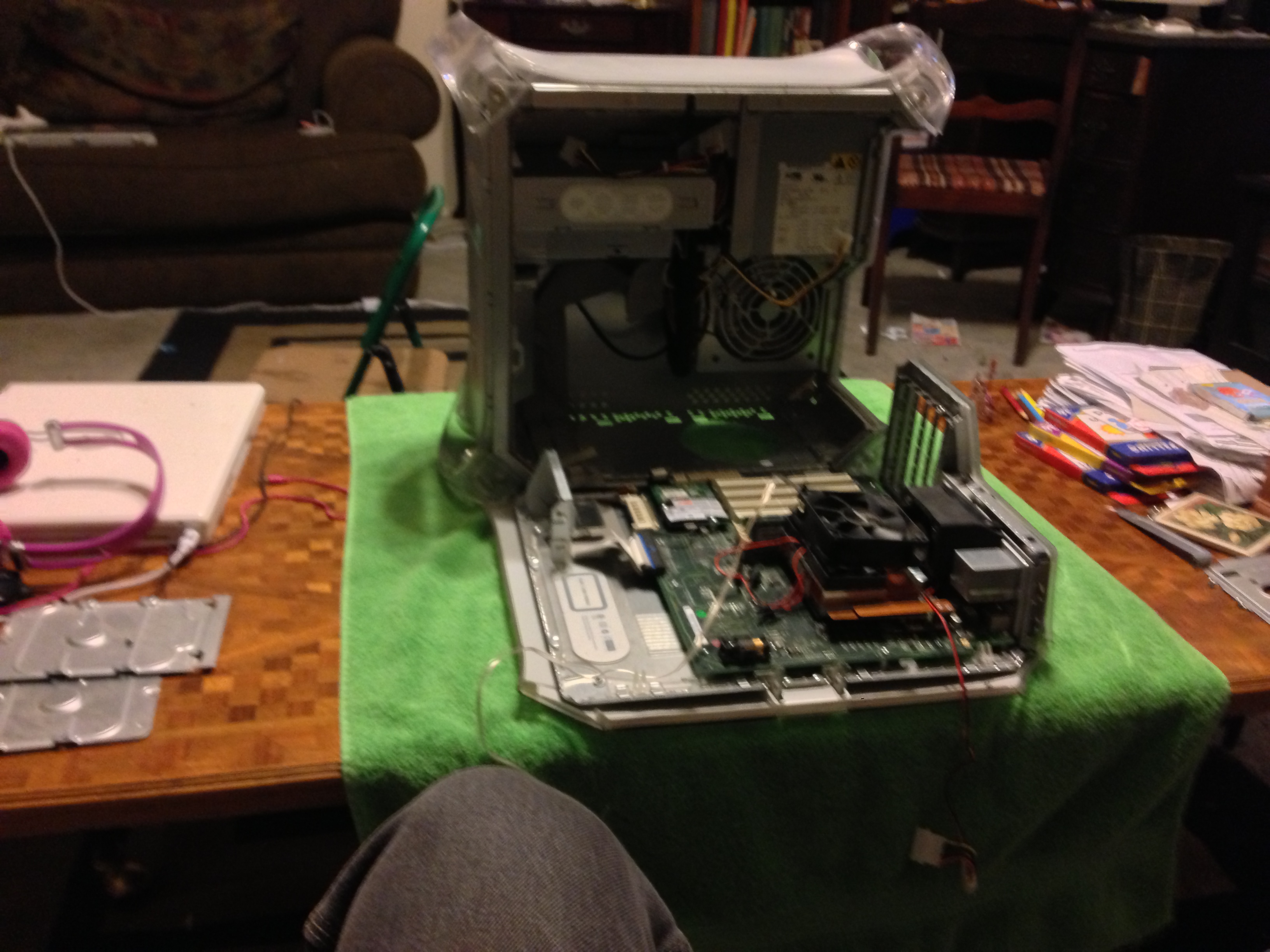

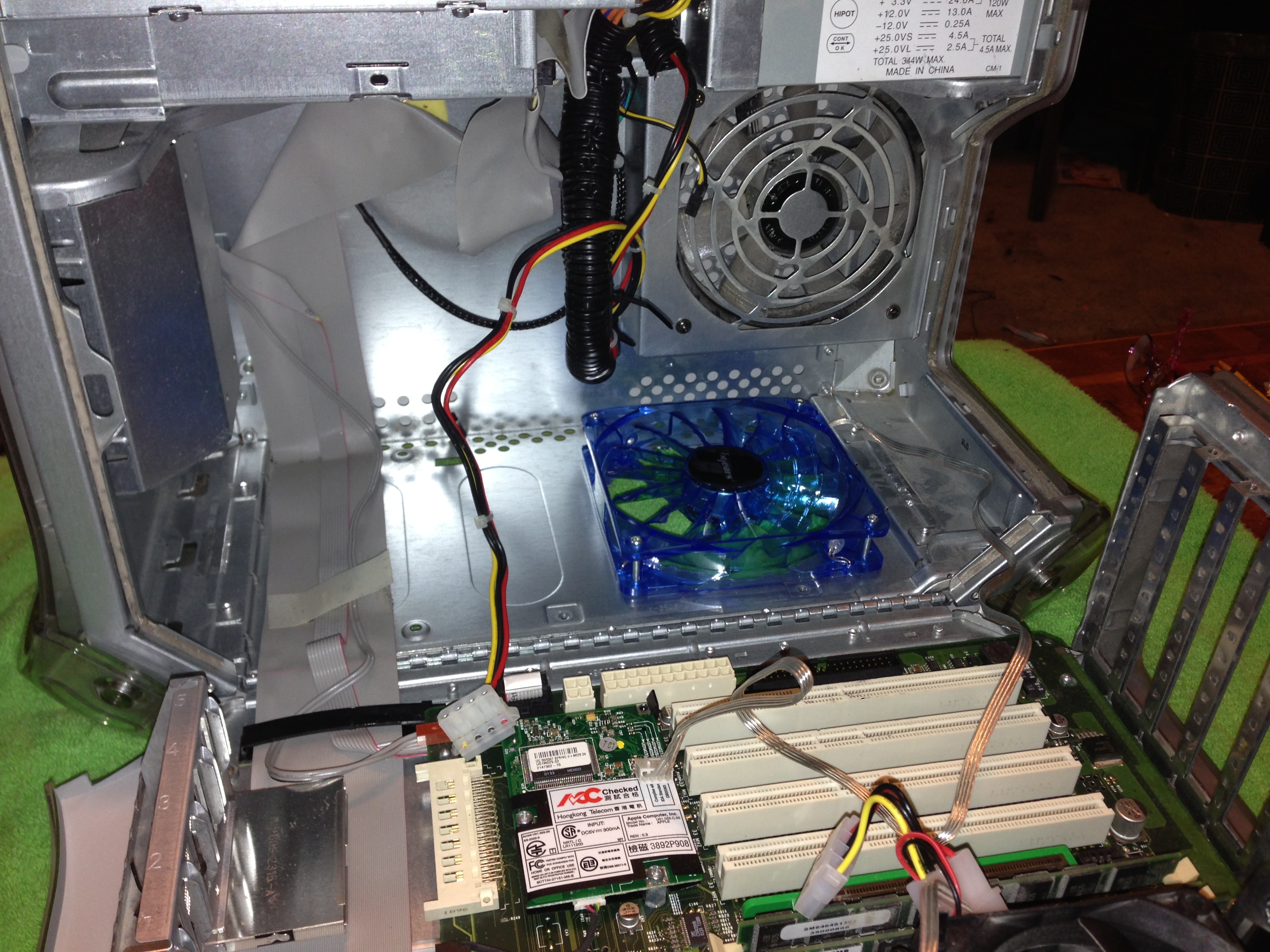

I'm not even really trying to find the thread on what I did. However, I just went and located my pics.
So…here you are. This should explain why you see the LED on the bottom. 😀
