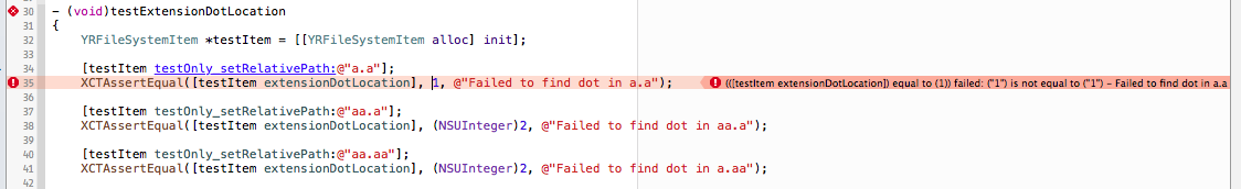

That test code does not produce that output. Please post the actual code used to generate the messages from the original post.
It does for me. Screenshot attached as proof (I had to change it back to without the cast). relativePath is just an NSString. The code is being run in Mavericks 10.9.0, Xcode is version 5.0.1. Neither are beta versions.
