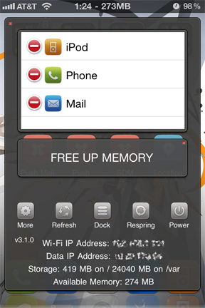

i really do like this theme but it seems like it's using up alot of ram so i don't know if i want to keep it. free memory is showing 30-40mb less of what i normally have.
If you have SBSettings, double check your processes. ;)
There's no WAY SlantedLock is eating 30-40MB of memory. lol
well after about an hour of standby, the ram starts to drop. i don't know what's causing it. i disable the weather too.
the first pic is with the theme off. second is after an hour with the theme on.

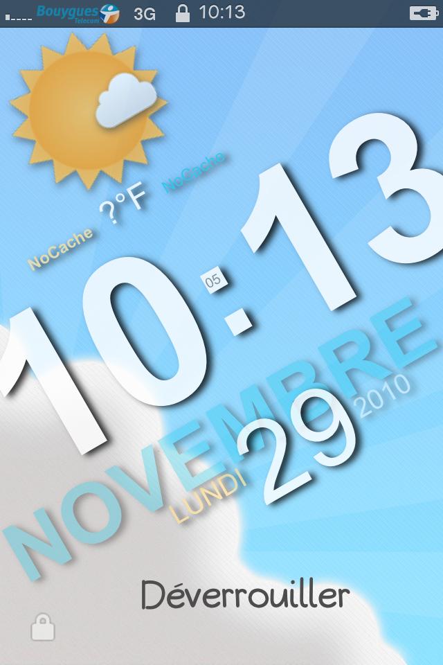

Hi,
i'm french (sorry for my English) and i love your slantedlock theme!!
But i have a problem whith weather. When i put my city number,
i have a "NoCache" on the lockscreen. This is a picture.
Could you help me please?
Regards

Hi, so i found my error...It's ok for my iPhone4.
But i have a problem with my 3Gs with the Default wallpaper option.

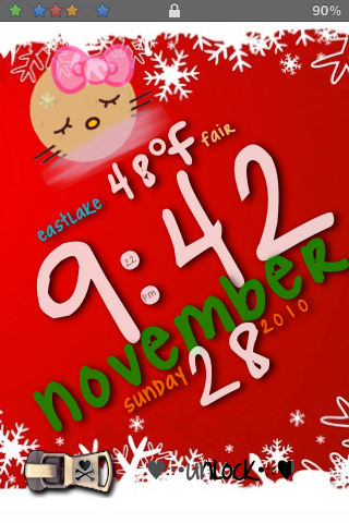

Will you be adding new bgs for Winter Holidays?
Any chance someone will be making a series of Christmas wallpapers to go with Slanted Lock?
Pretty please. :D

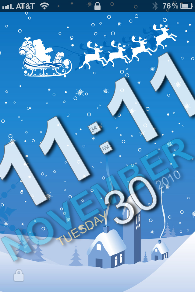

Well, you 2 are in luck. :) I just updated the first post with a download link to a set of 24 Christmas wallpapers. I think they look nice. Enjoy!
