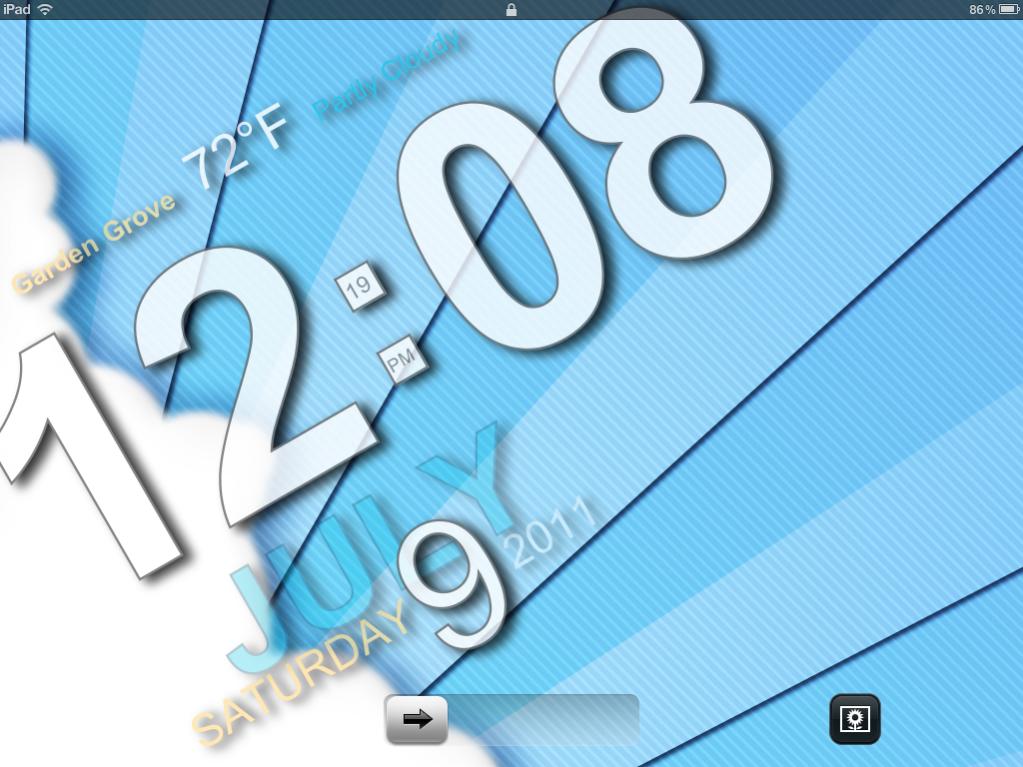

Hey guys,
I'm having a bit of a problem with leddhedd's Slantedlockipad installation on my iPad 2 4.3.3.
I unzipped the files and SSHed the folder "Slantedlockipad" (this was the default capitalization) and moved it into /Private/images.
From what I gather the only other thing I need to change in the Configs is the "Wallpaper Set" where I have to change it to the blank radio button and enter "Slantedlockipad" (again matching the capitalization of the folder).
With these changes, I don't get the iPad sized wallpapers but info shows up correctly.
I experimented with the "Style Sheet" entry in the Configs and noticed that if I changed it from the default "SlantedLock" to "SlantedLockiPad" or "Slantedlockipad", I would get the correct wallpaper sizes, but I would be missing all the weather/clock info.
I'm a bit lost as to what I've done wrong. Any help?
Thanks,
~Paik
Hey guys,

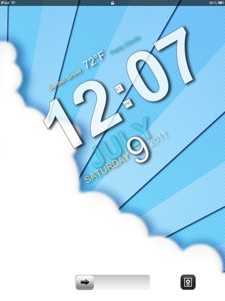

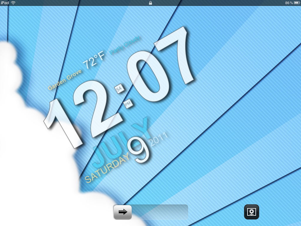

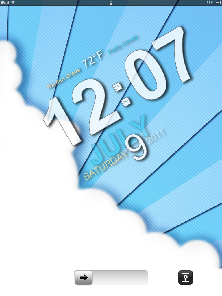

Firstly, I do apologize if I didn't get back to you... I'm quite busy with work and all that. This thread is meant for me to share what I got with you guys.
I recently got an iPad 2!
Finally able to test the theme on an iPad, I made the port for the iPad version. I tried figuring out the orientation detection script, but I guess the winterboard theme doesn't behave like a normal webpage, so we're stuck with themes unable to know which orientation its in... until someone else smarter figures it out.
In any case, I've made a few tweaks here and there and am satisfied with my result, so I'm going to share it with you guys.
Here's what I did:
- Removed the weather icon. This proves to be more trouble than it's worth. What with the inconsistency complaints and the time change(in the US) makes them inaccurate.
- Fixed the clock update delay
- Brighten LEDHEDD's set of background to my liking :p
- Created TWO layout options to best fit the iPad's display. This is to be used in the StyleSheet option in the configuration. One is call SlantedLockiPad and the other is SlantedLockiPad2
You can download the new theme package here:
SlantedLock iPad version 1.5.5p

I like using No Lockscreen on my iPad(with the magnetic cover you usually skip it anyway), but this makes me want to go back to seeing the LockScreen:D. Very nice work, always has been on my favorites for the iPhone. Thanks for the all hard work.
Thanks for the kind words!
I like your theme
But the background....

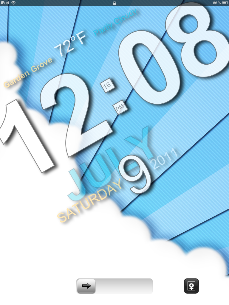

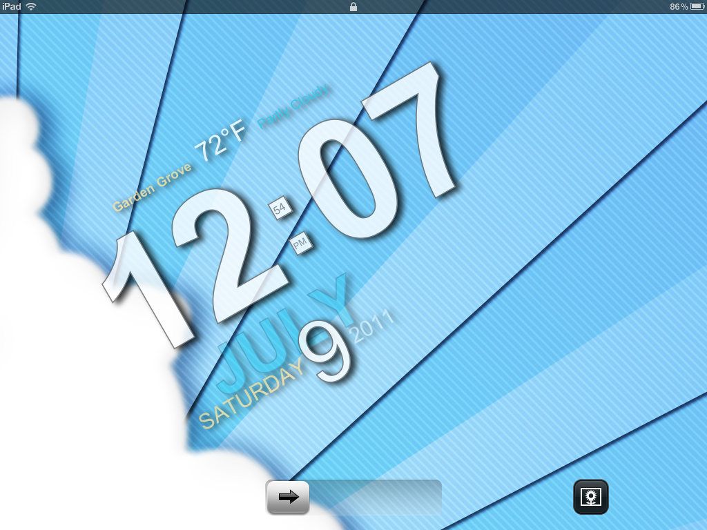

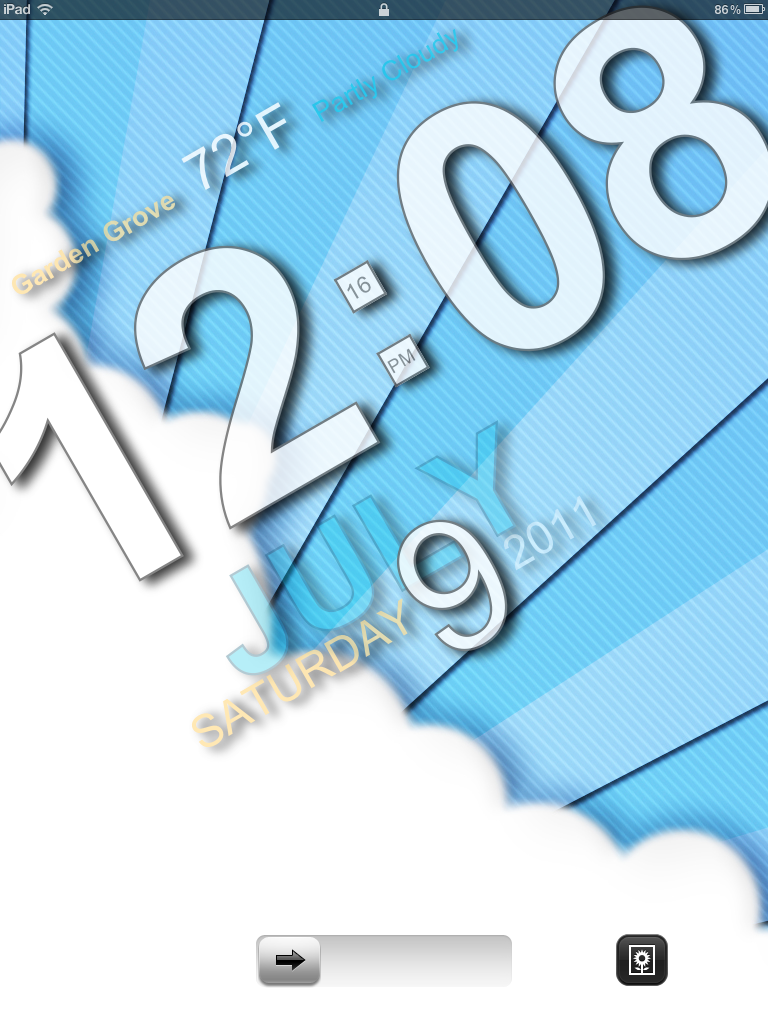

The background sizing and cropping is not controlled dynamically on orientation change in my theme.(or any theme as far as I know... even default official background)
The issue you raised is that the background are getting cut off at an undesirable width/height depending on the orientation of the iPad.
The short answer:
It depends on the background you choose. You will need to adjust the image using a photo editing software before use to achieve what you want.
The long answer:
The iPad screen is 1024x768(wxh) in Landscape mode and 768x1024 in Portrait mode.
Since there is no smart resizing or cropping of the background when orientation changes, the background must be 1024x1024 to support both orientations. This is why iPad backgrounds you can find on the internet are sized at 1024x1024.
The only region that is guarantee to appear on BOTH orientations is the 768x768 region at the top left of the wallpaper.
In fact, the challenge in building an iPad theme boils down to that fact as well. The effective playground for theme content must exist in that 768x768 window to be visible in both orientation. Thus, in landscape orientation, SlantedLock appears to be biased on the left side and it appears biased on the right side in portrait mode. Given this fact, we CAN have contents that is hidden in one orientation and visible in the other; just place the content OUTSIDE of the 768x768 box. :)
Trust me, this irks me to no end. I had attempted to detect orientation on the fly, but haven't found anything that works. If anyone knows of a theme that behaves like it knows which orientation its in, please point me that way. ;)
I have been trying hard for the past few days to figure out how to get lockscreen images to display properly according to orientation (for another theme). I think I tried about 10 different variations of coding and could not get it to work. I am honestly glad I found this post as at least I now know it is not currently possible.
The closest I came was using javascript to display an image properly on the first view. It wouldn't change dynamically, but if I unlocked the iPad, changed orientations, locked it again, the image would line up properly based on the new orientation. Hopefully a solution can be found. The CSS coding to do this is so simple for a normal webpage.
The short answer:
The long answer:
The short answer:
The long answer:

That theme does not crop or resize the wallpaper.
The original thread of that theme is here: http://macthemes.net/forum/viewtopic.php?id=16809353
Notice the same wallpaper is cut off depending on the orientation of the iPad.
