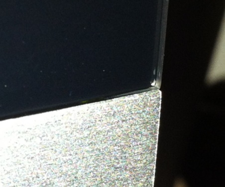

Please, have a careful look upon the opened display housing:

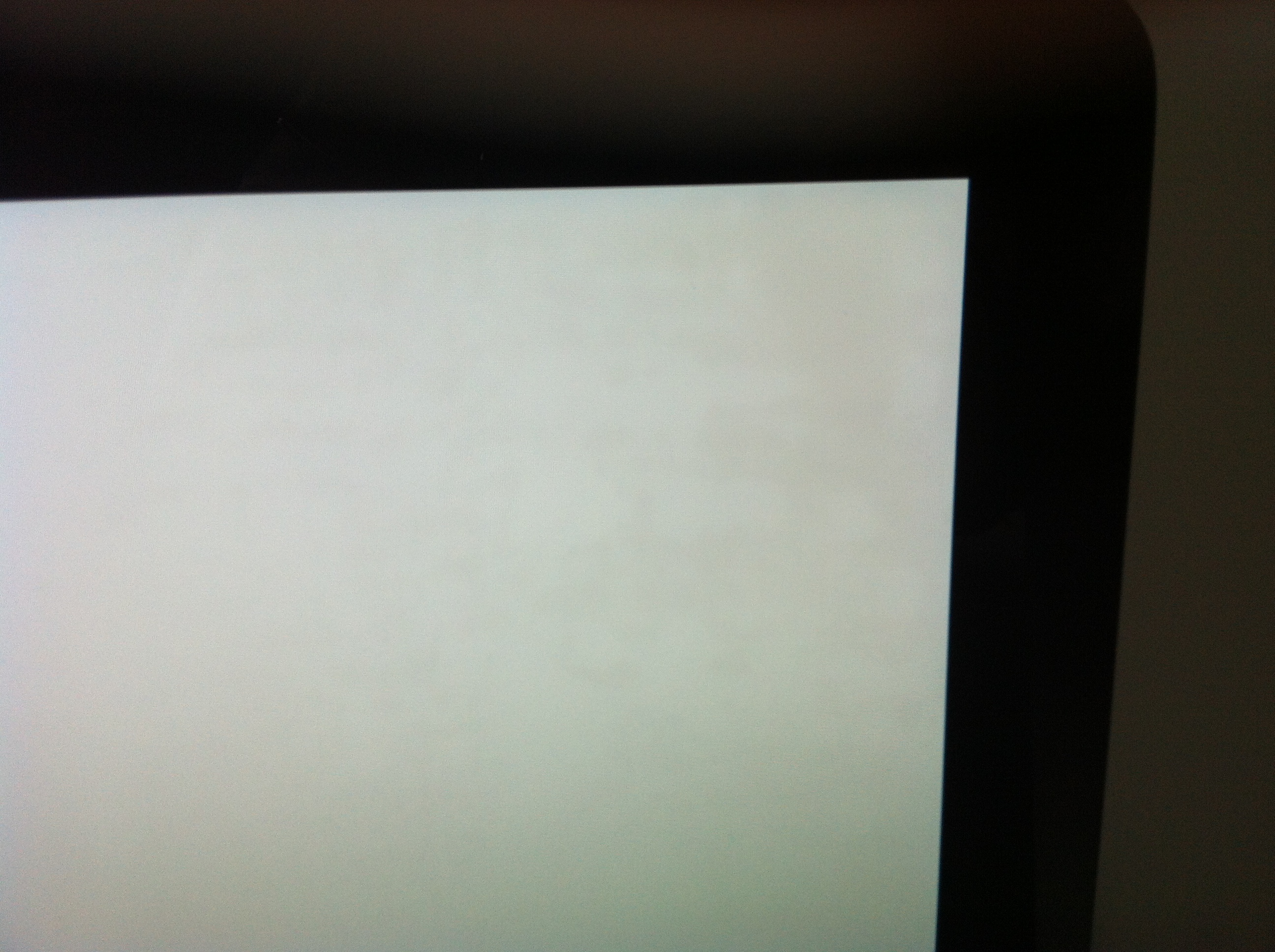

You can see the high-degree-dust flares under the TFT-panel. And you can see periodical sun-beam-like free spaces in between the dust deposits. The "periods" are the analogons of the multi connectors slots.
I searched for one month in October 2011 and found at last Oggy's guide. Without his instructive pictures I would not have done it.
The cleaning went very well. But this alone would not make me writing here.
the dust didn't return after.
I searched very carefully for the way of the dust into the display housing.

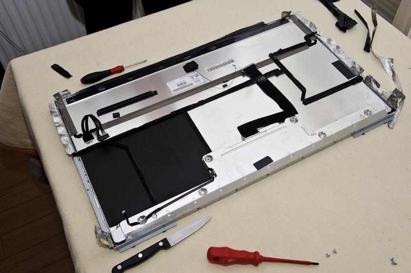

This tin plate is similar on the 27" iMac.
On this picture the top of the display is closer to the camera.
https://forums.macrumors.com/attachment.php?attachmentid=287660&d=1306956104
When you take the display out and turn it around there is some kind of sealing tape on this plate. But than it seemed to me that it's not important. I pealed it off and didn't put it back. And dust didn't return.
The multi connectors are on the upper side of the LED panel and they have no contact with the backlight in the 27" iMac. There is no space between LED and the backlight. The backlight has a foam band all around on which the LED panel "sits" on. This seals of the air between the LED and the backlight even in the area of the multi connectors.
Look for the gray line on the end of the bottom of backlight. It goes all around it.
https://forums.macrumors.com/attachment.php?attachmentid=287668&d=1306956612
So, I'm still convinced that multi connectors and the displays logic board don't have anything to do with air coming in.
To put it simple: The LED panel seals of the space between it and backlight by itself.
I think that there are two possibilities:
1. The heat causes this foam seal to expand or get damaged and makes room for air and dust.
2. Transport of the iMac causes the LED (or the backlight) to get twisted or get misaligned (because it quite large) and creates a gap for air.
I'm sorry but you theory with high pressure and airflow comes actually to the same conclusion we have found out before. There is a gap between a LED and the backlight and the problem is sealing. Not airflow or high air pressure.
Oggy, we don't have any problems with different opinions, we are talking about different displays.
1. I said, that I can only speak for the 24" iMac from 2009
I will show you more evidence of nicotine-traces on the inner side of the frame opposite the connectors slots.
And another potential entrance are the grooves of the left-side-situated-Layer connectors in the plastic frame:
So if you think, that the multiconnectors slots are not the entrance for the airflow, I will accept this for the 27" display, because everything is sealed there between TFT-panel and the first "light guide" plate. I didn't open the new display yet.
LG definitely worked on that problem. For me this sealing is not an argument against the multi connectors-entrance (in 24" from 2009), but the evidence, that they found this entrance and closed it. So, unfortunately, i'm a bit too late.
Now pictures of the 24" from 2006:
And now the 27" iMac 2011:
You are talking about a display of one of the 27" iMacs, please tell the year.
Your finding are impressive. When you speak about the LED, you mean the panel, but not the LED backlights? The right name is TFT LCD IPS (in plane switching) for the panel, but I had to look to Wikipedia.
I compared my 27" display from 2011 iMac and it looks a bit different from yours. You may compare the backside carefully, to find little differences.
My 27" display is named: LM270WQ1 (SD)(E3) Light Guide: PMMA
As you can see, there is far more black tape at the edge of the electronics cover.
You say the problem is sealing and not airflow or high air pressure.
Okay, I sealed and I hope the dust inside will never come again:
The theory of the consequences of high pressure and the need of sealing will not lead to the same conclusion, its related like hen and egg, but it has two different fathers: Once Apple is the addressee for the advice to lower the pressure, and twice LG should seal the displays focussed on the knowledge of the special micro-environmental conditions around the displays in iMacs.
You have to keep in mind, that the same displays work beautifully in the monitors without fans and high and low pressure, not only in Apple Monitors.
THE ONLY PROVOCATING THEORY OF MINE IS, THAT OPENING THE BACK SLOT, MAKING THREE OF THEM, COULD LOWER THE HIGH PRESSURE AGAIN, SO THERE WILL BE NO FORCE ANY MORE TO PRESS THE AIR THROUGH THE DISPLAYS
Did you really found out before that there is a high and low pressure compartment, that Apples airflow management is really ambitious and that it is really a hard work over years to embed this barrier inside of an primarily miss constructed system?
And, last but not least, that the LG-Display housing works as a tunnel or channel between them?
Do you really know until today, where the air is getting in, when it is not the multi connectors slot entrance? I don't know where the air went in, when I will have to clean the display in one or two years. May be after I know, May be I am too late as now with the 24" iMac from 2006

imac 21" grey smudges
Hello,
I bought my 21" iMac in Jan 2011, I discovered the grey stains some weeks ago (upper right corner), they became bigger last 2 weeks. I am in Europe, have 2 years of warranty from the seller, but don't know if I will have to fight for a LCD replacement :S Apple doesn't care after 1 year, and don't have Apple Care.
I tried first to clean the glass, took it out, also cleaned LCD, but was clean. Stains are inside, or like you say, between LCD and backlight.
But is this a dust problem or LCD burnt because of HEAT? I read people speaking about using smcFanControl... and I am confused. My LCD can be cleanned being dust, or replaced being heat burnt?
When putting the glass back I saw that it seems I scratched a corner a bit, see the pic attached, I used the flash to be able to capture it. In real life is much more difficult to see, BUT I think that if you are very into detail, you can notice it. Removing the glass voids the warranty?
I am afraid that they tell me they don't replace the LCD because of removing it.
