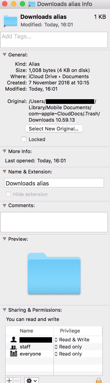

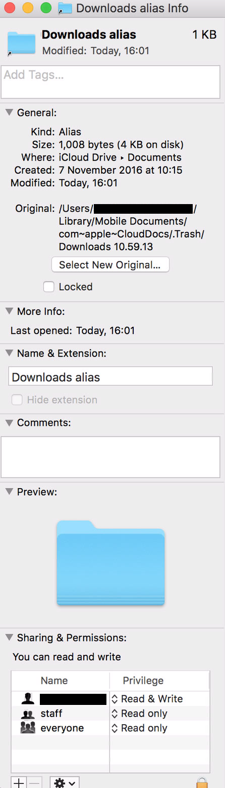

Fixed it. Woohoo! I spent so long on this problem, glad to finally put it to bed. It turns out it appeared to be a weird interaction with the iTrash app and iCloud drive. I have seen iCloud drive do bizarre things before so I shouldn't be surprised (https://forums.macrumors.com/thread...-hdd-with-locked-files.1979281/#post-23805970).
I stumbled across this post and followed each step one by one, number three fixed it for me. https://origin-discussions-us.apple.com/thread/7508266?start=0&tstart=0
It turns out I had a dodgy Alias sitting in my iCloud trash... or something. Deleting it fixed the problem, no more pop-up.

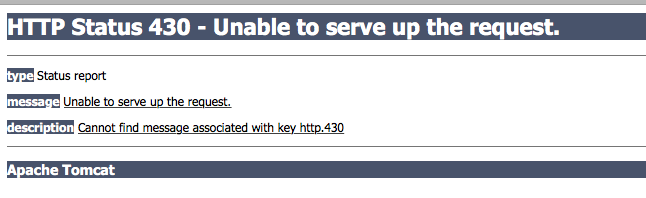

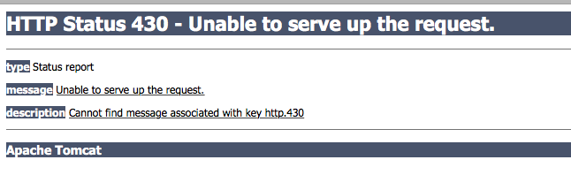

Was so hoping this might be an answer to my issue with USERS and being able to sign in to iCloud with two out of three of them. But, alas, clicking on your link gave me this:

Ah. For whatever reason it's offline, temporarily or permanently I have no idea. Luckily I had already thought of that possibility and saved a copy in the Internet Archive.
