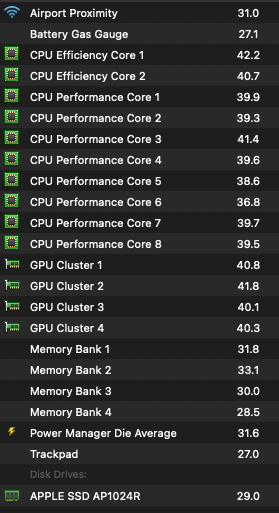

Never heard the fans on my 14" M1 Max 24GPU after more than one month using it, 95% of those was on clamshell mode, neither hit those temps even when intensively working, at the top 62-66ºC (sometimes 70's if it's compiling or if I'm gaming directly from it) with some intense processes, with mid/moderate usage it usually stays between 42-52ºC, on light/mild around 38-41ºC. As @jav6454 it would be interesting what kind of load you want to measure and what was the reviewer doing to achieve those temps.

Right now I do have Safari with 12 tabs open, Firefox with 4, Discord opened and a terminal on a remote session with my raspberry Pi, and here you have a screenshot of the temps (computer has been turned on all day, and I was watching twitch streams/youtube videos + coding till 45m ago, so take that into consideration as well)
PS: my room ambient temp these last weeks was between 18º-24ºC to mark a reference point

How (which app) did you get that type of temperature breakdown?

I don't think it's available on the AppStore, I always downloaded it from their official page (CrystalIdea)
Remember one thing, once it opens it will ask for the admin password, don't type it in if you don't want to install the extension to control the fan curve, just click "Cancel", then another dialog pops in warning you will be just able to monitor the sensors, click "Monitoring Only" and that's all.
I installed the extension on the M1 Pro and it worked well, still didn't installed on this M1 Max cause default behaviour suits my case, let's see in summer. I've been using this software since many many years ago, used it on my 2010 & 2012 MBP to setup my own fan curve with no issues whatsoever.
It's free but not open source, so that's one thing to consider, even that, I'd consider it a quite safe piece of software if you decide to go ahead with the extension install as well.
