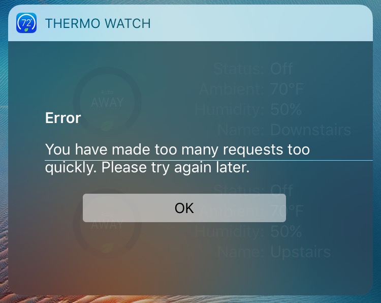

Lastly, I've ironed out a few UI rendering quirks, like the one you can see on gwhizkids's screenshot above, where the line cuts straight through the text.

Good news for you and anyone else experiencing the "Too many calls too quickly" problem - I've found out what the issue is and submitted a fix. It should be released in a few days given that the review process is very quick nowadays. The issue lies in a bug in watchOS3 where the complication background updates start happening uncontrollably quickly, which in the case of this app exceeds the access rate of the Nest service.
Reactions: gwhizkids
The 2.4 update is out since yesterday, and that will resolve the "Too many calls" problem.

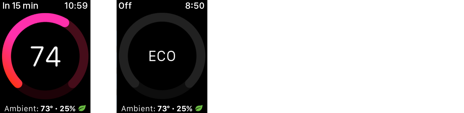

Version 2.8 is now out and contains two nice new features:
- Time-To-Temperature that Nest recently made available to 3rd party developers is now displayed when the thermostat starts heating or cooling. Both the watch app, and the iOS widget display this descriptive time.
- Eco mode support is added. This allows for setting the thermostat into the power saving mode similar to "Away" but without switching your whole house into away state. Eco mode impacts only the thermostat.
Important note: To enable the time-to-temperature feature, I had to update the permissions access for this app. What this means in practice is that you will get a badge notification from the Nest's main app, and you will have to open the Nest app, and allow this permission change for Thermo Watch. This is the procedure Nest requires when 3rd party developers want to utilize features previously unavailable to them. If you ignore this, or don't allow the permissions change, the app will continue working just the same, it only won't be displaying the time-to-temperature.
Other than that, this update fixes several small bugs, most notably making the app preview in the dock update fully (previously only the main temperature gauge would update when you scroll to the app in the dock)
