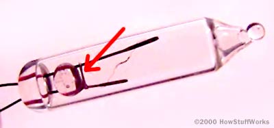

Christmas lights wired in series should remain lit because the bulbs have a shunt that takes over in the event one or more filaments burn out, unless of course there is a bad connection in one of the bulb sockets, a blown fuse, broken wire, or a blinker bulb burned out. Sometimes it's a pain to troubleshoot. Been there, done that
Today's standard mini-light bulbs contain a shunt wire below the filament. If the filament burns out, the shunt activates and keeps current running through the bulb so that the rest of the strand stays lit.
