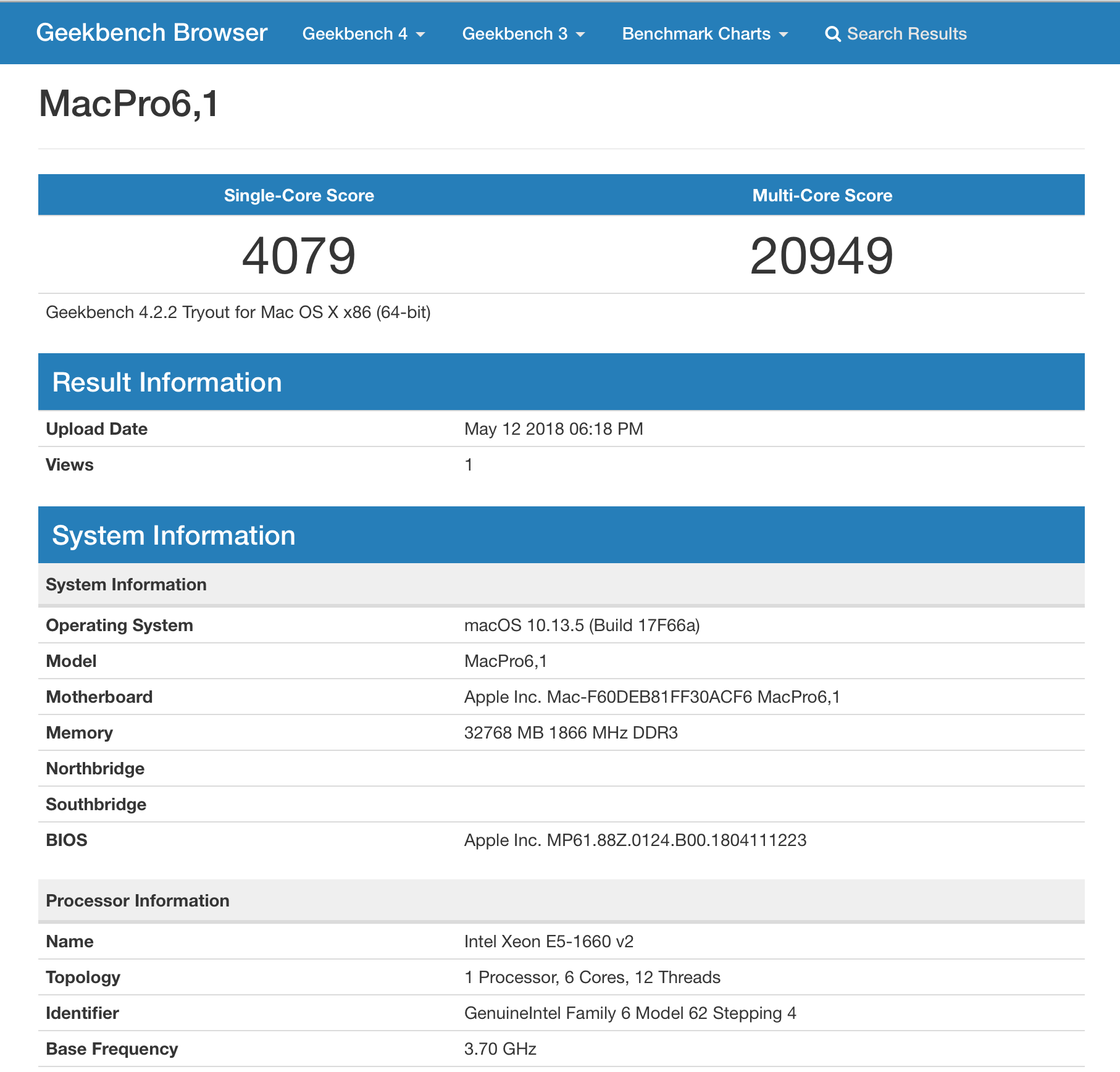

just swapped out the base 4 core for a used E5-1660 V2 (6 core) and it's noticeably faster, for $195 upgrade, it was well worth it.
Single core Geekbench increased by about 20% and multi core almost doubled.

I went this route, just because I wanted the fastest single core speed available, it was also only $195 total.
