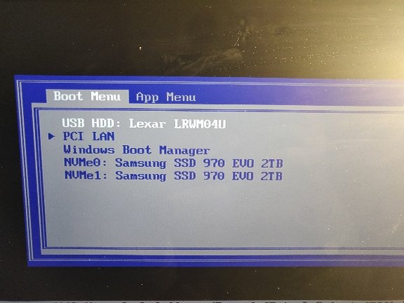

Does the bios see the popOS partition? That is, on the page (in the bios) that you choose the boot order, is there a pop os drive?
nope it no longer shows in bios at all

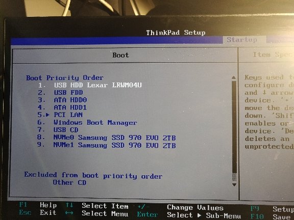

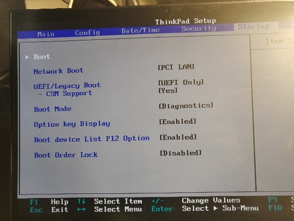

Anyways on my bios i cant manually select my pop os. that is the problem. i can only select the windows partition.

It appears that you're using UEFI boot rather than a traditional BIOS.
You seem to have 2 ESP partitions (/dev/nvme1n1p2 and /dev/nvme1n1p8); this is unusual and could be where things have gone awry. Usually, Windows and Linux will share the same ESP partition. You really need to find out which one is the actual esp & boot partition used by POP_OS.
The boot order under UEFI is held in NVRAM - you can check this using the efibootmgr command. Type this from your live USB session (as root) and paste the results here:

In order, your machine is set to boot:
1. USB Stick
2. USB Floppy
3. HDD 0
4. HDD 1
5. LAN
It'll try each of these in turn until it finds a suitable boot loader.
